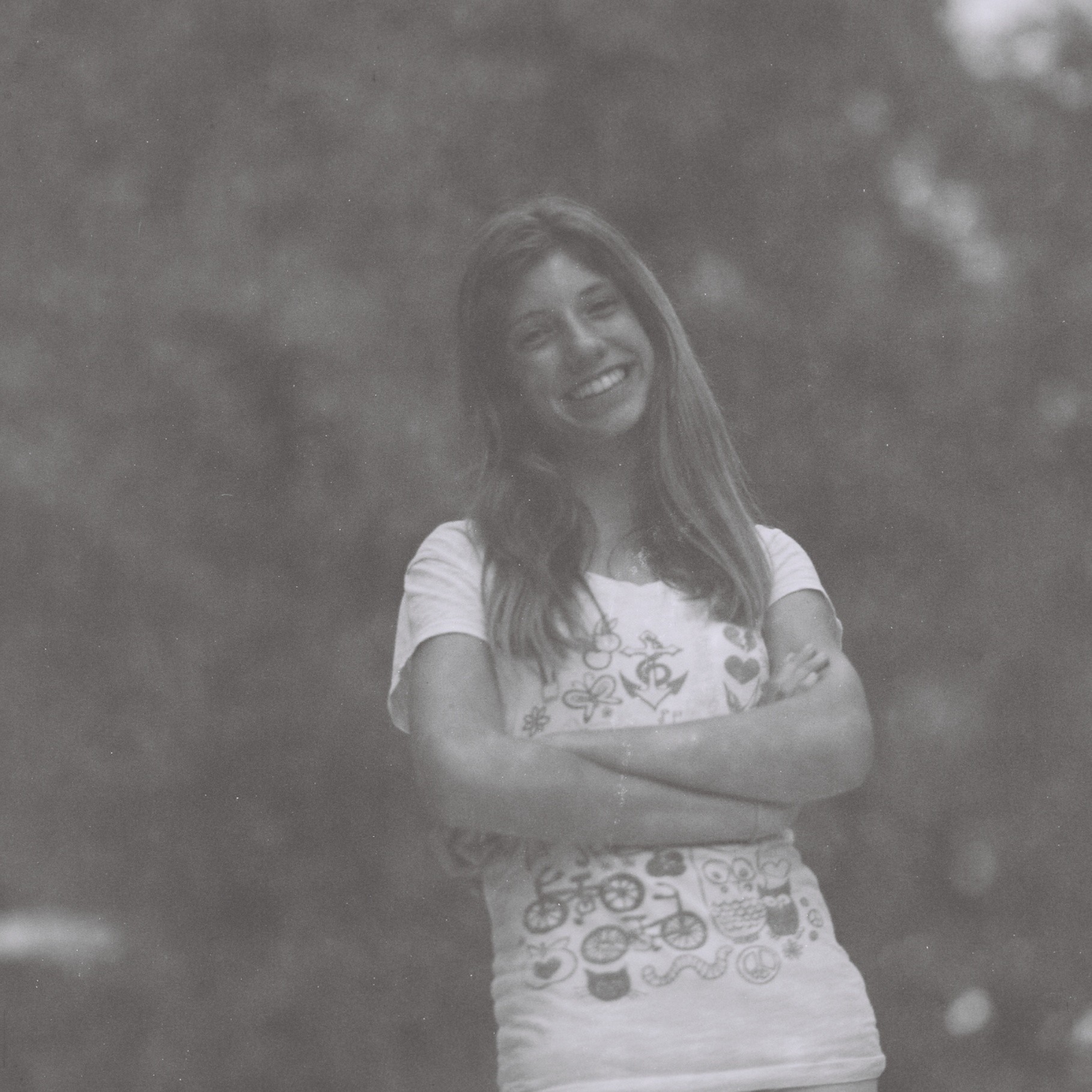

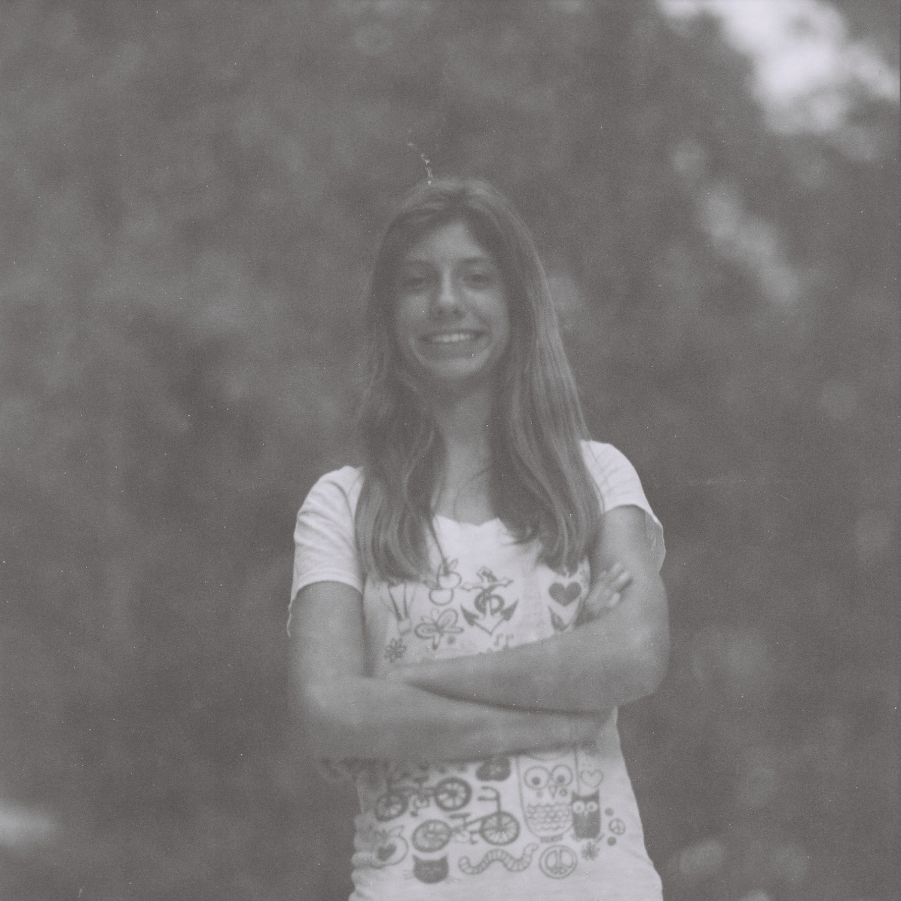

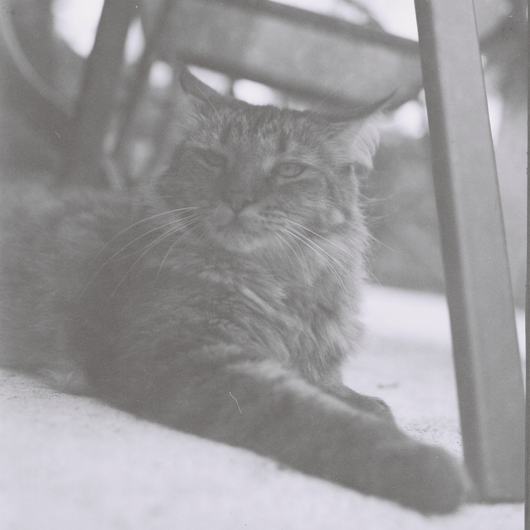

Ok, so I shot a roll of expired (by 43 years) 120 Pan through the camera. I was guessing at exposures, as I didn't have my Sekonic handy when I took them. I also picked up a roll of fresh film when I picked up the negs/CD, so I'll probably be running it through soon.
Below is are 4 examples of how they turned out, unprocessed. They have close to zero contrast, and kind of cruddy overall. Is this a film problem, a photographer problem, or a camera problem. I realize it'll be guess-work, but just looking for some opinions on where the major problem appears to be. I'm leaning towards the film.

Well the film is 43 years old. I have never shot film that old but I have seen old color film that produced faded, off colors and lack of contrast.
Try running a new roll through it and see what you get.

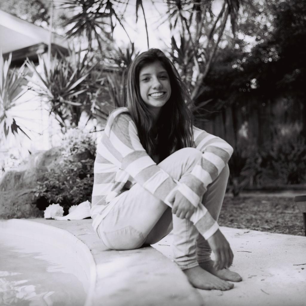

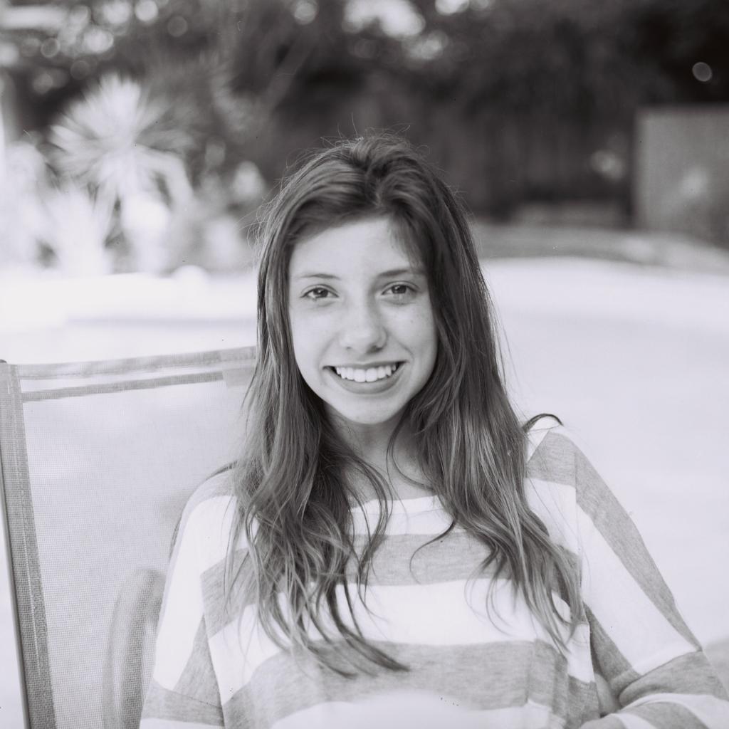

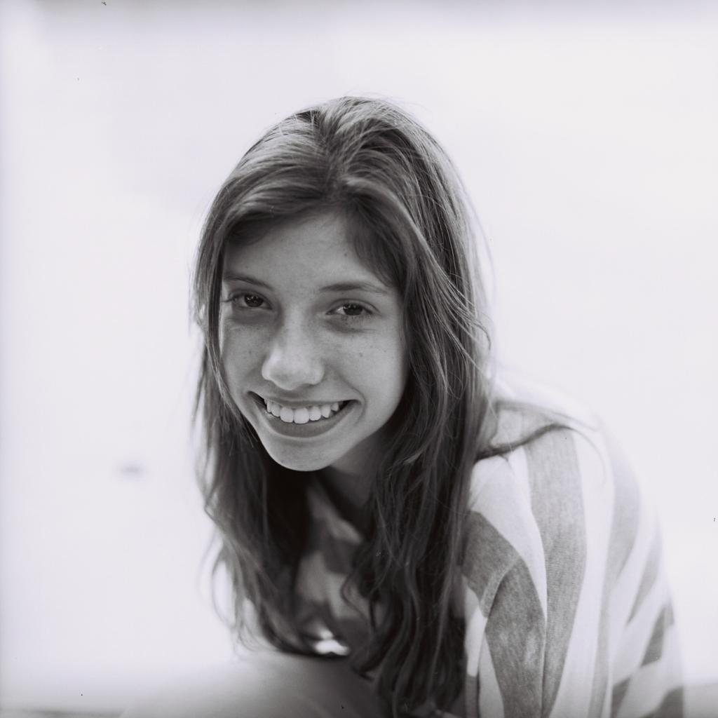

Well, grabbed my daughter yesterday, and a fresh roll of Ilford B&W, and shot the roll. I guessed metering (again), but I think I did a lot better. They came back looking just fine. Here are a couple of samples. If you want to see the whole roll, it's here. One photo looks like there were light leaks, but it was the first frame, and I had to load the film twice, as I'm not very smooth with 120, so... yeah. :whistling:
My S2 tends to leak light through the darkslide slot a few frames out of a roll, I simply keep a piece of electrical tape over the darkslide slot and load the camera with the back attached. The only lens I have is the Nikkor 75mm F2.8, and it is one of the sharpest lenses I've ever used rivaling the Mamiya-Sekor lens on my RB67.
