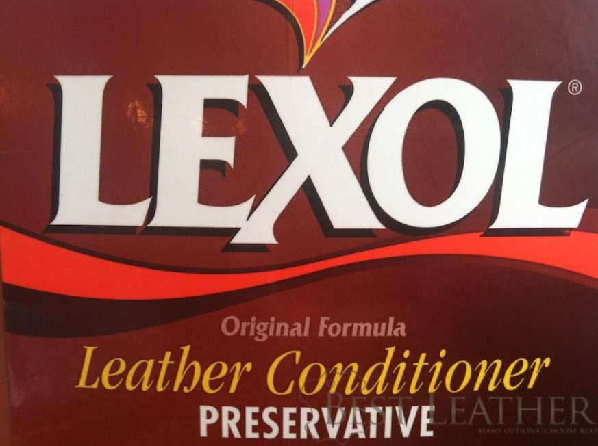

Probably good advice that. I don’t use oil myself but a more solid wax-like stuff originally meant for furniture which is very easy to apply thinly and evenly. Excess is carefully buffed off with a cloth and a-tips.
But, yeah, like you said: just imagine how thin of a coat of shoe polish you need for your boots and then scale that down to the thin leather of the bellows.
You want something that won’t rot, and encourage mold growth, even when between folds for years and years, bees wax checks that.
And you want something that doesn’t necessitate applying pressure to apply.
Again, this is a very easily destroyed structure.
A solid wax sounds daunting.
Again, this is a very this easily destroyed structure.
It’s more of a soft paste like shoe-polish.

Lexol leather conditioner (in the US) is a liquid so can be wiped on in very thin coats. I imagine that there are dozens of similar products used by horse people and shoe makers.
The purpose is not cosmetic and it should not rot or get moldy under any circumstances.
It’s purely to keep the leather from shrinking and not be pulling the bellows inwards (and drying out in and not being light tight in the process).
