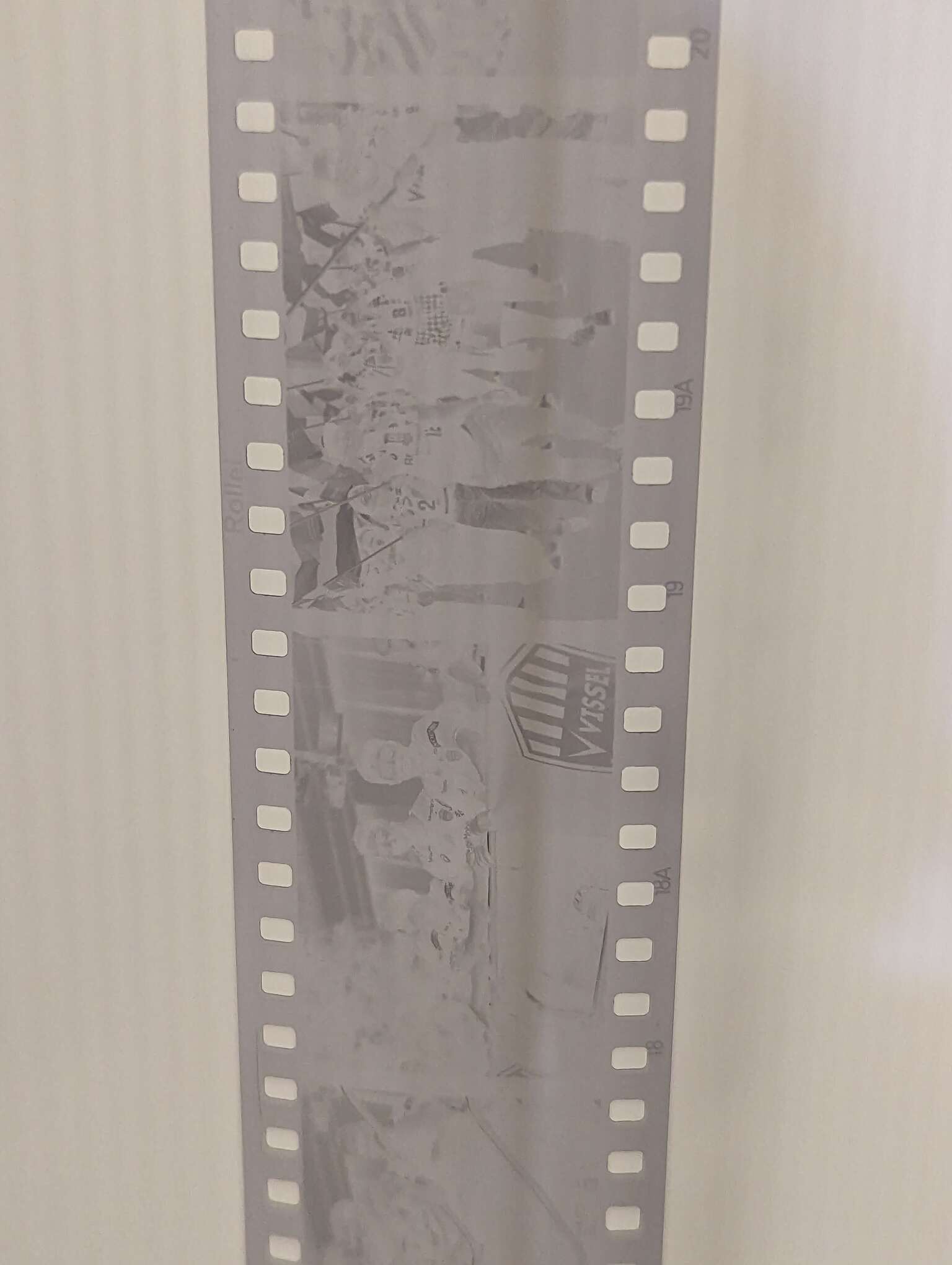

I'm pretty new to developing and would appreciate some help identifying what went wrong with my Rollei Blackbird. The base looks fogged consistently on the entire roll and the image is thin. Compared to an Agfa Copex Rapid which I developed using mostly the same chemicals on the same day, which came out acceptable.
I am comparing my roll with that of YouTuber Shaka1277 in video "My First Roll of Rollei Blackbird, in the Hasselblad XPan II" you can see his film strip at 1:57. I thought maybe my film was underdeveloped (time or temperature) based on "Common Processing Problems" by Ilford but then wouldn't have expected the base to be so dense. Shaka1277's base looks lighter (although admittedly it could be the lighting).
Film condition: both were purchased new and unexpired from a photo shop, I am the original owner, and I don't recall the expiration date, but I believe neither would have been more than 1 year expired at the time of development. They were shot about 5~6 months before being developed. Stored in a closed closet, in the film canister pretty much the entire time, both before and after shooting.

Looks like serious underdevelopment to me.
This could have a few causes, like stale Adinol - it doesnt have the famous keeping properties the classic Rodinal had. Did you develop both films shortly after eachother, or were there weeks or months in between? It could also be caused because you did cut a few corners to much, like not measuring the amount of developer precisely enough or your water being a few degrees colder then you actually thought is was - normally you compensate with about 10% for every degree the water differs from 20 c and some developers stop working when temperature gets below 17 c et cetera..
What i also imagine to see is a milky streak running over the middle of your film - the tell tale signs of spend fixer. Fix has good keeping properties, but limited capacity and quite a few of us keep track of how much film was fixed with a certain batch, as bad fixing has a desastrous effect on the archival properties of the film.
For sure!
However, he did use the same Adinol for the Copex that came out OK, it seems.
I put my money on a measurement or timing issue; i.e. too low development temperature, timer set incorrectly or stopped early during development or a developer mixing error.

So, I'm pretty sure I think I know what went wrong. A combination of "Looks like serious underdevelopment to me" and "but around this time of year, the water from our tap runs considerably cooler than 20C - more like 10-12C" led me to the conclusion. I only measured the tap water for the Agfa Copex Rapid, not the Blackbird, assuming them to be the same. I just tried the cold tap water now and it came out 15C to 16C. But, if I were using the hot water directly before getting the water for the Agfa Copex Rapid, it would have come out hotter than 16C. Thanks for all the pointers.

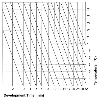

Yeah, that's a pretty significant difference. If you look at temperature compensation curves, you'll notice that a 5C difference would require a pretty dramatic adjustment in development time.
Your 11 minute time at 20C would have had to be extended to around 22 minutes at 15C to obtain the same result. The underdeveloped film strip seems to be in agreement with this.
In case you happen to try again with a controlled temperature approach, please let us know if this actually solves the problem!
My eyes might be playing tricks on me but doesn't it look more like 18.5 minutes at 15C?
