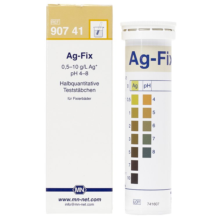

Let me get this correct. For TF3, I fix in “ bath one” for 30 sec. then in “ bath two” for 30 sec.. . . Ok got it. How many 8x10 paper do I get out a liter for bath one? How many 8x10 paper for bath two? I’m assuming each has their own container? Do you ever move bath two to bath one And make a fresh “ bath two” ?
I can't really answer for TF3 fixer, but, to my humble insights, 30 sec. seems rather short, even twice.
The capacity for a fixer bath is not that easy to determine. Ilford advices that 3 g/L. of Ag is allowed before the bath must be discarded.
What I do, and this is my personal procedure, is testing with an Ag test strip the first bath (see attached picture), when the first one exceed the 3 g/L, then the second one becomes the first and bath two wil be freshly made. So this is an endless move on.
About the treatment time: here I follow the manufacturers advice.
As I work with Fuji-Hunt Unilec fixer, which is a neutral-to-slightly alkalic product (pH +/- 7), I fix for 2 min. twice (two bath @ 22°C) and at a 1+4 dilution, this is for fiber based paper (FOMA). Preceded by a buffered stop bath.
This fixer holds for a very long time and can be regenerated, even by just topping off, which is an important environmental plus.
BTW, the first fixer bath always suffers the most as it must endeavour the test printing strips too, and these 'strips' are, in most of the cases, cut with a not so sharp device.
Cutting with a not good (appropriate) knife frills the cutting side and 'loosens' crumbs of the silver holding emulsion which crumble into the different baths, yet the most in the first fixer as it takes some time for 'dissolving' and to come off, and so these particles end in the first fix (after a while you will observe that fix 1 holds a kind of a dark sediment)...
