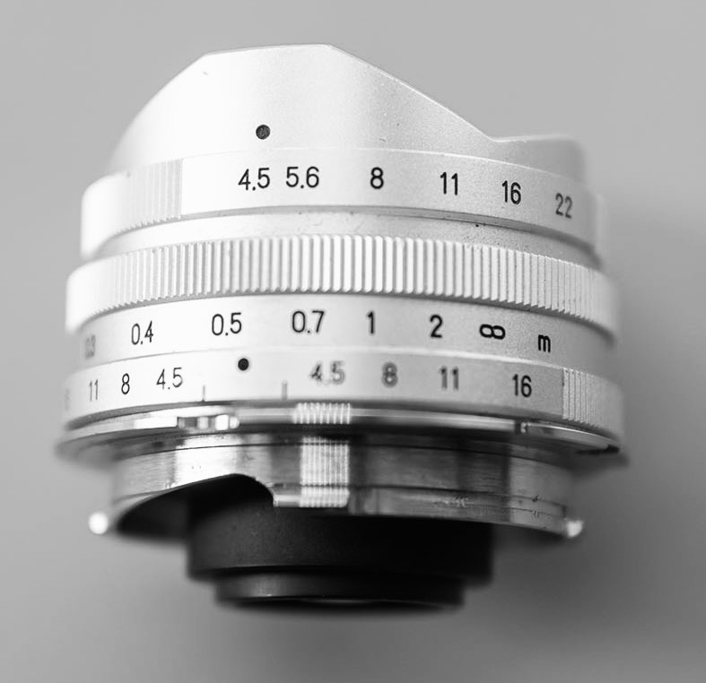

Looking for input on filter use on this Heliar 15mm first version lens. It has no filter threads and built in hood. I don't see an off-the-shelf solution, but was thinking about adopting something like Cokin or similar system holder to mount on the outside of that hood. There seems to be enough space to accept this solution, But maybe there is a ready made solution?
To be clear I am yet to own this lens, but it appears to be a good fit for MDa body.

If I still had mine (sold 'cause it would not accept filters) I'd try this https://www.thingiverse.com/thing:2747754
Note: in the end I also sold V2 'cause it did not see enough use
I think a solution can be found. The file you linked, I'm not sure how that was supposed work. I'm thinking more like a clamp type attachment on the router side, with filter thread on front with something sufficiently larger than the hood diameter (which I'm not sure what that is yet)
This thing is, if I understand the pictures correctly, clamped on the lens, and clamps a 67mm filter.
If you have 3D printer at hand, or someone with such printer, it's worth a try
Thanks. Just realised there were a couple of pictures. I think this concept will kind of work, but I'm not sliding anything on a new lens just to surely scratch outer coating. At least description states "small vignetting at corners" which I guess means 67mm is still too small, but that's a good start to think of own solution. Unfortunately the larger that filter the more obstruction for viewfinder, which in the end might prove counterproductive.
there's another version with 77mm filters. I agree on VF obstruction.

This is purely for Leica MDa so non SLR use. Hoping for a solution that will allow filter change. This would obviously work, but I can't see being that committed to a single fixed filter on the bac of the lens.
The Heliar ver. II has actual filter thread, but it's basically double the price, at least, and strangely V.I has minimum focusing 0.3 m while V.II 0.5, which is to me quite a difference.
Back when I had a 15mm Heliar, I printed one of those. It fit fine after a bit of sanding, but I never got around to buying the appropriately sized filter before selling the lens.
