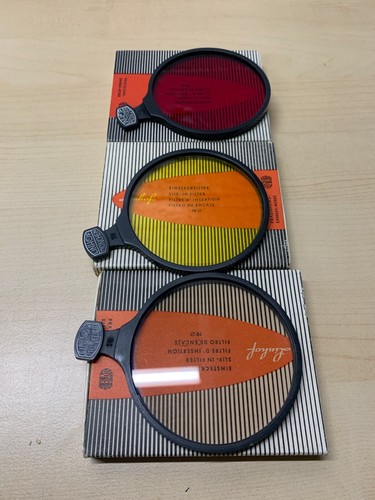

Has anyone used the Linhof universal filter holder and its filters? It may be the mount section from the universal shade without the shade i'm still not clear on that.
The device: https://www.ebay.com/itm/1550276528...CqfPlTsaJLPZ8DyhX7OgqfDbgQ==|tkp:BFBM7JT7rp9i
The Filters.
To me, this may be appropriate for some of the lenses with no barrel threads. Maybe?

I do no know this adapter however as far as Hasselblad kit is concerned, speaking to Bay 60 and or 67 mm, I believe that 70 mm drop in filter set would no be practical, as, especially with buying good used filters, you often have to consider larger sized filters that are available, such as 72 mm or 76 mm which can be easier to find than on the target Bay 60 or 67 mm filters for most CF, CFi, etc lenses we desire to use them on.
Round or Square filters rock, handled proprietary filters are a dead street with little turn around when your kit changes.
