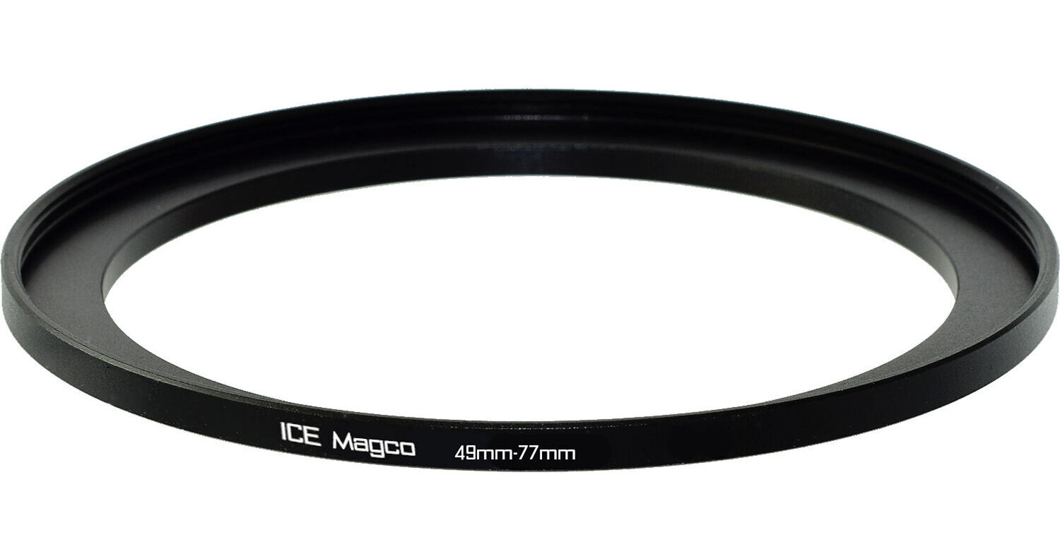

Hi folks,
In a bid to keep on top of costs, hassle and storage space, I'm looking to find a way to buy one set of filters which I can use across multiple lenses/cameras.
To be more specific, I have several EF lenses (49mm filter mount, 77mm filter mount) plus a Hasselblad 80mm lens with a B50 mount.
I'm thinking of buying some filters to fit the standard ef screw mount, 77mm size and then get various step up/step down rings to help fit the relevant application (plus adaptor for B50 mount)
Is this effective? E.g. will a space of about an inch (added in step up rings from 49-77mm) cause any optical disadvantages?
I'm sure there is a reason why I don't see this very often, but I'm just trying to get a single set to reduce cost, reduce the amount of gear I need to carry, and generally simplify things!
Alternatively, if there are any setups which could work and should be considered, please let me know?
Thanks!
TT

I have done that with 77mm filters for my large format lens and it works, but I don’t like it for any camera I want to handhold. The issue is the stepped up filter precludes the use of the factory lens hood an adding an additional screw in hood is cumbersome. It also precludes the use of slim polarizers which don’t have front threads.
One advantage is the step up rings can act as a hood when you are not using the filter. On large format lenses this is nice and since the camera is on a tripod I can manually shade the lens if needed.
It’s a compromise that might work for you or might drive you crazy. Also nothing wrong with doing it for most of your lenses but getting a few smaller filters for your most used combinations.

How about looking into something like a Cokin P series filter set with the appropriate adapter ring for each lens or a Lee Filter set, or similar.

I use a few different sizes, and the rest with step-up, e.g. cover 49mm and 55mm for 35mm cameras with 55mm filters, and another set of 82mm for medium format, with step-up from the sizes I use. The filters itself I bought all used in larger packs (with the few things I wanted, e.g. yellow & red, polarization,..., kits of maybe 5 filters), in very good condition, and quality brands (the smaller sizes are all Heliopan, the larger some Hoya). Filters sell used quite cheap when looking at kits. Some other filters, mostly polarization or skylight, came with lenses I bought.
For my Minolta Autocord (Bay 1), I have a Bay 1 to 49mm adapter, but the most common stuff as well in a Rollei bay 1 kit I had found for a good price with Rolleinars.
I also have settled on 77mm as a standard. Works fine for everything with cheap step-up rings. I don't use it for small cameras and lenses -- but for them I rarely use filters, so I have a few 55mm. I have a COKIN P setup for special effects, but if you only use standard filters, stick with circular glass.

49mm filters are pretty inexpensive. I like small filters on small lenses. I'd find a 77mm filter pretty bulky on a small prime lens.

Of course. If you only have, or plan to have, lenses with a 49mm thread -- no problema! But I have long lenses and wide lenses that have 77mm front threads -- and others in-between -- and I want to use them. I'm not going to get a full set of filters for my thin lenses and another for my fat lenses -- that's the same dilemma Twotone faces. It's not perfect, but it works.

Depending on which filters you want to use (as said, I use mainly the black and white contrast filters and polarizer sometimes, but certainly other people use more, from ND to funky stuff), and buying a used complete kit of filters is pretty cheap as long it has what you are looking for. I prefer having a small and a large kit over having a 80mm filter on a 49mm lens, but sure, you could do it. Smaller filters are also much cheaper then the larger diameters, new or used.

I have stuck to Hasselblad CF lenses which use the B60 filter which handles almost all my lenses. When I could not get Hasselblad, B+W or Heliopan filters in B60, I bought a B60 to 67mm adapter, a 62mm to 67mm adapter, and a 67mm swing away adapter for really dark filters such as the 720.

There are step up rings allowing 49mm lens' filter mounts to use 77mm filters. Why use a number of rings to get there? That's what I did with my 4x5 lens and used my existing 77mm filters from my Mamiya RB67 medium format system. For ND filters, I use Cokin P. Don't know about how you do Hasselblad. You could call B&H and ask them what adapter you need.

I settled on two sizes: 49mm for my Pentax 35mm system - most of the lenses in that set have a 49 mm tread anyway and this makes i can use the original hoods and such. Next to that i have a full set 67mm filters for my 4x5 kit, using stepup rings for those lenses that have smaller thread.
As the yellow filter is my most used one, i have a few extra yellow filters in odd filters sizes, for instance for my Rolleiflex and my Contaxt G2. Technically it can be done perhaps, but i wouldn't want to use a 49 mm or even 67 mm on either camera, thinking how it would block the viewing lens or view finder.
The only time a step up ring would be a problem is if and only if the step up ring and filter on a wide angle lens display vignetting.

A problem, in my book, is that in which you'll need be very careful about shading the lenses and filters with a 77mm lens hood, which may vex you in actual shooting where stray light will need taming.
Yeah; any dust will be in focus sooner, and you'll run into trouble with wide angle lenses.
Besides, lugging around 77mm filters on an apparently compact lens (49mm filter size after all) sounds a bit counterproductive.
I've got a couple of filters in sizes I use the most. I think ultimately this is more convenient than the 'one size fits all' approach. YMMV.

I keep a step-up adapter on each lens ready for the 77mm filters.

Likewise. I have multiple filter wallets with the basic filters I use in each size. Costs a bit more to have "redndancy" like that but filters are basically a one-time cost if treated right. Only time this is inconvenience in terms of bulk is when using multiple cameras with different filter sizes.

it's also worth considering the cost of 77mm brand name filters....using them on 49mm lenses seems like a sense of false economy

I already had a set of 77mm filters which goes with my Mamiya RB67 medium format lenses. All I needed was the step up adapters to attach to the 4x5 lenses. The P adapter from the Cokin holder also attaches to the adapters.
