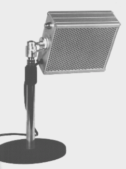

I use a Weller WSA350 but don't know that I'd recommend it, because airflow isn't especially strong, and I have the sense that it's not too effective.
I've been working with this device for years
and just ordered this one because it's quieter and has a higher suction power.
Both have replaceable activated carbon filters.

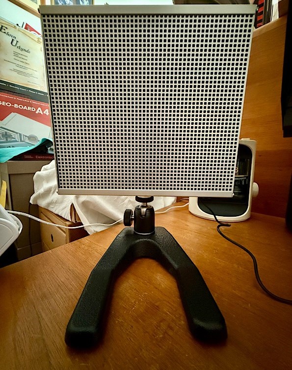

My Distelkamp LDA 4 solder fume and pollutant absorber arrived today.
A solid, all-metal design with four fans and acticved carbon filter.
It's pleasantly quiet, powerful, and even absorbs the fumes from my solvents.
The optional base is made of cast iron with an all-metal ball joint.
I replaced the smaller version with this one after years.
The service and delivery times are excellent.
I can recommend this manufacturer.

I now work regularly with this absorber, and I'm very satisfied.
No soldering fumes get in my nose or eyes, and even solvent fumes are extracted.
With its split stand and vertical position, the unit takes up very little space on the table.
The noise from the four built-in fans is muffled, and I can listen to music while I work. The gentle breeze is pleasant.
This is particularly helpful when working with desoldering braid and a lot of flux, as whole clouds of smoke rise up and disappear into the absorber.
