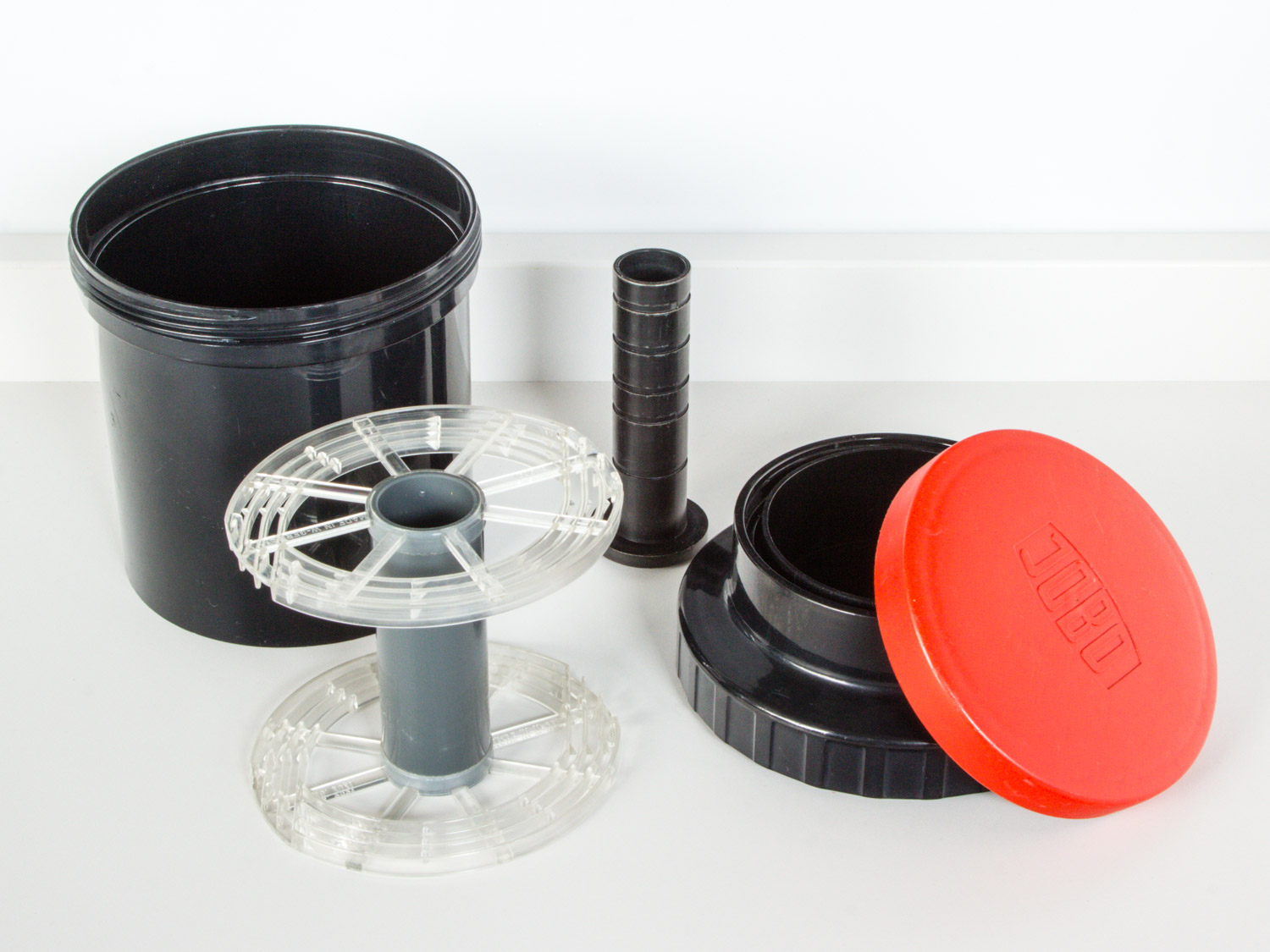

I have for sale a Jobo tank (2236) with a special Jobo reel (2021) to develop 9x12cm sheet films.
The reel takes up to 6 sheets.
Price: 50,-€
I'm located in germany.
Worldwide shipping by registered mail and Paypal fees are included.
btw: I can also provide you the standard reels for this tank to develop 35mm/120/127 film for 10€ apiece

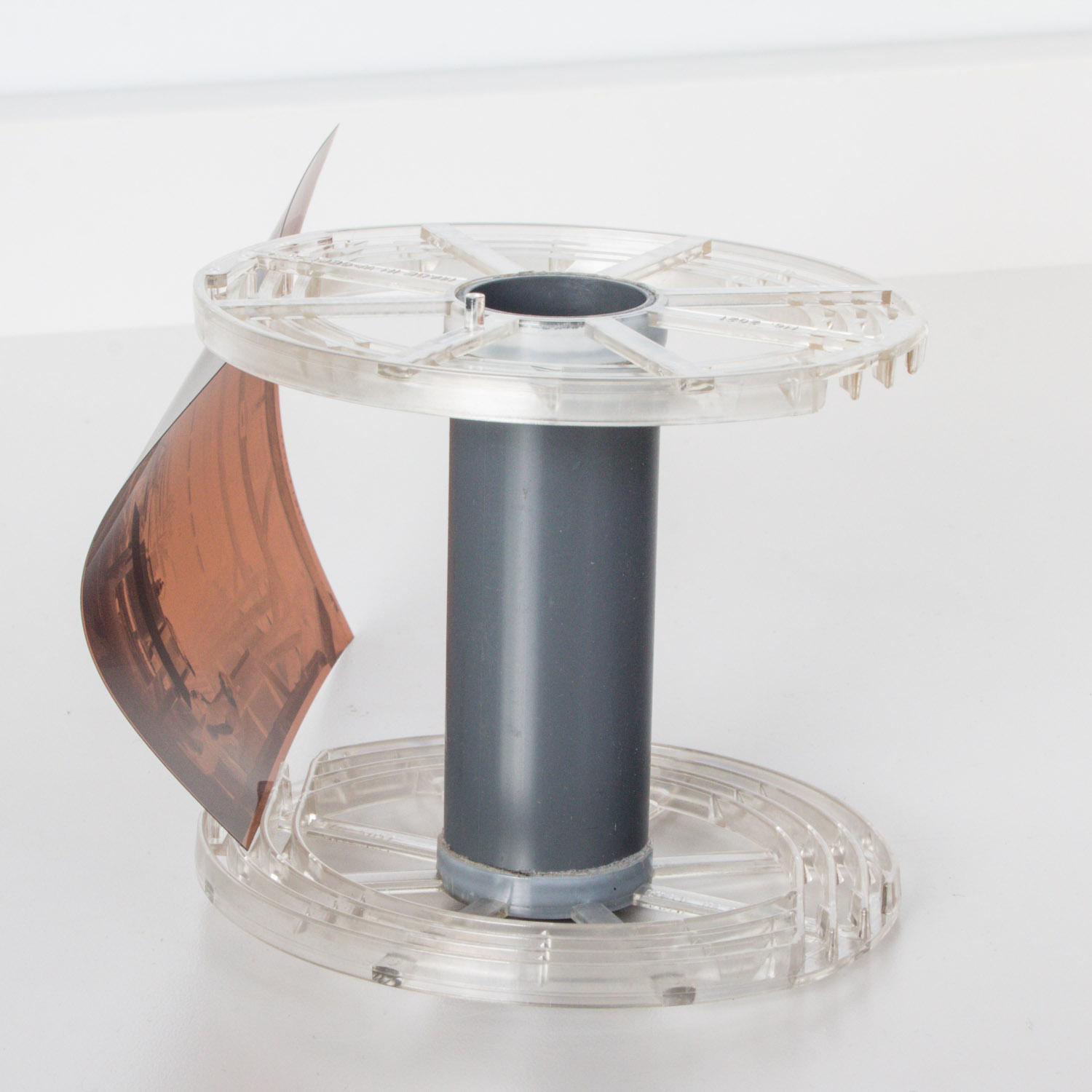

No worries, Lutz. I was asking about the 9x12 vs. 4x5 aspect of the reel because everything I've ever seen about the elliptical 2021 reels is that they are for 4x5 film (other posts here at Photrio seem to confirm this). My guess is that, like the 2509n reels, the 2021 can accept both 4x5 and 9x12 sheets, with the caveat that it holds 9x12 sheets with slightly less tension owing to their smaller size. I already own a few 2500 series reels and tanks and was interested in the 2236+2021 for the purpose of developing 4x5 sheets in the Jobo TBE-2 tempering bath (the 2500 tanks do not fit the TBE-2). If, however, someone's already claimed the tank, don't give it a second thought. Best of luck with your sale.
Okay, so you would call this just as holding a 4x5 sheet with "slightly more tension"? (Just a joke)
A picture tells more than thousand words... ;-)
That doesn't mean that other posts at photrio are wrong, but that i think there are 2021 reels in both sizes.
That is new for me too. I though it would be the 2023 reel that is for 4x5...
So, this discussion is of help for both of us: one has to measure always the real size of a 2021 reel.
The reel that i offered is definitely for using 9x12cm sheets only.
Btw: The diameter of the tank is exactly 11,8cm
