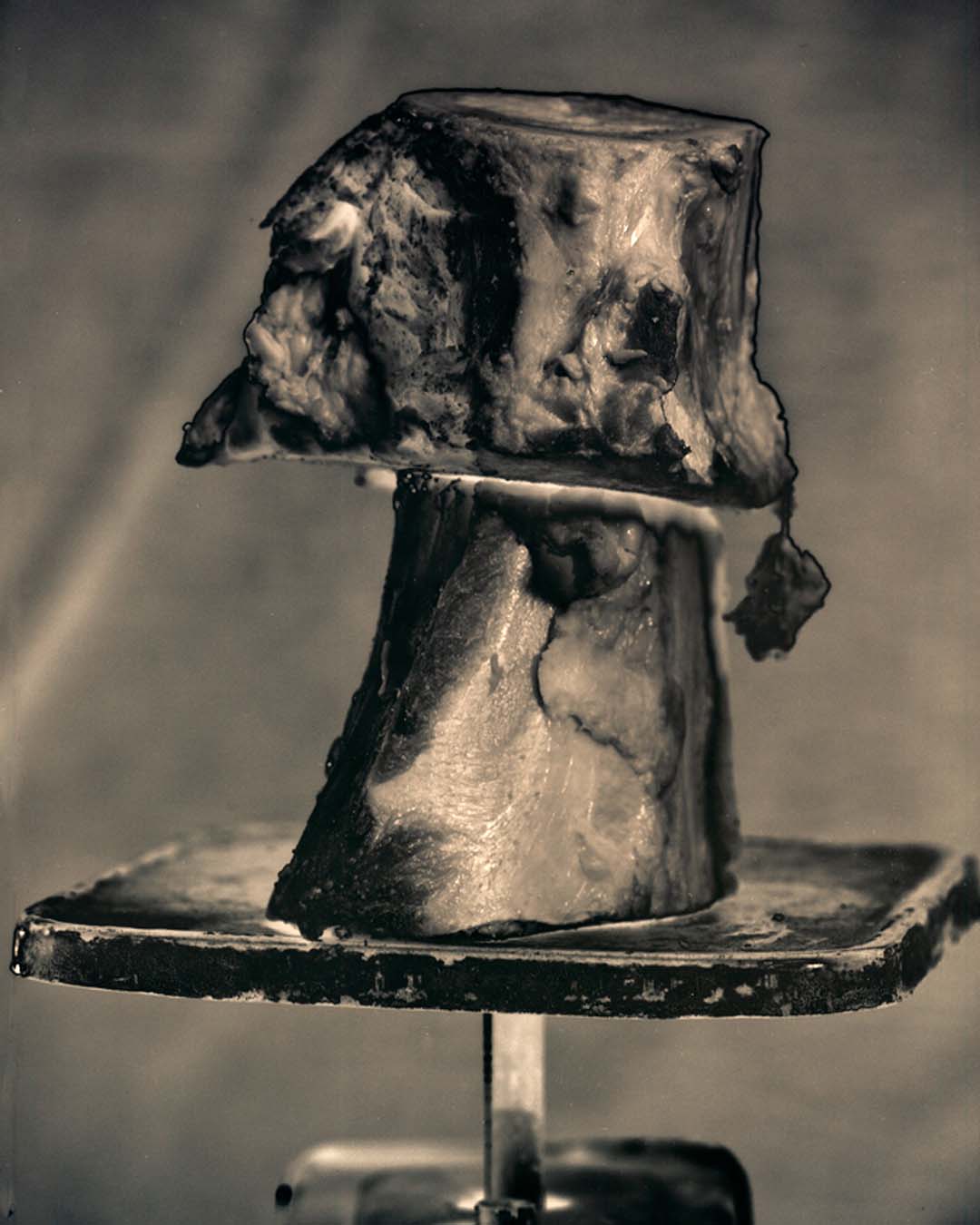

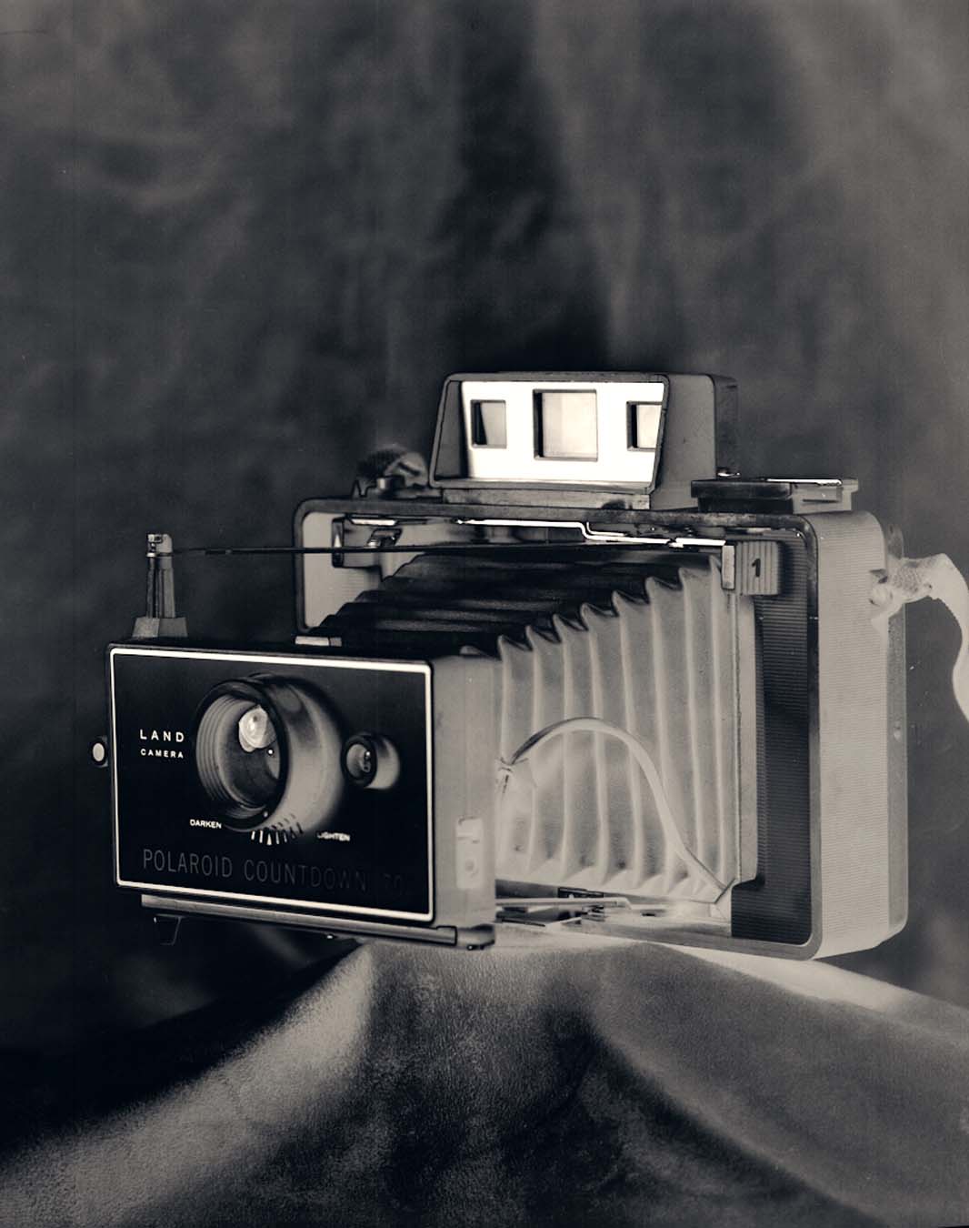

I am attaching a couple of images from my last show here in Toronto ... These images are Sabatier images done by flashing the 8x10 negative... my early work was all print flashing.
These prints are murals on Art 300 duo toned with Bleach Sepia and a bit of strong Selenium.

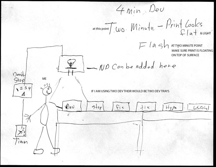

Here is a sophisticated to scale diagram of my working technique.... patent pending.
tkamiya
Oct 3, 2009
4,284
Central Flor
how are you controlling the second exposure?
I wasn't.... I was just playing around. I stuck a tray in a tray developer under my second enlarger and turned it on for 2 seconds. I had everything setup already for a printing session so I thought I'll find out for myself how badly I can mess up. I was very successful.... :whistling:
I'm going to hang a small wattage bulb above my wet side and hook it up to a timer. It'll be similar to your setup except leg of the table won't be going through my foot. (ouch)
