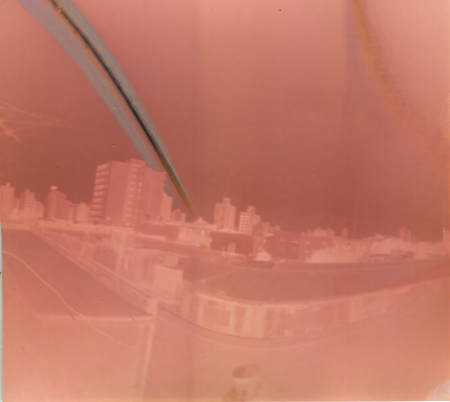

Hello, this is one of my first solargraphs.
I've just discovered the tecnique and am fascinated.
I wonder...
Does anyone know why some lines appear darker than the sky?
Or why does that one line look so much brighter than the rest?
I noticed it happens in other solargraphs from other people as well.
I read about how cloudy days affect the result, but why the change in brightness/luminosity?
Thank you.

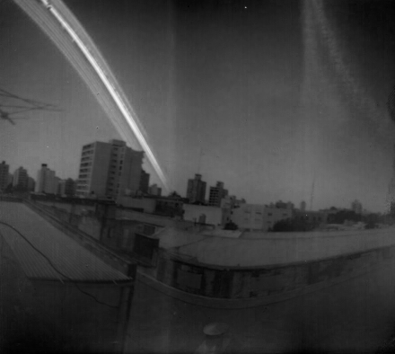

I think those darker lines are indeed still the sun, but dimmer. Do you notice how the lower lines follow the trajectory and go behind the building? Whether they are dimmer because the days were cloudy is a good guess.
I'd love to hear about the process. How long was the exposure? How did you make the camera?
But Daniela, in a positive image, where light tones represent higher luminosities and dark ones represent low luminosities, how would the brightest element in the scene render darker than its surroundings?
The first thing I'm reminded of is actual solarization (not to be confused with Sabattier processing), i.e. reversal of tones due to extreme overexposure. If this is what's happening here, it would mean the darker lines are actually the sun on clear days, and the brighter lines are the sun on more hazy days, with cloudy days not leaving a line at all...
And indeed, welcome to Photrio, @yesica-s ! Would you mind telling us a bit more on how you made this image?

Hola! (yes, my native language is Spanish). Indeed, I am from La Plata, Buenos Aires, Argentina. Thanks for the warm welcome.
The camera was made with 2 beer cans. The pinhole (approximately 0,35mm diameter) done in a sheet of aluminum foil placed over a small aperture into the side of the can, at half height.
I used glossy Kentmere paper, and painted the inside of the cans with matte black spray. Also used duct tape to seal the camera once it was all done.
The camera was put on a terrace, facing East.
From 4th October to 17th October 2023: 13 days.

And here are the raw files, prior to editing:
It does sound like overexposure could be the reason for those dark lines, specially after taking a look at how the weather was like in those days. A lot of visible sun with no clouds.
I wonder what causes this potential overexposure. It may have something to do with the size of the pinhole? or the glossy paper?
I do like the result and will experiment more. More cans on the way.
Ahh, but the additional scans make it a bit more clear. This is not an instance of tone reversal / solarization. What you're seeing is different hues because when printed out (as opposed to developing it), a silver halide emulsion creates different hues/colors depending on the degree of exposure.
If you take your scanned original, invert it and then only look at the red channel, you get a more sensible output:
By 'sensible', I mean something that intuitively feels 'correct' - not that it's necessarily more artistically appealing etc.
Thank you. That looks more accurate, yes.
Clearly editing is an important step in discovering what the can registered.
So having discovered that the red channel contained the most "accurate" representation of the sun (just because it always looks brighter than the sky), I'm still curious about why that one line looks incredibly brighter than the others.
I guess a lot of the reaction of the silver halide emulsion is actually random? but some of the fenomenons must have all sort of explanations. Do you know of a list of texts on where to study these processes? I've been reading some articles on the internet, but any recommendations are welcome.
It's probably not just one line, but a few lines overlapping each other. They may be brighter due to pinhole geometry (a punched hole will collimate light to a small extent), beer can positioning, weather conditions etc.
No, I wouldn't call it random. It's actually pretty predictable and consistent. Otherwise, it would be impossible to manufacture film and paper with any consistency.

What I had in mind here was researching about why the red channel contained the visibly brighter lines, and not the other channels, for example. I will continue searching the web and this forum as well for more information. Thank you for your help, it's very much appreciated.
Ah, okay. Well, my choice for the red channel was simply based on the overall look of the original image tending towards red, so it was kind of an obvious angle to take. Combine this with the notion that lumen prints tend towards hues that are close to the red part of the spectrum (i.e. yellows, tans, reds, purples) and red made sense to me.
The question then of course becomes why silver halide prints out in these red, yellow etc. hues. This is apparently due to (at least in part) grain size, with tiny silver grains being white to colorless, and they progress through yellow, orange, red and ultimately brown, black and violet/blue as they grow bigger. There are more aspects to silver grain hue, I suppose, but grain size seems to be an important factor, at least.
