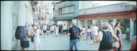

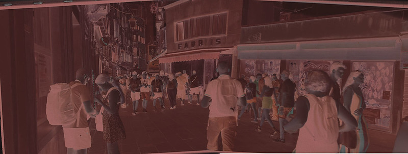

I don't seem to you have much of a choice, either you align the scans by hand or use proper tool with proper settings for the job. I've shown you the example stitch with proof that no geometry correction is done in PS Photomerge with reposition mode. MS ICE will be more like 'collage' mode.
Both, reposition and collage mode don't introduce geometry correction per se, but they differ in how the joints between partial scans will be made. The 'collage' mode will rotate (this is not geometry altering of the partial scan) the partial images to create the best joints when 'reposition' won't even rotate images (so the joints will be of slightly worse quality). In ideal situation, when you have partial scans made with absolutely zero longitudinal tilt of the film in scanner holder between the partial scans, scanner lens focused at exactly same position, film with exactly same arch because of scanner induced heat...., both will produce the same result. Of course, none of this will be true in real life.
This is an exaggerated case of what you would get if you had a huge difference in film alignment between partial scans:
Left & right part:
PS Photomerge 'reposition':
PS Photomerge 'collage':
MS ICE:

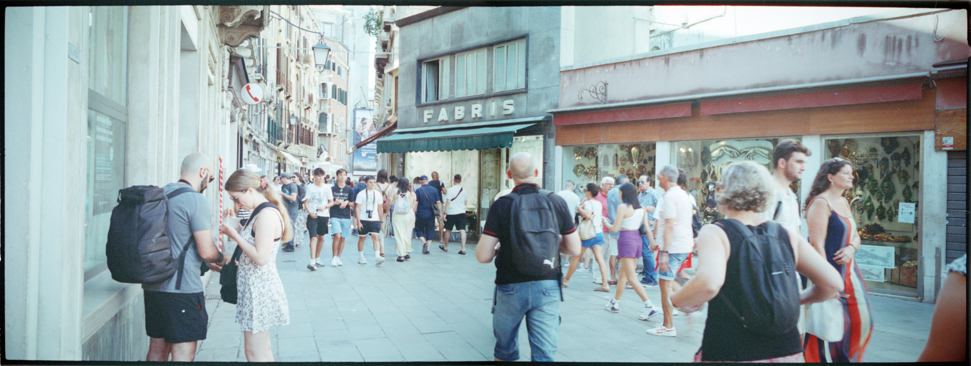

Well, here's the simple version processed entirely in Affinity, including inversion.
Stitching was literally "create panorama", add both files, hit "stitch".
While the film frame itself is curved, note that the image itself is straight, and there are no distortions in the line of the roof edge, for instance. I left the register in deliberately, but cropped down to just the image, there's no visible distortion.
Inversion was slightly more complicated. Most of the time was spent correcting the overall scene, as it seemed a bit washed out to me.
My Hugin install (linux) seems to be a bit confused right now-- if I can get it straightened out (so to speak), I'll post a sample of that too.

I don’t want it to correct distortion!!!!
I don’t want them to change the geometric integrity of my photos.
While the film frame itself is curved...
... and the rest, too. You may not care about that since the distortion is not huge, but some people would rather have the scan exactly the same as the negative. It's not any harder, you just need to use a proper tool.
Sorry-- implied was that if it can correct distortion, a non-distorted image should result in zero distortion.
But it's still not entirely clear, at least to me, what type of distortion you're experiencing.
