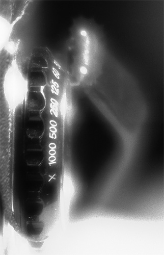

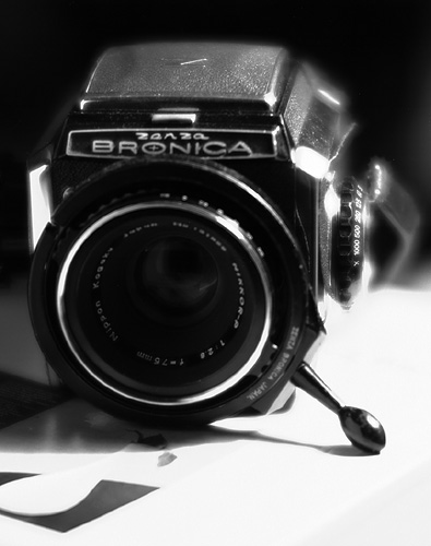

Here's the test shot and a detail that really shows the Veritocity of the thing (I know--it's totally lame to be taking photographs of cameras, but it was the closest interesting thing at hand that would generate some good specular highlights). Polaroid Type 55, neg scan, f:6.3 or so, 6 sec., one desk lamp and a large sheet of white paper as a reflector.

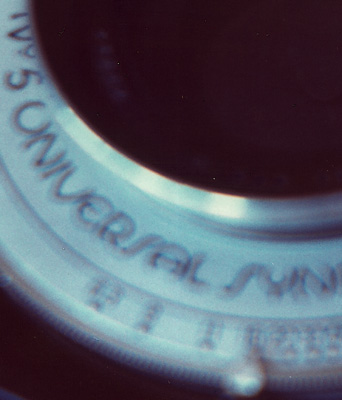

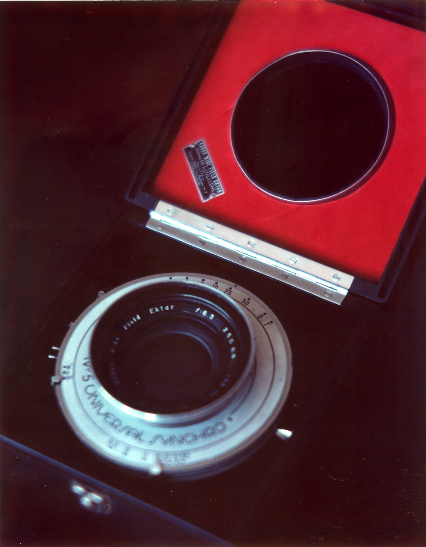

I just bought this lovely original box for my 10" WF Ektar from Mike Whiting here on APUG, and made an 8x10" Polaroid of it with the 14.5" Verito, that shows a good example of the front bokeh vs. the rear bokeh with the Verito. Here's the full shot (Type 809, 1/3 stop down from f:8, 2 sec., 81B+81C filters)--
The first detail attached shows the characteristic Verito glow a little behind the plane of focus. The second detail shows the "bad" double-line bokeh in front of the plane of focus.

The glow....beautiful. Thanks David for sharing these examples. The way the prices on these verito's are rising, it won't be long before the Cooke PS starts to look affordable.
