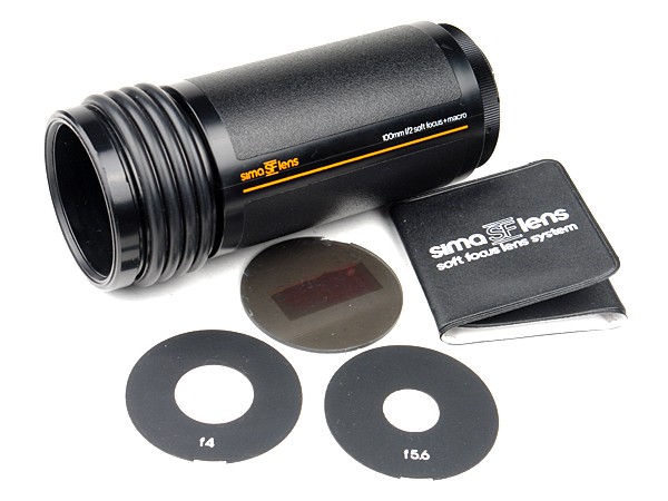

There is also this Sima 100mm soft focus lens, which is very inexpensive. And some people had excellent results with Sima plus 1.4x teleconverter. But again, it is a bit too longer for OP.
Thanks for mentioning that one. I could picture it, but could not remember the name. It's similar in some ways to the Spiratone Portagon, and probably easy to find at a good price. It has a FAST f2 (?) aperture with discs for a sharper image for f4 and f5.6. Focusing is done by pushing the lens out along the outer tube.
