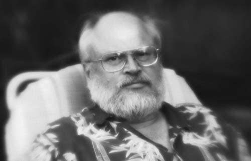

Dear Apug / Photrio community,
For years I have been working with a Rodenstock Imagon lens. I have the 120, 150, 200 and 300mm. I mainly do landscapes on 120 or 4x5. Lately I started to photograph some architecture with it.
The Imagon is an achromatic lens equipped with diffusion or sieve aperture discs and produces soft images.
I like to exaggerate the soft effect by not using the discs, it can give marvelous optic/photographic effects.
Working on 35mm format I can use the 150 mm on my Nikon because that one came with an F-mount tube, but the angle of view is too narrow for the things I want to do.
So now I am looking for a soft focus lens in 35 mm format with a focal lengt of about 50mm with (kind of) the same optical qualities as an Imagon. Does such a lens exist? Can anybody help me with my search?
Thank you all in advance.

Regarding the example picture you posted, I have seen similar achieved with double exposures, one wide open and focused close, the other taken normally.
