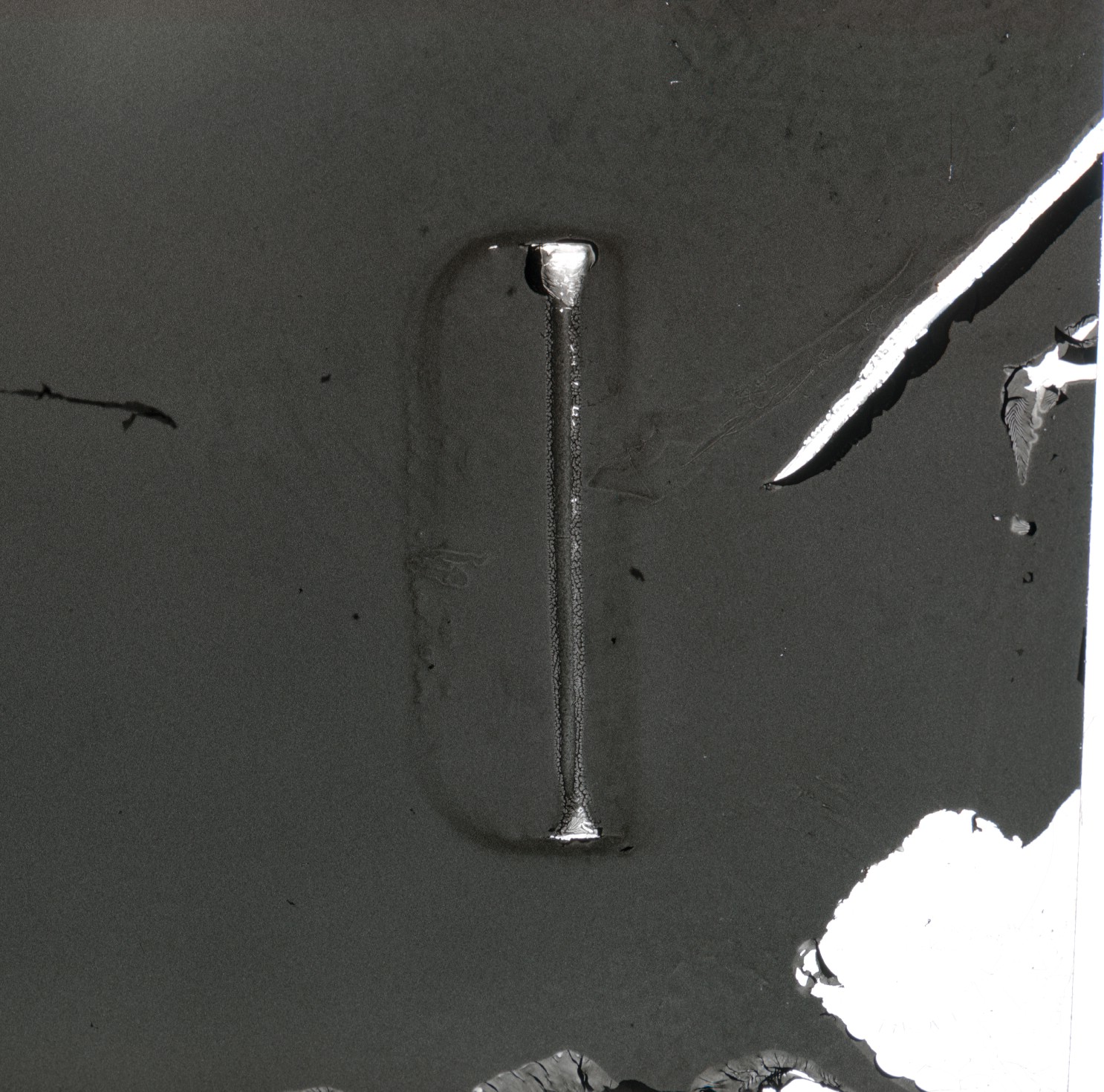

I've been reversal processing B&W for quite some time now, using a permanganate bleach. It's widely reported (and I've noticed myself) that permanganate softens the gelatin. I've always used films treated with the modern family of hardeners (Ilford and Kodak), so I've never had much problem. As long as I keep temperatures at a consistent 20 degrees C, and "squeegee" carefully between my fingers, the only emulsion damage I've noticed is caused by the ball bearings when reloading the films onto Paterson reels after the second exposure.
Tonight was different. I decided to process some Rollei IR400 film. Throughout processing, I inspect the film, and noticed no problems until I poured out the rinse water following final development. I noticed little black flecks which I recognized as flakes of emulsion. I quit rinsing, removed the film, and hung to dry before I could cause further damage. Fortunately, it appears as most of the damage to the emulsion occurred between the sprocket holes and did not extend into the image area.
I am concerned that I did not complete washing. In my normal process, I also do a final fix to remove any non-light sensitive AgX that may not have been developable in the final developer. (Not sure if this is really required, I guess that potentially it could print out with enough exposure to light?) I would like to fix, wash and final rinse (photo flo) this film, but I am concerned that I may subject the film to further emulsion damage. After drying, and then re-wetting, will the emulsion still be soft, or does drying harden the film? Should a hardener be used, or wouldn't that help now? I have access to formaldehyde, but currently not chrome alum.
If anyone has any good resources on reversal processing, I'd love to hear. Haist is the best I've found so far, but permanganate bleach only occupies a couple pages of his discussion.

If the emulsion comes off in bits and pieces, then it could be the type of subbing used between the film base and the emulsion. The flakes are hardened emulsion lifting away from a "destroyed" subbing layer. In this case, there is probably nothing that can be done and indicates that the film in question cannot be processed by this method.
IDK for sure, of course.

1. Emulsion damage was in the sprocket area, so chem fogging (not removing/reloading films onto reels) might help.
2. Careful temperature control, processing at a lower temperature and careful agitation could help reduce the toll taken on the emulsion.
3. Despite my best efforts, the film may not be compatible with my process (KMnO4).

Here's an image of the emulsion damage from the end of the roll. The vertical line in the middle is from my small metal film clip. Shockingly, not a single frame has emulsion damage extending into the image area, nor any flecks of emulsion from elsewhere adhered onto the surface of the image. Now that the film has dried, I tried scratching the emulsion with my fingernail near the end of the roll, where it looks like it's peeling in the photo below. I could not dislodge any flakes of emulsion, nor could I scratch it.
