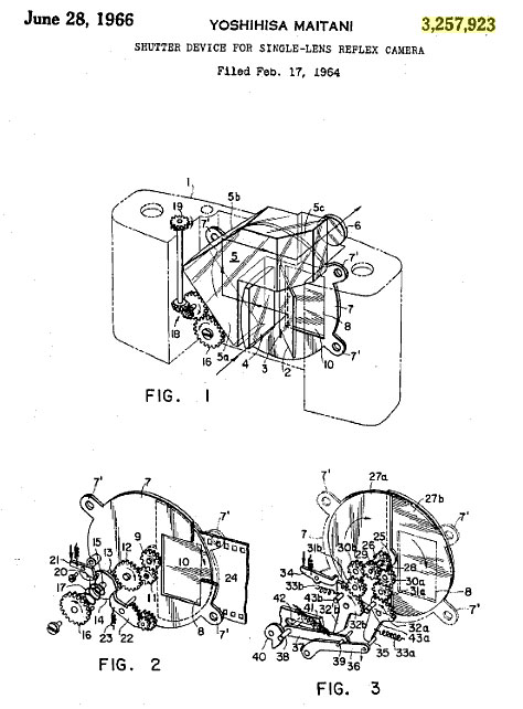

From the patent diagram for the Pen F, I believe the rotary shutter there is really a half disk that rotates to cover or expose the film gate. The varying speeds are attained by varying the spring tension that drives the disk:
There is a summary of the design process in a lecture by Mr Maitani: https://www.olympus-global.com/technology/museum/lecture/vol1_04/
I wonder if that isn't approximately the same method used by the Univex Mercury? It would certainly be more in reach than varying a slit width on a rotary disk (basically requiring two disks that lock together at multiple included angles). Most commonly, however, that leads to the infamous, hard to design, fabricate, and maintain pallet delay to get slow speeds.

The Mercury shutter always rotates at the same speed with a variable sector width to determine exposure.
I think the design objective was to reliably achieve 1/1000 second with a mechanism that was fairly easy to manufacture with average labor skills.
