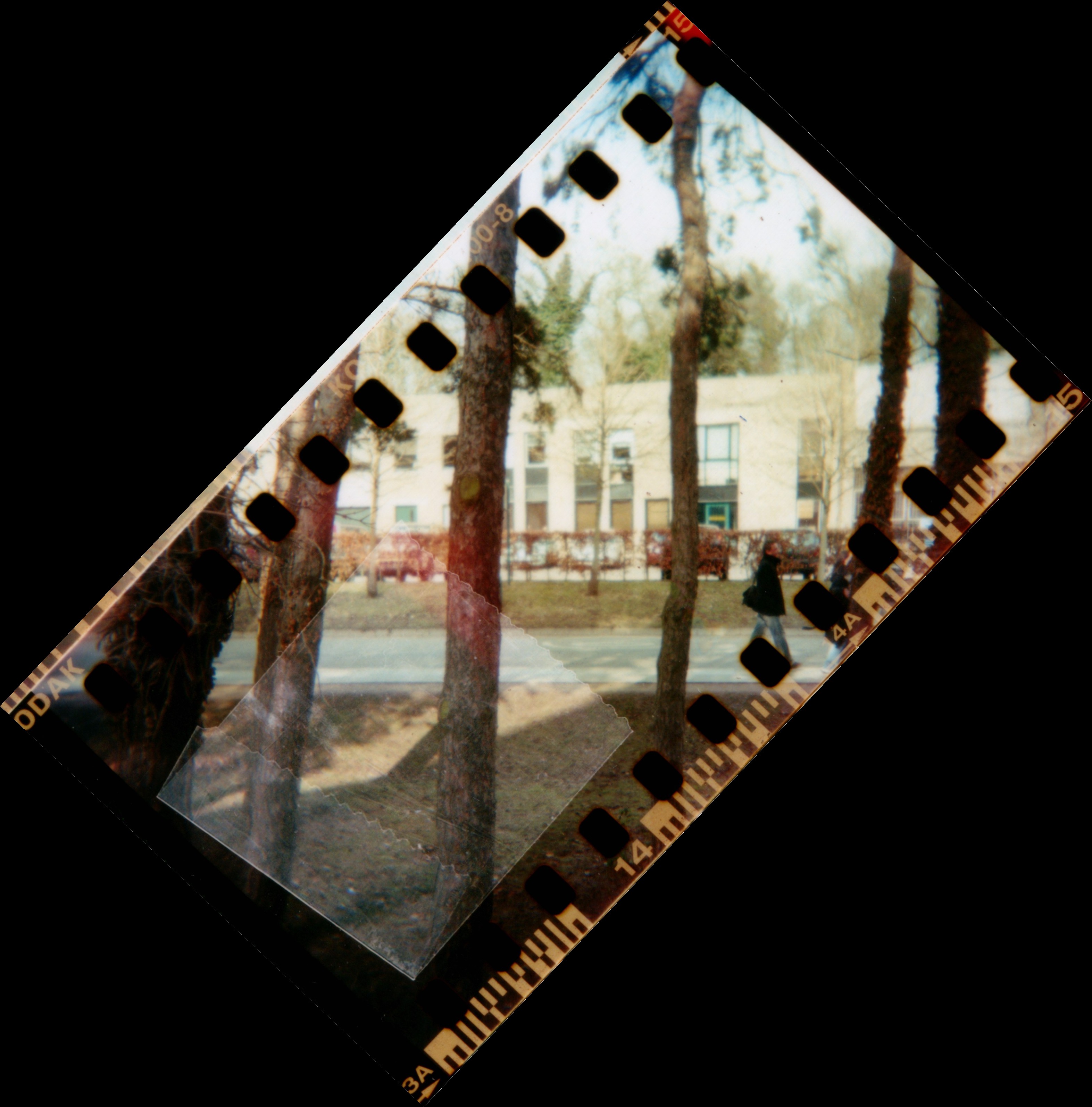

Here is a full sized image from flickr you can see the edge markings
Berri
Feb 7, 2017
627
Florence, Italy
that bar code is very similar to kodak gold 200, I don't have any ultramax 400 in hand so I can't say for sure, but I believe they would match
rpavich
rpavich
Aug 24, 2015
1,520
West virginia, USA
It certainly looks like it. Or Kodak Gold 400. The edge markings look the same to me.
Here is a sample from a flickr search for both. The 200 is the first image.
So if it is....then what does that mean? That I'm actually buying Kodak Gold?
