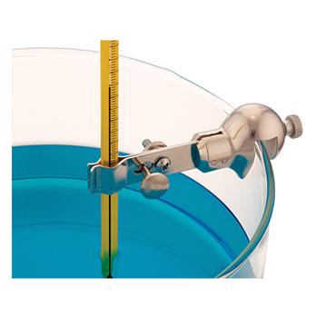

What kind of thermometer? Can we see a picture of it? Is it mercury? I think it is more common for a thermometer to read too high from a separated column so I wonder how it can be so far off.
Process and technique is very important. Almost every laboratory thermometer is calibrated for use at room temperatures. The immersion standard is 76mm, most dial and stem thermometers have an immersion line. One huge issue is taking time for the thermometer to stabilize. I've found that thermometers that do not agree in 1 minute, will when left to eqilibrate on a bench for several hours will come to nearly the same point.
I have a Kodak process thermometer and several glass lab thermometers, dial, tank you name it. I have found the (obvious) to be true. The smaller the range the easier it is to get an accurate reading. The lower the mass of the thermometer the faster it will come to a stable reading, i.e. a small Weston dial thermometer is easier to use than a great big dial thermometer. If you hold the stem in your warm hands you will effect the reading. Digital thermometers are not better.
I have a couple small 5-6 inch long Taylor thermometers. These were standard equipment with the old Kodak Rapid color processors. graduated from 70 to 110 F. These work great for measuring a small volume of liquid.
I just went through a episode of thermometer doubt. When in doubt use a high grade glass thermometer, with correct immersion, and if you really want it right, keep your hot hands off the stem.
Best Mike
3 inch (76mm) immersion, no warm hands, give it time.
