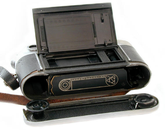

Here is an M4 that was used correctly. Eventually the film wore an image into the pressure plate.

How could that be possible unless the film was left for ages with a film in the camera?
Moisture would help, too. But the camera has obviously seen a factory's worth of film - it's brassed inside from film being pushed in.

Thanks😉. But still it really puzzles me. The guide rail streaks I might understand, because of the friction of moving film; but the perforation marks would need the film to be stationary. I shalln’t sleep now.

Stephen Gandy says that the sprocket hole images in that M4 are actually worn into a pressure plate
Well, Garry Winogrand is understood to have, during his 56 short years, exposed more than a million frames of 35mm film through his cameras.
When he died, he left approximately 6500 (although some say 2500) 36 exposure films exposed but not yet developed.
So if any photographer's camera were to exhibit this, his would be a likely candidate.
You know it's physically impossible to leave sprocket indentation in the pressure plate. Doesn't matter how often you use it. The pressure on the plate is constant, not strong enough to push film into it. Perhaps you could get a small amount of wear on the edge of the plate which would probably scratch the film. Sprocket marks are caused by film sitting in the camera.
But hey I love a good fairy tale, never shortage of them here.
that's a great story
It is. The most film sprocket holes could do is wear a stripe into the pressure plate, since the edges of the holes could be a little abrasive. You wouldn't see rectangles in that instance - just a line. But that would be pretty much impossible - the greatest points of pressure are where the plate presses the film against the rails (between the sprocket holes and the shutter curtain). The rectangles are from the film sitting in the camera - probably getting a bit moldy.
