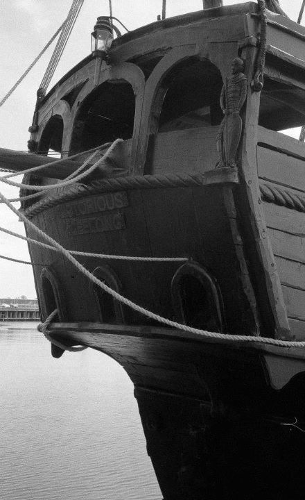

Well here's a snap of the 15th century Portuguese Caravel replica a guy made in his back yard, moored in Geelong a few weeks ago, from a roll of HP5+ I bought minutes earlier from an astonishingly well stocked (with Ilford materials) local photo store (Camera House Geelong). In good light, with ISO400 film - zone focusing is kind of easy, and even the cheaper tessar lens is so sharp...
Marc!

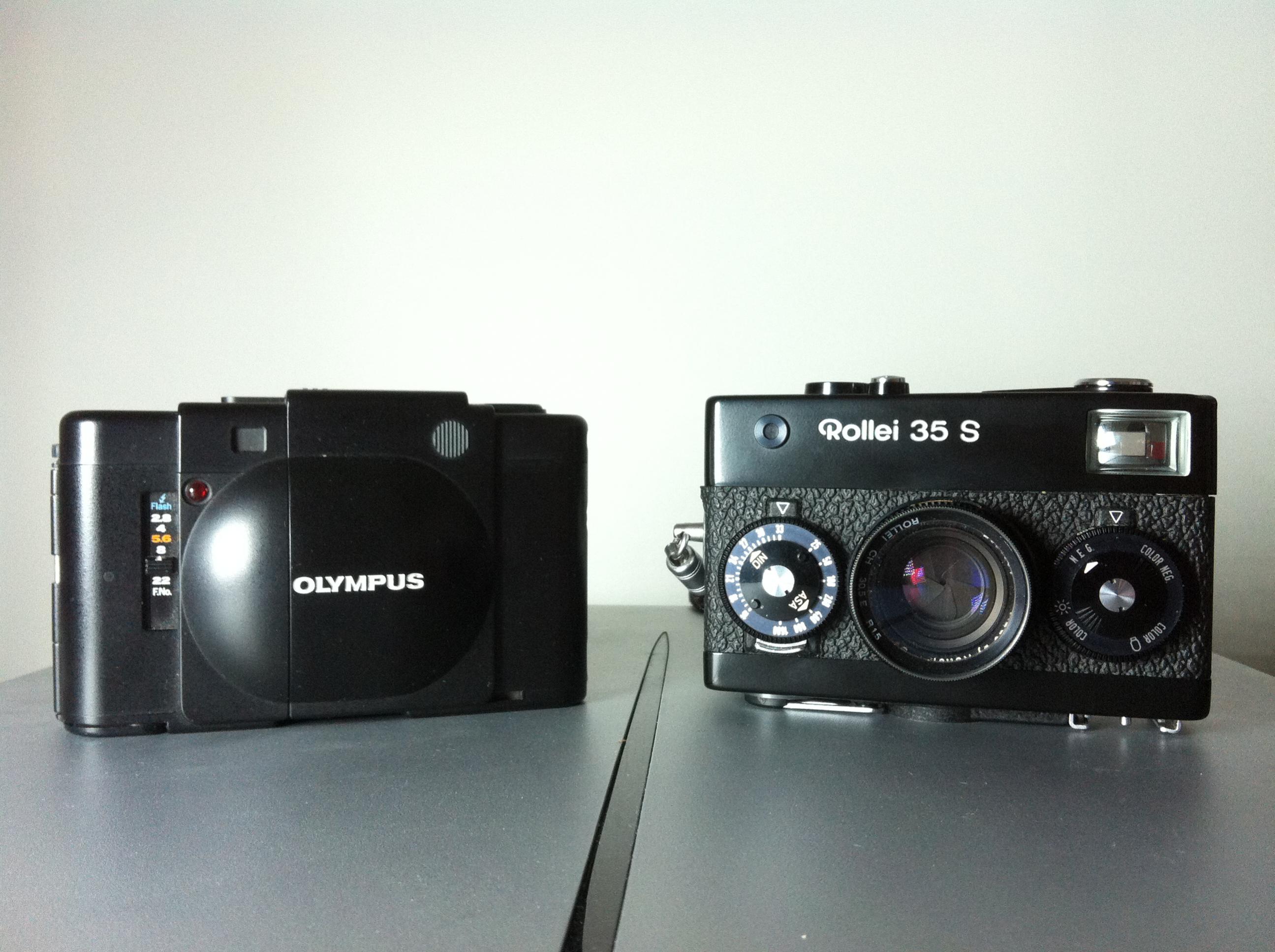

Turns out there is not much difference size-wise. They weigh about the same, and the Rollei is a smidge taller, and its lens sticks out perhaps a millimetre or two more in the folded position... What you lose in rangefinder 'certainty' you gain in manual control and a flash hotshoe, albeit on the bottom...
Marc!
Marc!

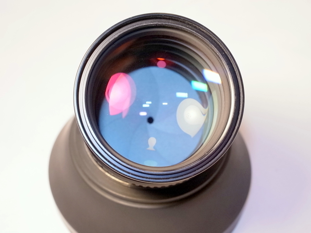

Very interesting. Looks like you get a real iris too :tongue:
Marc!

Pretty Cool. Can you get those Rollei's for $10-$30 like the XA?
The prices vary wildly - whereupon the early German ones are wildly expensive, and the Singapore ones not so much. I paid about CHF100 for mine, which is on the expensive side - but in my defence, I was on holidays, and it was a really nice camera shop...
Marc!
