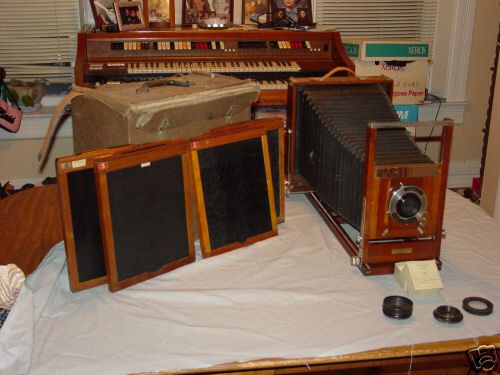

So, I bought (won auction) on the 8x10 Korona and it has a lens on it that I know nothing about. The shutter says Wollensak Optical, and REGIO. The optics say nothing on them except on the inside of the front and rear of each set (there are 2) it has roman numerial III and a 4 or 5. The f/stop scale is marked with scale for 4 or 5. Since I do not won a digital camera have attached the photo from the auction just to give an idea of what the lens looks like.
Anyone, Jim G, have any idea what the lens is and what focal length it is?
The extra lens came in a small box that says Engravers Glass Bausch & Lomb Optical, but I don't think it is original to the lens. All in all a nice kit, will need to add a couple of film holders (the wood ones look pretty...but) and probably add a newer lens. However the shutter speeds, 1,1/2,1/5,,1/25,1/50 and 1/100 plus B and T sound pretty much on the money.
TIA for any help ...

Wow! What a pretty old camera. Congratulations! Nope, I don't have a clue. You'll have to experiment and see where some of the different combinations focus on infinity. Looks like great fun to me.

Yeah, it is a really nice old camera..looks like it spent a better part of it's life in that beat up old case..but that's OK with me, because it works and looks just fine. Will try to give the sweet old thing a workout this weekend. No idea how to even measure anything, but have already replaced the 4 set of lens with the 5 (the 5 had almost no dust) and it is really quite clear and crisp. If I can just find a 8x10 holder here in town...the ones that came with it are all quite loose and in need of some repair.
Though one has original divider that has Poco Cameras, May 10, 1898..and looks every bit as nice as the day it was sold. I love old camera equipment...wish it could talk to me...tell me stories about what it has seen and done.

Brad, I was actually surprised at how nice a shape the camera itself is in. Need to add a spring to hold the GG in place, but all of the movements are very, smooth and the shutter is in much better shape than I thought it would be.

An update on the lens..set up a shot this weekend and used the mystery lens for one shot (the lens with III.5) and the Rodenstock Geronar 210. Both lens were set to f/64 and 1 sec. The negatives look good other than the terrible scratches from a Cibachrome tank seemed like a good idea at the time...
So in spite of the scratches, the main purpose was 1. to see if I could verify the focal length - the two images are almost identical in coverage, so I am guessing the lens is a 71/2-8 inch and 2. to see if the old lens could make a decent image - it can, the other attempt with this lens flare just ate the image up...note to self avoid flare with this lens (this time I managed to shade the lens by using my boyish figure to shade the lens :D - ok you guys that have met me can get off of the floor now, it's not that BIG a stretch....he!he!)
Conclusion?(s) - well had originally thought that I would pass on the lens and let someone else find a use for it....but now, think I will keep working with it. Big surprise was the 210 Geronar actually covered 8x10 (and with about 11/2 inch of front rise before running out of room). So, the lens is still a mystery, but seems to belong with the camera...now to try the one marked III.4 and see what the coverage is like with it.
