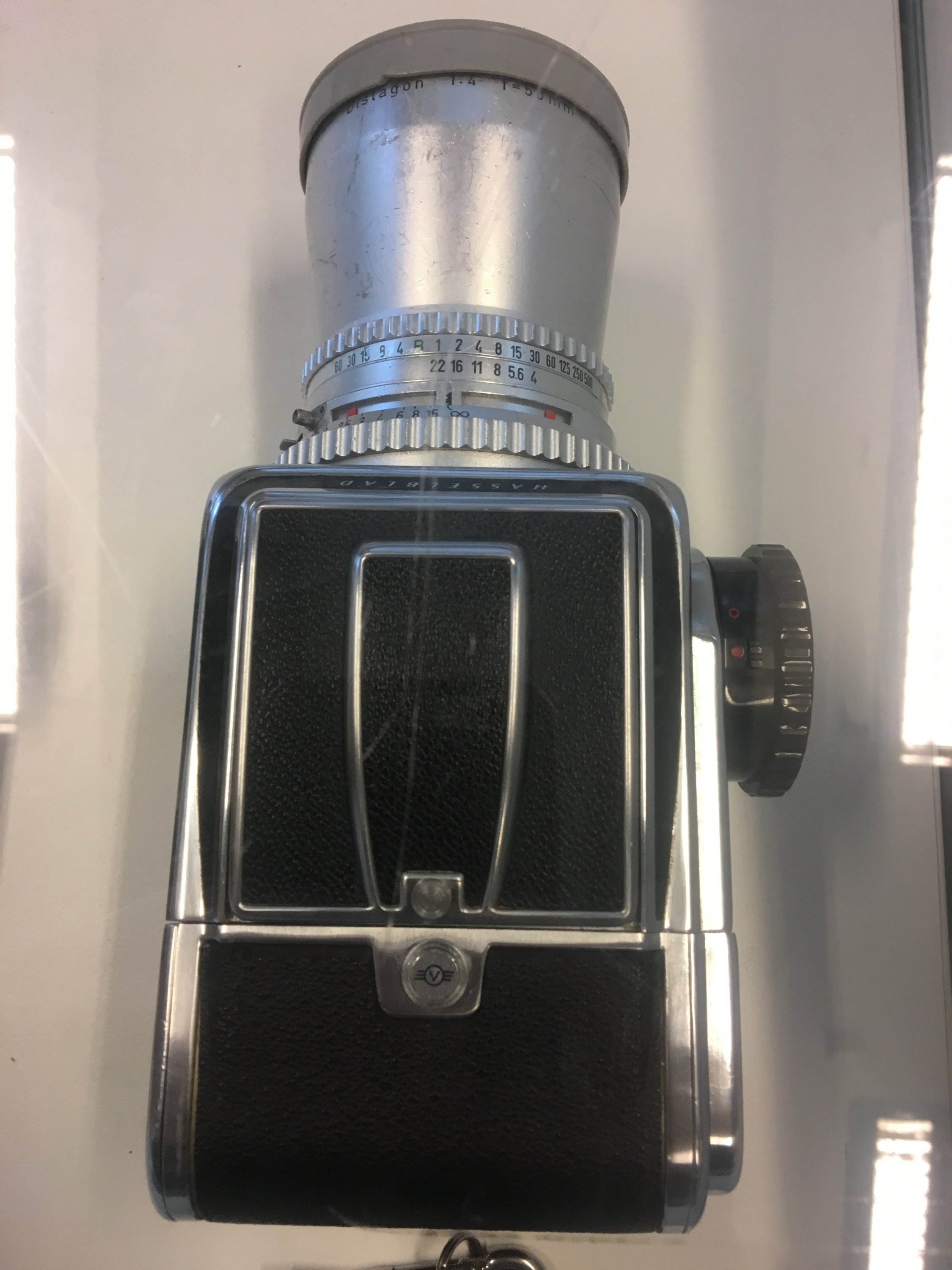

Hi all,
I was a bit too hasty during auction. I felt in love with the hasselblad viewfinder and was a bit eager to make it mine. After i bought it and notice this lens hasn't got a shutter speed ring.
So my questions:
  • which Carl zeiss lens do i own
  • how to best use it
  • any other tips on a 500c with this lens

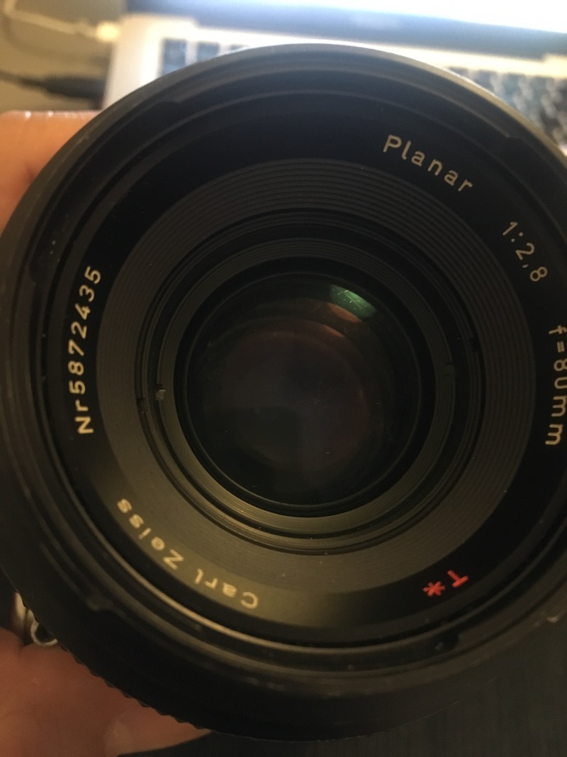

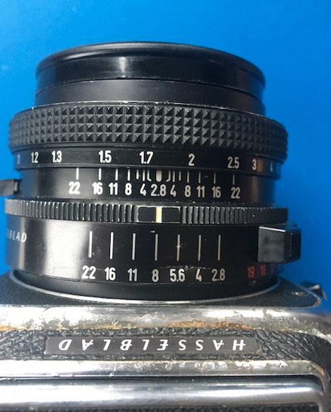

It's an F lens. F lenses are designed for the 2000 and 200 series Hasselblads which have focal plane shutters. You can't use an F lens on a 500 series body.
Sorry, but you'll have to buy a C series lens for your 500 series body. The oldest are plain C lenses, then CF, then minor changes with CB, etc.
In particular:
F lenses are for 2000, 200 series bodies only. The shutter speed is selected on the camera body.
C series lenses are for 500 series bodies; the shutter speed is selected on the lens. C series lenses can also be used on 2000, 200 series bodies in two ways: 1. You can choose a shutter speed on the lens and set the camera body's shutter selector to C. Or, 2. You can set the shutter speed on the camera body and set B or F on the lens. The body's shutter offers higher shutter speeds; the lens' shutter offers flash sync at all speeds.
The one exception is the 202FA: with that camera either use an F series lens or a CF lens set on F. The reason is that the 202FA always uses the focal plane shutter. Other 200 series bodies have a C selection that effectively opens the focal plane shutter during exposure and lets the C/CF lens shutter make the exposure.

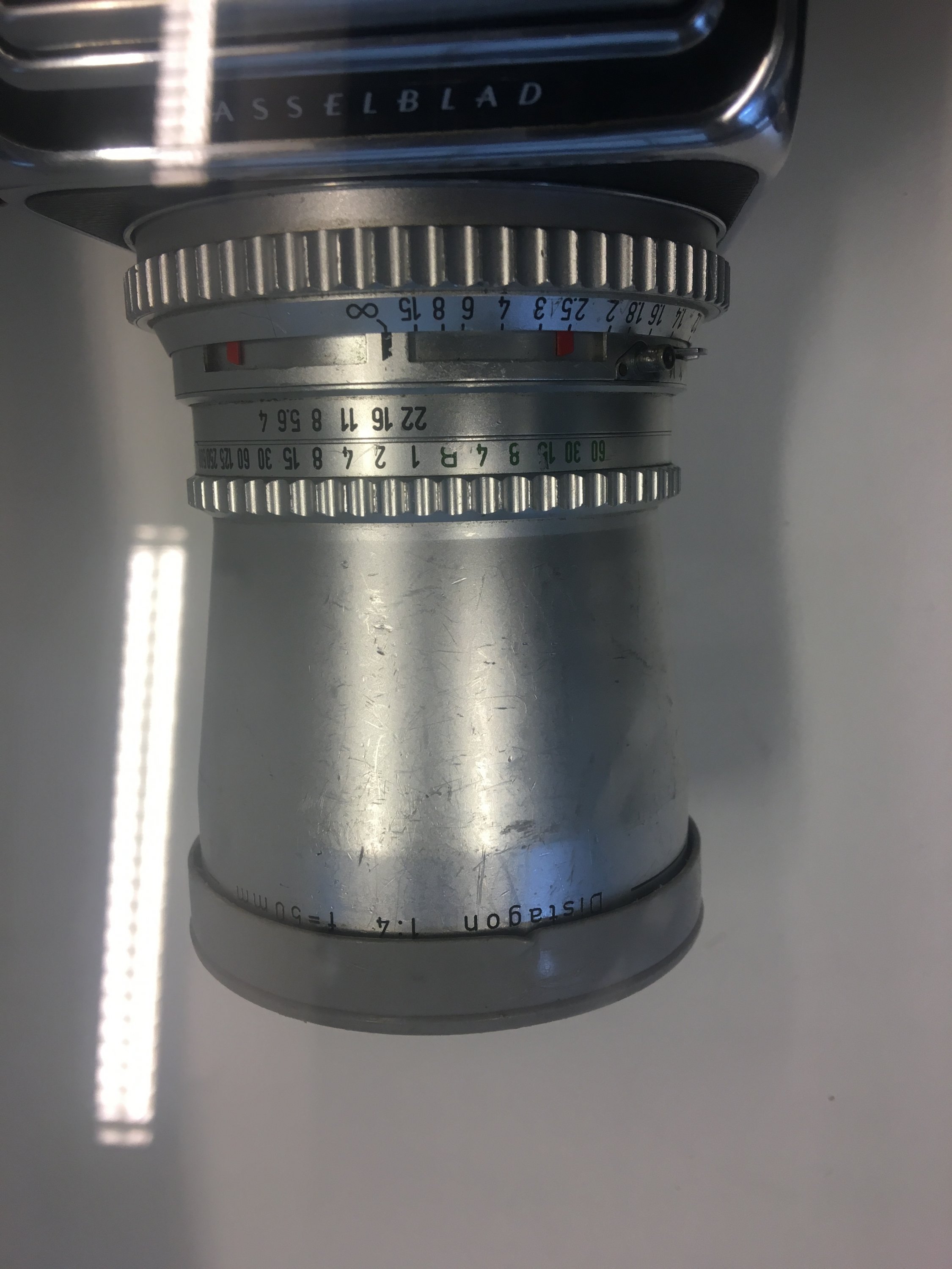

Now I need to crawl ebait and look for a C lens. Any suggestions for lenses (portraits/street (like to talk to people) and a little landscape)?
Can anyone identify this lens:
and does it come in black as well?

Yeah, so the chrome lens in the photo is an old C lens. That's what they should've given you (note that C lenses can be chrome or black).
But your lens, unfortunately, is an 80/2.8 F lens - an old one. If it were f/2 it would be worth more. C lenses aren't wider than f/2.8, so one advantage of F lenses was usually the chance to get one having f/2 .
I doubt you could trade your 80/2.8 F lens straight across for an 80/2.8 C. One reason is that the C lens is more complex: it has a shutter and self timer built into it.
Can you return the item or get a partial refund? That F lens should never have been on your camera; it simply can't be used with that body.

There are a number of people using the 200/2000 Hasselblad using F and FE lenses, but far fewer than the 500 series, so it'll take longer to sell. Technically you can take pictures with it, the Barn Doors works fine for exposure longer than 1 sec. That is an early F80mm, probably sells for ~1/2 what a similar CF sells for (although a mint one sold recently for the same price as a CF on that auction site, so their rarity may be raising the value).
Can anyone identify this lens: <picture snipped...> and does it come in black as well?
That is a C lens, and it came in black anodize as well.
In the Hasselblad world, C = Central Shutter (ie; Lens shutter) and F = Focal plane shutter.
C lenses worked with the 500 series cameras
F lenses worked with the 200/2000 series cameras
CF lenses worked on both.
In addition, CFi were "imrpoved" CF lenses (less flare) and CFE lenses had Electronic bus contacts.
The main advantage of the F lenses were closer focusing, and soma had a faster aperture.

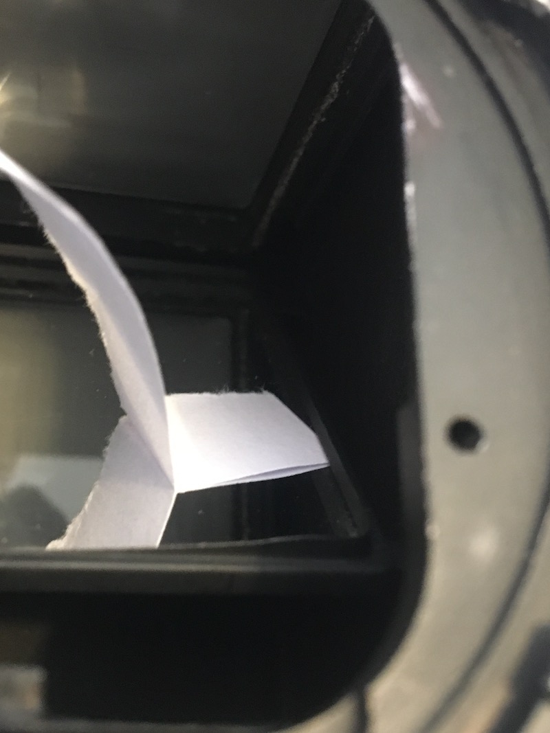

If you can slip the corner of a piece of paper between the mirror and its metal frame along the bottom and sides, focus may be off a little, or a bit more. If you can slip a matchbook cover uder there, then the pads are certainly bad and focus will be off a good deal. You will still be able to use the camera 15 feet and beyond OK if you stop down to f/8 or more. At 5 feet and less, focus accuracy will be rather poor, especially at the lower stops. You can get by like this and use the camera till it eventually jams, which it will.
aca
Jul 13, 2016
72
Amsterdam
Is this what you mean (see photo)? I am able to slide 1 paper but not 2 stacked paper corners

The pads are deteriorated, as it can only be, being foam rubber. but that's better than I would have thought. The final test would be to go ahead and find an old chrome 80mm lens for it. Set the lens at exactly 3 feet and set up some small objects like film cans or whatever-- a yardstick maybe--anything where you can focus on the film can that is EXACTLY 3 feet away from the joint where the film holder joins the back. Having done that, check the image on the screen and the image on the film. If all 3 agree, you're set. Remember, unless the focus ring has been tampered with in the past, the scales on these lenses are perfectly accurate.Be precise when you set up your picture, as even 1/4 inch at 3 feet, wide open CAN be discerned under a loop.
