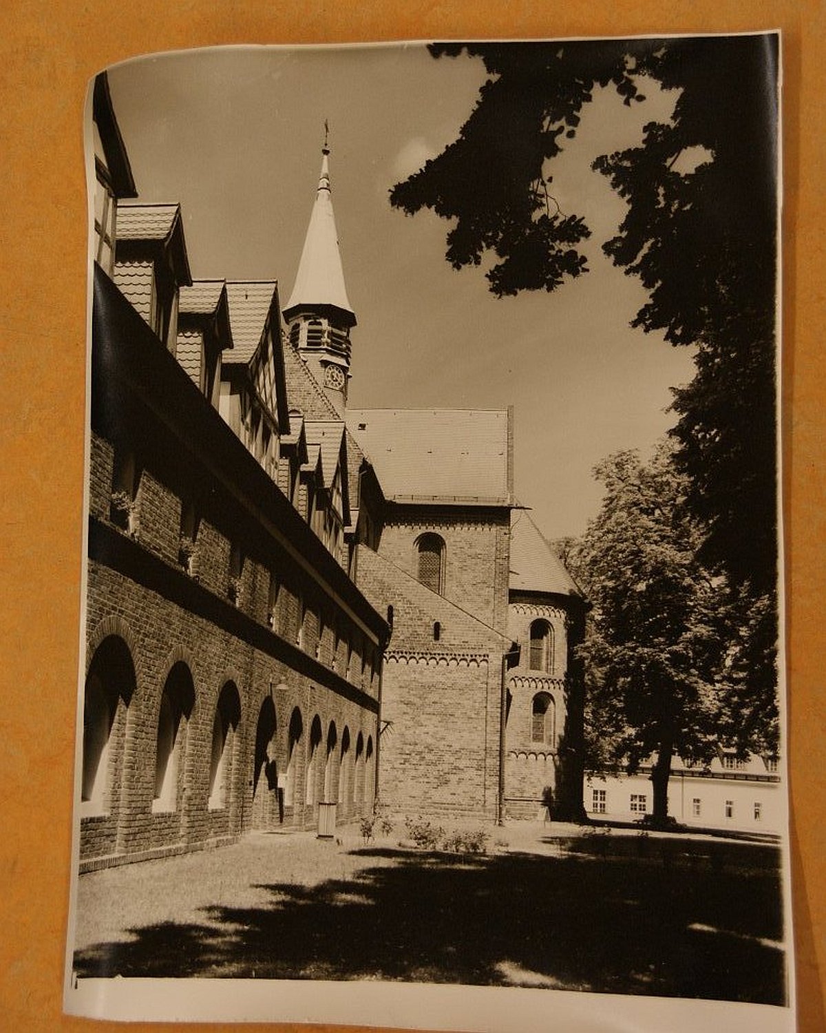

The scene has been summerlike, hot and nearly cloudless sky, recorded at highnoon, here printed on old Fomatone Baryta:

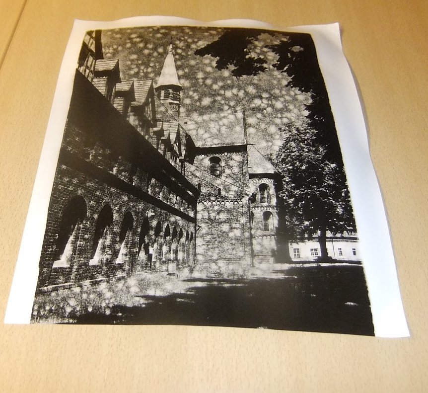

Now the somehow rotten Fomabrom.
Development in the Lith bath became weird soon:
Lights came out first but as a muddy grey mass.
Shadows tried to appear but this seemed to be a hard job.
After a while and having the print seen delicate and nearly printed to the end the snowballs began to rise up to their best appearance:
I have been curious what would happen under other conditions like less/more light, more fat Lith developer - the same.
I didn't found things working better.

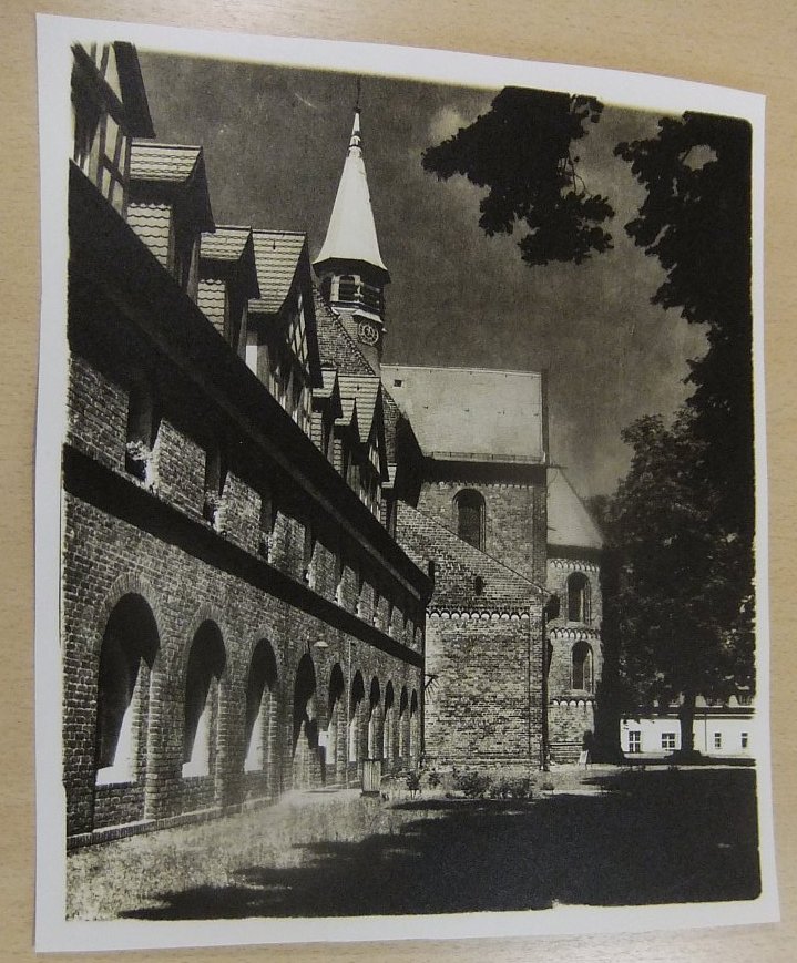

I had the idea of printing way darker and then bleaching back the lights with Farmer's reducer.
With increasing darkness the snowballs now changed to marble structures, the bleached print at least came out somehow artistic:
