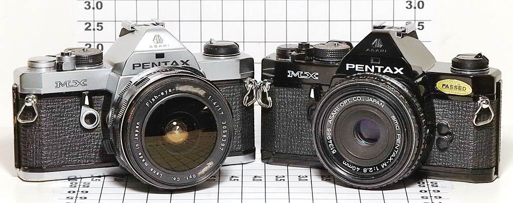

The MX itself weighs 499g without the lens so this combo is well past your weight consideration but I doubt there is an equivalent or smaller full fisheye combination smaller . . .
MX_MX lenses by Les DMess, on Flickr
Compared to the Olympus Pen FT that weighs 476g but only produces s half frame of 35mm, the MX is very similarly sized and offers a much much larger and brighter viewfinder . . .

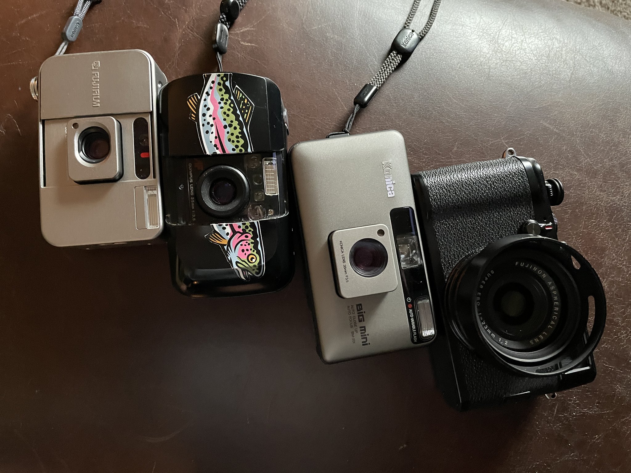

A few of my smaller 35mm cameras with the limited edition x100. The Fujifilm Mini Tiara is 28mm.
