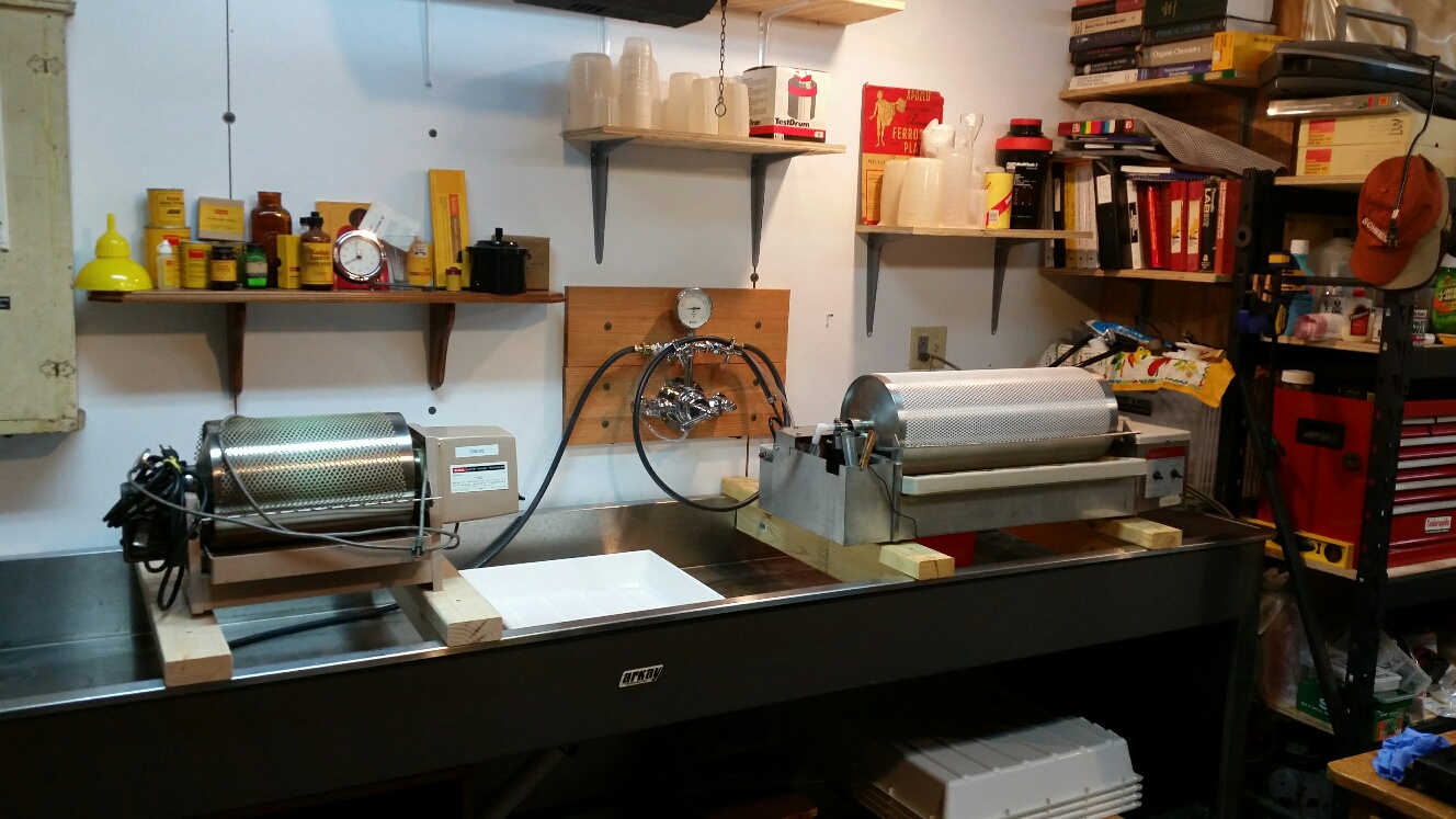

I am making 8x10s from 6x9 negs 3.8s @ f11 40Y 10M. 16 x 20 10s f11 similar filtration .Fuji Crystal Archive paper. RA 4 is fun! 1965 in the dark Kodak rapid color processors :smile:
People say I'm crazy, I say so what!
