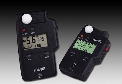

While my Gossen meter has a slide-able dome, it is located on the “top” of the meter, whereas the Polaris (and others like it) have the dome on the front.
this was one thing I didn’t like about the Gossen. But I don’t think it would be a large impediment. I’m not shooting indoors or in any artificial lighting. So the light source is usually up (the sun.) With my Sekonic, I hold it horizontal when metering and turn it up 45 degrees to view the screen. It’s probably slightly less ergonomic to hold it vertically to take the reading, but maybe not...
also thanks for the mention of the Polaris. I haven’t heard of them, I’ll have to look them up.

View attachment 239134[...] While my Gossen meter has a slide-able dome, it is located on the “top” of the meter, whereas the Polaris (and others like it) have the dome on the front. The means that when you are facing your subject, you can meter by holding the Polaris up in front of you and meter the light that’s coming from behind you, hitting your back, your meter, and your subject. With a Gossen, you’d have to turn around to face the light source, meter (which may include having to then center a needle or adjust to illuminate a central LED), then turn again to face the subject. [...]
I agree, the "front" facing sensor of the Polaris and many Sekonic meters is more ergonomic for incident readings than the "top" sensor position of Gossen's better analog meters.
However, I have found that it is not necessary to turn around and face the light to get an incident reading with my Gossen Luna-Lux SBC. Instead, I hold the meter out towards the subject, but with the incident dome facing back towards me. I can push the red metering button while holding the meter with one hand. At this point, I cannot see the face of the meter to dial in the reading - but no matter. The meter remembers the reading for about 30 seconds. Pressing the green button recalls the reading from memory, and now I can turn the dial to get the reading while still facing the subject.
The Gossen approach , having the light sensing element straight out the ned has always seemed like a better design to me.
I've always thought that the angled incident meters, like Sekonic and Minolta, run into the difficulty because while taking an incident reading, the photographer's body is quite naturally between the meter and the light source. With the Gossen, the photographer can stand behind the model (for example), hold the light meter next to the model's ear, pointing it back at the main light and take a reading without needing to jokey his own body out of the way...seem so much more natural to me.
