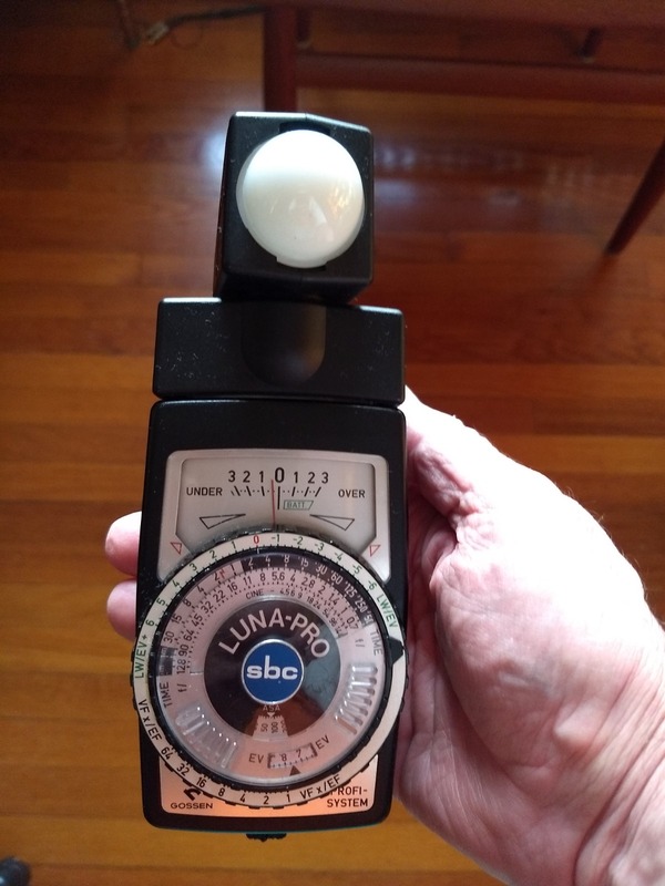

5C160E7A-6521-4189-B738-9DC8602059DB.jpeg I have a couple of incident metes, but usually reach for my Polaris SPD100 — see attached photo, it’s the one on the left (the other is a revised model with on-demand luminescence). While my Gossen meter has a slide-able dome, it is located on the “top” of the meter, whereas the Polaris (and others like it) have the dome on the front. The means that when you are facing your subject, you can meter by holding the Polaris up in front of you and meter the light that’s coming from behind you, hitting your back, your meter, and your subject. With a Gossen, you’d have to turn around to face the light source, meter (which may include having to then center a needle or adjust to illuminate a central LED), then turn again to face the subject. I find the ergonomics of the Polaris preferable. There is also a reflected attachment available; I have one but never use it. It may be that these Polaris meters are no longer made new, but they’re available on the used market. I’ve used one for years, with satisfactory results.
Kodachromeguy
Nov 3, 2016
2,019
Olympia, Washington
You wrote you wanted a small meter. How about going the opposite direction, a behemoth so large, it will fill one of the compartments of your camera bag? This is the Luna Pro SBC with the Luna Sphere attachment. I can't tell if the Luna Sphere provides better readings than the built-in small sphere. This is my most sensitive meter for low light. But most of the time, I use a much more compact Luna Pro Digital, which may be 20 years old.
