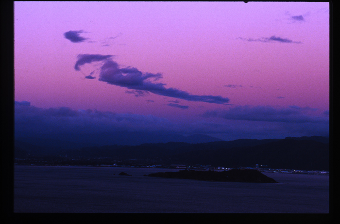

I scan at 2400 dpi with 48bit color TIF format with the Epson. I take off unsharp mask, and I alter the histogram so the highlights and shadows are not clipped. Then in Lightroom I add some contrast, reduce the highlights, more shadows, less blacks, more whites, some vibrance, saturation, a bit of the curves and sharpening to 120 ish and noise reduction 15.
A picture is attached here. The grain shows up, the scan doesn't look as good as the original slide. The tones are a bit more squashed. Not as vibrant or slick as the original slide. I appreciate b/w film and maybe C41 a bit more.

What is the slide? Perhaps the scene may have something to do with your results?

Kodak E100G. Do slide film record less shadow detail than a digital camera? I do most of my photography in low light, love the saturation.
Yes. Well to be fair, slide film has less range in general, exposure placement determines what tones get ‘clipped’ but most any modern digital camera can record a wider tonal range from the scene than slide film.
I believe what you are liking is the slide’s contrast range. Roughly 5 stops from the scene total from Velvia, 6 stops Provia, 7 stops Astia, is about it. E100 maybe 5-6 stops best guess.
And profiling, colourimetrics? Where is that? Not that it is likely to make a difference after all that wizardry.
Really, don't do any of that stuff. Get the exposure spot-on in-camera, don't rely on it being anywhere near good in post workflow.
In-camera exposure isn't difficult, but it is a skill and requires work. You need to pick up on this as you are relying too much on a computer to fill-in the blanks that you should be covering at the time of the exposure. Why vibrance and saturation?
Desktop scanners will always have difficulty matching the slide.
Yes.
Mar 3, 2011
1,507
Maine!
Nothing will be as good as looking at the original tranny on the light table. Set that experience aside. If it's a well exposed chrome you should be able to do a decent reproduction, but it will require a high DMAX scanner. Epsons are no idea for smaller formats, and definitely not for slide film. If you can use that Coolscan that's the minimum of what I would use frankly.
Digital cameras will always appear to record more detail because no grain is present. Though often a slide does actually resolve the same amount, if slightly obscured by grain. It takes a very good scanner to see the detail present in a 35mm slide, no flatbed will get there.

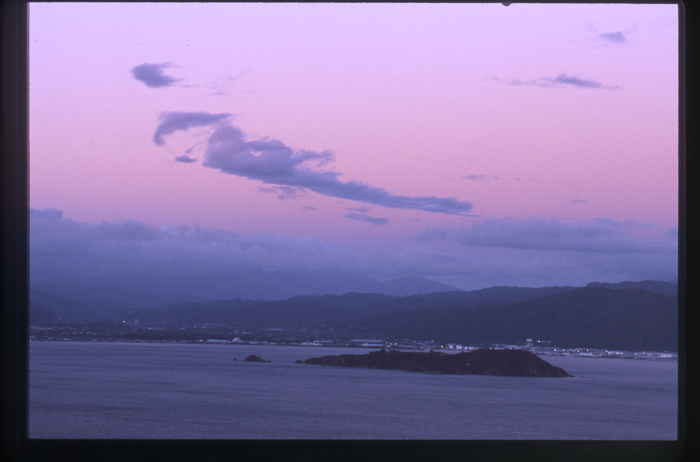

The scan looks flat straight out of the scanner. The slide looks better. Yes, maybe it is the desktop scanner, tonight will do a slide show with the free Kodak carousel given to me from the camera club .... And it's not like for a hobbyist one can get so much pro scans.
Cheers for that. Appreciated, just saw your post come up after I posted before. I bought the Coolscan from a pro but it is now no longer working, I have some medium format slides to scan and my Betterholder is arriving soon (for my Epson) but again I don't imagine it would be that it would be much better but the sharpness and the ease of use might be a bit.

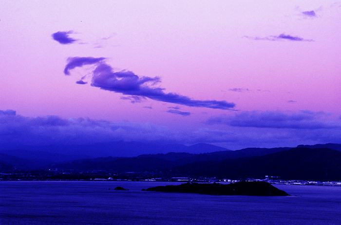

This closer?
Edit done in LR, scrubby slider, middle tone, drug it straight down.

Mark - cheers for the editing. Not quite as vivid as that, it was more shadow detail and I guess it was backlighted so had that metallic chrome look to it.
Interestingly I just did a quick show with the projector that looked a bit more tame, a bit different to the lightbox. In somewhat it made Velvia a bit less saturated to what the lightbox showed.
Will continue to play around ....
So Ray, what you found is normal. It is also normal for paper prints. Change the setting the final image is seen in and look of the photo changes. The only lighting that counts for final editing is the lighting where the photo is finally displayed.
For example to get a bit more vivid image when projecting (more like the light box) you could:
1- reduce the light output of the projector or,
2- underexpose a bit in the camera.
If projection is your target usage, the projection should be how you proof. If digital, in a room with normal lighting... If paper, in the living room under it’s normal lighting... Every change of venue changes the look.
It follows that given the scanner has yet a different light source, it requires it’s own edit.

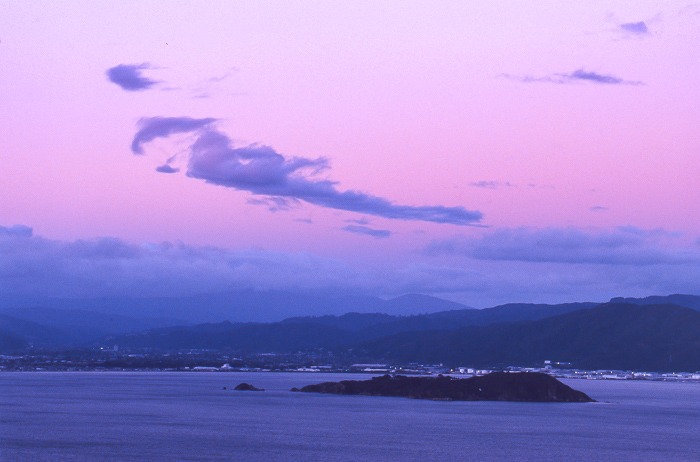

Couldn't but help not getting into an attempt at a small improvement only levels & gradation tweaks. Mod-2.jpg

Can you show the original scan please, and start from there.
I think the baseline problem is camera exposure and reciprocity, additional to only moderate saturation for that film (meaning, is it the right film for the task?), but moderate saturation might just be all you really need. How are we to know? The grain/noise appears to be interfering with detail — E100G is not this grainy, so there is noise coming from somewhere. Uncommon as it is, sometimes re-rating the film to ease off on saturation is done (e.g. EI80). But in Ray's case, there is no reference starting point image to make an informed judgement, just a very heavily modified copy. For all intents and purposes, the original may have been colourimetrically correct (I have only seen E100GX slides, not the *G designation).

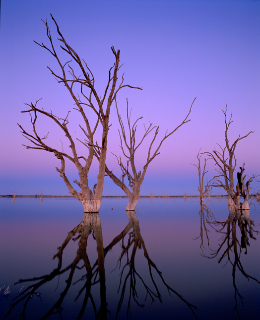

The image below is straight from an RVP50 6x7 transparency (multispot metered), profiled to AdobeRGB+, USM +5% (covers scan-step loss) and straight to print (RA-4) — this and another (landscape) scene sold for $1,480.
____________________________________________________________
Sample — Earth's Shadow (blue) and Belt of Venus (pink):
20 minutes after sunset (sun down below western horizon, this is view east);
RVP50 w/ additional 6s reciprocity correction at exposure.
It is very possible to achieve this with any film (including E100G, even a pinhole camera) — but the more control you have over the camera and film.

Original scan.
The image is copyrighted © Raymond Cho (the author of this thread).
The profile on landing has defaulted to AdobeRGB1998 (no attendant profile found).
The palette looks natural on examination, although the lower bank of clouds has interfered with the line of blue that normally would be observed. This is a minor quibble which in no way really distracts from the image impact.
Three somewhat muggy tones are visible in the hills: the distant range, the middle and foreground hills, and all are a little low in contrast direct off scan (note that sea mist can also cause this low, muggy contrast). A very small localised fix in hill contrast is warranted. Also levelling of the horizon.
No alteration is warranted to any part of the sky.
The image looks well exposed from a basic standpoint, with reasonable detail visible where it is expected in this specific (rapidly falling) lighting.
At print step, a small amount of brightness of the image will likely be lost; if you are having the image commercially printed at a lab, discuss this with lab staff.
