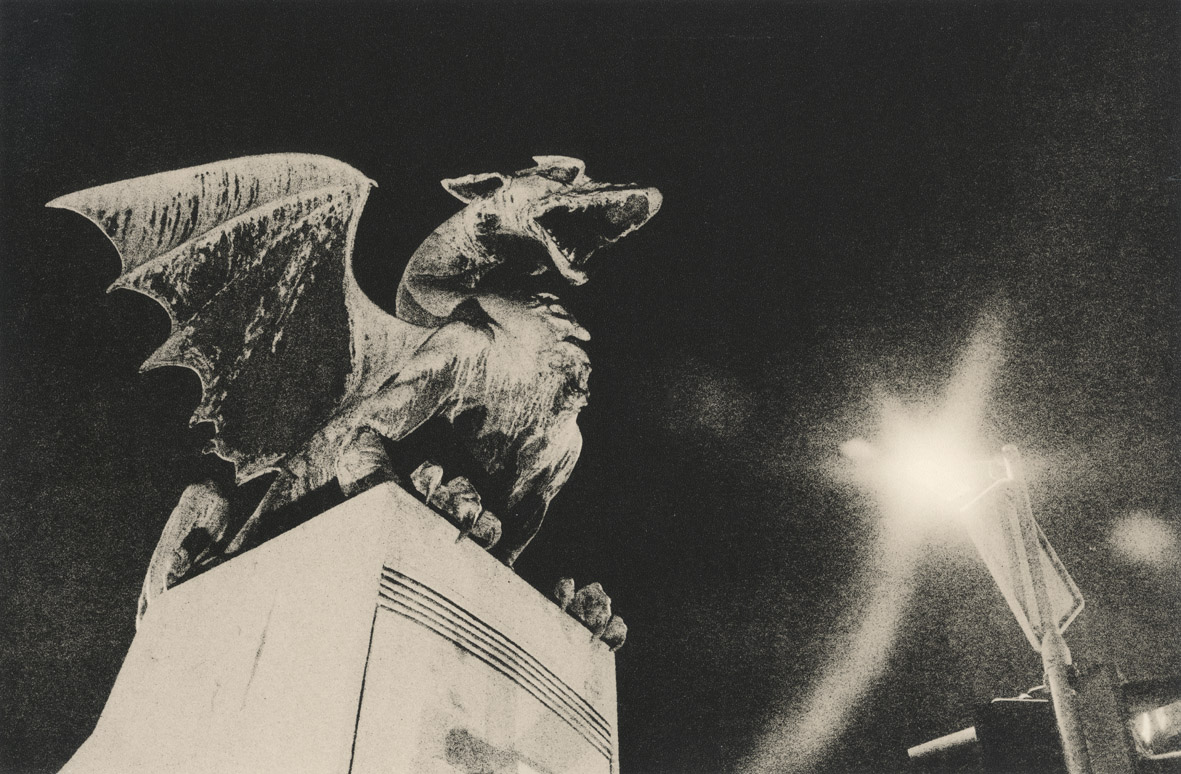

I'm a little bit puzzled about this, as all my prints on this paper have basically no base tint whatsoever. I can't see any difference between them and Ilford Warmtone paper. The base definitely has a strong tint when it comes out of the box.
I've got a batch of TF2 fixer mixed up so maybe I'll try that with this paper. The base bleached really quickly in Ilford Rapid Fixer with my tests last night. I'm wondering if an alkaline fixer will make a difference.
532's not far off MGWT 24k, but the 13x series are definitively warmer - & I'm using Hypam. Only thing I can think of is developer doing something to the base tint, but even that's unlikely.
Either way, definitely one of my favourite emulsions - nothing quite like Fomatone for amazing flexibility in exposure & process.

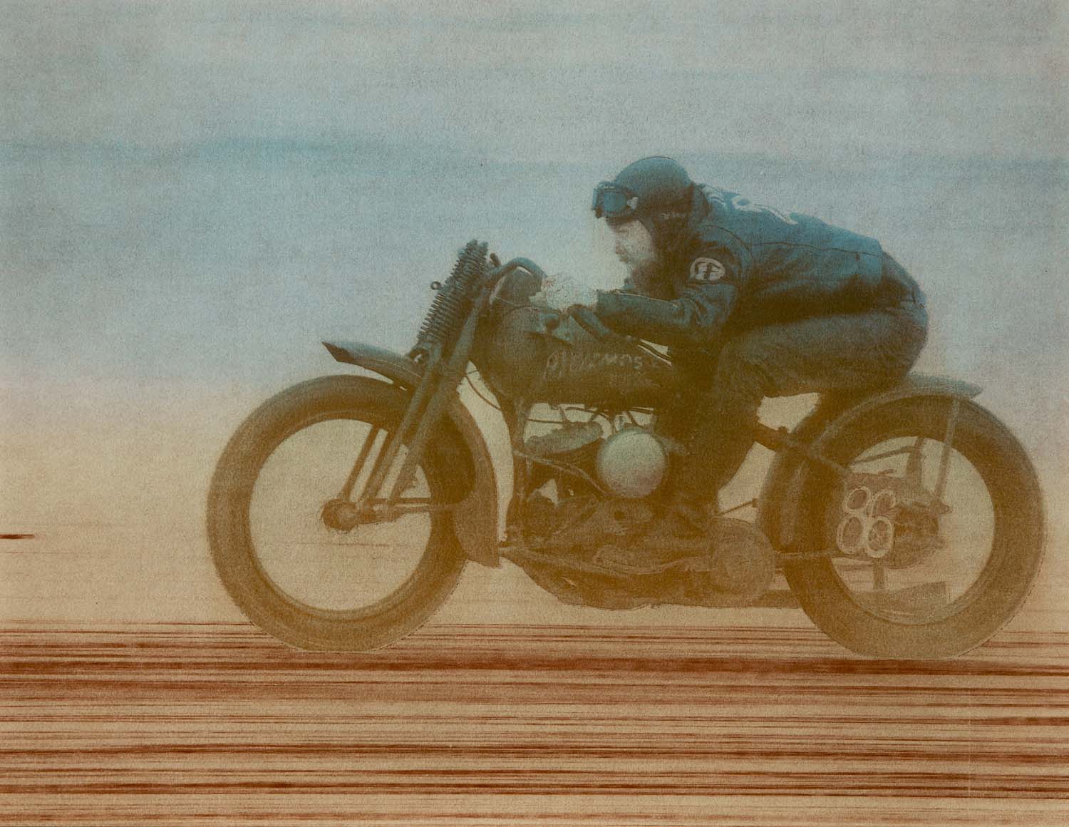

Hi Bob
Have you tried Fomabrom Variant 123? Does give a good lith result and has a soft textured base with a slight sheen. Bit like the old Agfa MCC Semi Matte surface.
I thought it was discontinued, but I think there are large quantities still about. Was prone to base fogging so not so great for conventional printing, but no such problems with lith. Do you know Martin Reed who used to own Silverprint? He's th UK importer for Foma. As Lachlan said, there is talk about producing it again but marketed as a lith paper. Contrasty example attached.View attachment 180783
Some important 123 info - yes, it was discontinued about 2 years back. But before it was discontinued, it was reformulated (the gelatine for all Foma papers changed). And one of the few currntly lithable papers in existence suddenly lithed terribly (it was also a great Bromoil paper and I can attest that the new formulation was very weak for Bromoil use). So buying old stock, you'll have to research some of Dr. Rudman's newletters, or ask on the FB lith group as to batch numbers.
Foma has re-introduced 123 this spring as a "Lith and Bromoil Paper", as sort of a test run. It's available in 8x10, supposedly we'll get 11x14 any day, and 16x20 this summer. If it sells well, they may continue production, they may do it as a seasonal offer... Freestyle wasn't sure.
Hopefully it will survive and in larger sizes. It was a flexible lith paper that didn't have extreme tonality but liths much better than Slavich (the "broken xerox machine" paper) and kept me from buying exorbitantly priced Ektalure in eBay crap shoots!
