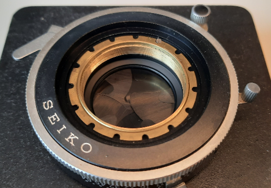

Unfortunately, this is not 100% true. There is a Seiko shutter that looks like a Copal #1 - same body size, but the Seiko has a different mounting thread and lens cell threads, slightly larger. I have a Fujinon 210/5.6 that uses one of these shutters. It requires a M46x0.75mm retaining ring vs the usual Copal M39x0.75mm. If you don't have an M46x0.75 retaining ring, customphototools lists it, or you can use something like a 49->46mm filter step-down ring.
Here is a comparison of the Seiko nearly-#1 vs a Copal #1 dimensions (Seiko numbers measured by me):
(Fuji)Seiko Copal #1
front thread M42-0.75 M40-0.75
back thread M42-0.75 M36-0.75
thickness ~21.8 mm 20 mm
front to shutter ~12.2 mm 10.75 mm
mount thread M46-0.75 M39-0.75
lensboard hole ~48 mm 41.6 mm
iris diam 30 mm 30 mm
body diameter 73 mm 73 mm
Reformatted into a table for readability:
dimension (Fuji)Seiko Copal #1
front cell thread M42-0.75 M40-0.75
back cell thread M42-0.75 M36-0.75
front surface to shutter blade ~12.2 mm 10.75 mm
My seiko #1 wasn’t made with a retaining ring at all. It has its original mounting flange which is designed with 3 countersunk holes drilled 120° apart for mounting screws.
It works okay if you use it as a retaining ring but it’s got no slots for tightening or loosening it with a spanner so it can be a pain to get it back apart if you tighten it too much.
