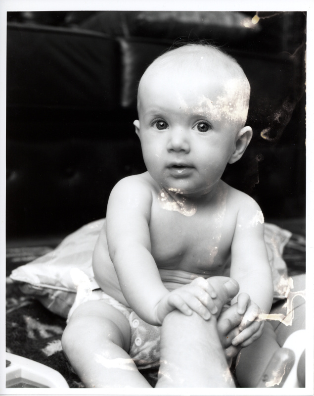

I'd had problems with a couple of Foma RC prints (there was a url link here which no longer exists) when framed, and Sistan was recommended as a good preventative measure. So I bought a bottle, made up a batch and processed basically my whole back-archives of B&W RC prints, including from other paper vendors.
Well, that was a Really Stupid thing to do, because it has destroyed over half of my prints with serious bleaching in disgusting dribbly patterns that formed over about 8 weeks in dark storage. I'm talking about the loss of hundreds of dollars of paper and hundreds of hours of darkroom work here - prints that were in perfect condition are now good only for the bin - and I am extremely angry about it. I'll post some scans tomorrow, but believe me, the damage varies from "a spot" to "catastrophic"; it seems to be increasing and I suspect that I am going to lose all of my RC B&W prints. About 6 years worth!

I've read many of your posts polyglot and you strike me as a knowledgeable and careful worker. I'm not suggesting that this is the cause of your problems, because I simply have no experience of this, but I note the following from Maco's page on AG-Stab in case it has the smallest bearing:
macodirect said:
Too high a concentration of AG STAB can lead to stains which take some time to appear – particularly if prints are in close contact (store stacked).
Care should therefore be taken that both the fronts and backs of prints are wiped before drying to avoid partial over-concentration caused by dried spots of AG STAB

The original instruction sheet that I saw stated that: 'Too high a concentration can cause stains that are visible only after some time - especially if the images are in close contact with each other. It is therefore important to ensure that the front and back sides of the images are well squeegeed before drying'. I took this to imply that it only works if all excess toner was removed and that the prints were individually stored or, mach better, placed into sealed exhibition frames.

The changes you see may be recoverable, as the silver has gone nowhere. It is still there but in altered form. Maybe we can help with a procedure that reverses the destruction. If you are willing to sacrifice a print to an untried procedure, we might get you some saved prints out of this.

IDK what this problem is. It is totally new to me and as you say, you have never had a problem. I have never heard of anyone with a problem, and in the industry Thiocyanate treatment (which this is), is a common preservation for silver prints. It should work fine.

Agfa Sistan can and does cause stains if you use it in a too high concentration this problem can be compounded by using speed drying (RC print dryer) and not wiping the excess solution of the print. I am sorry for your loss.

Well, here's an example, and probably one of the worst. Some of them are just a 4mm spot in the corner. I think it's clear that I probably didn't squeegee the prints well enough and that a little liquid has dried onto the surface.
Dilution was as directed (1+20) and they were properly dried before going into an archive box.
I will try re-development in the hope that the silver can be brought back but I suspect not easily - the whole point of this stuff is to tightly bind free silver ions into a very stable salt. If anyone (PE?) can suggest a chemical that will free the ions up for the developer to reduce them to metal, I'd very much like to hear about it.

Was there any toning or other extra processing carried out on the prints when they were originally made? (to Polyglot)
No toning, just develop, stop, fix, rinse. Sistan was done months/years later to the dried prints.
