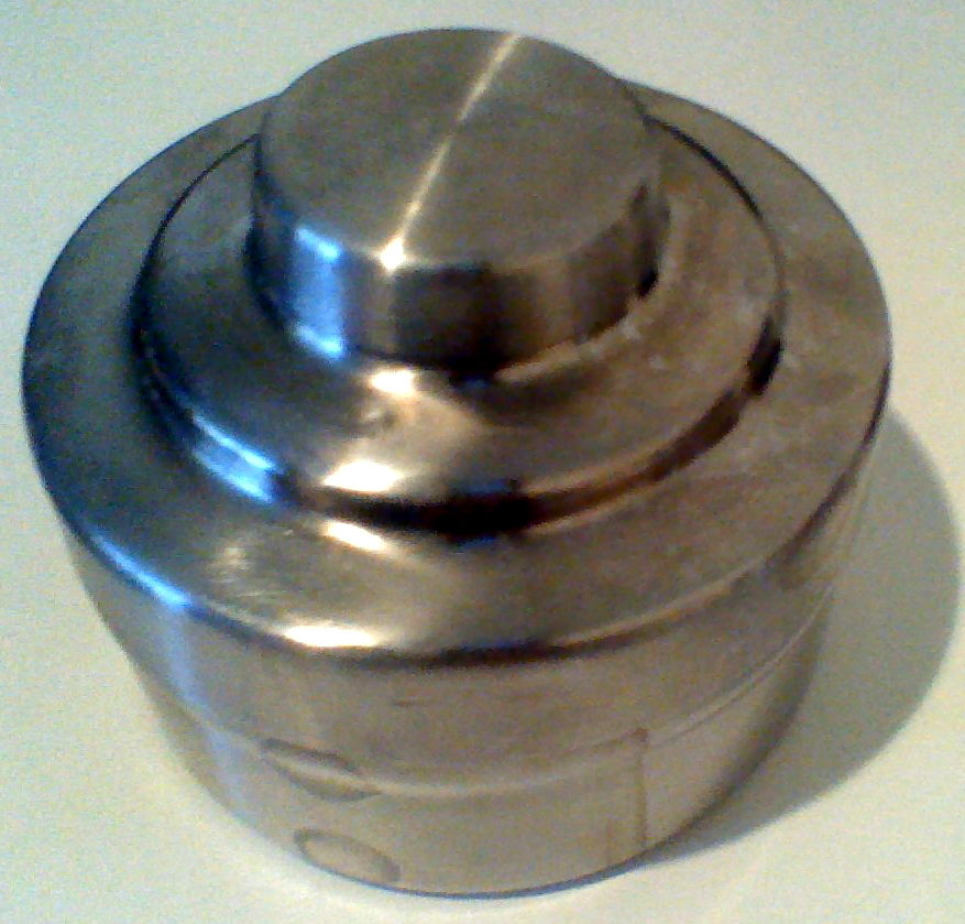

I have a single-roll developing tank, that only holds one 35mm reel. I believe it holds about 250mL. My plastic tank requires nearly 500mL to cover one reel, so I had favored this stainless tank as a way to save chemicals. However, the Kodak D76 data sheet suggests increasing development time by 10% when using an 8-ounce tank. My question is, if you have and use a small tank like this, have you ever noticed longer development times as a result of using this reduced amount of chemistry? At 1+1 dilution, we are talking about only 125mL of D-76 stock. Not to second guess Kodak's information, but if I have to use different development times with this small tank, it might not be worth it for consistency's sake.

FWIW, I was advised years ago to avoid those little tanks because of inconsistency problems--not enough room for proper agitation, I was told. Whatever, I have always used at least a double tank. And when souping one roll, always putting an empty reel on top; and always filling the tank. Economy is just not an issue because I use replenished D23 most of the time.

My $0.02: I'd never before heard that D-76 1+1 development times should be increased when using small solution volumes. I know that some developers/dilutions are pretty near the edge, though -- you do need a minimum amount of the developing agents to get the job done, and if you drop below a certain dilution (which of course varies from one developer to another), you'll need to use a minimum amount of solution volume to get consistent results. I don't happen to know what the limits are for D-76. FWIW, I started with D-76 in a plastic tank that required 350ml to do a single roll of film. I generally did single rolls with that volume, but I didn't do enough double rolls to say if there was a single/double roll consistency problem.
I have heard the claim that small tanks don't permit enough fluid motion for proper agitation. I've never seen this claim substantiated, though. If you're doing inversion agitation, there would obviously be significant differences in the nature of the fluid flow when doing a single roll with 250ml of solution in a single-roll vs. a two-roll tank -- with the two-roll tank, all that air will make a difference in the fluid flow. Whether this translates to a real difference on film, though, I don't know. I've not noticed differences between doing one or two rolls in my two-roll SS tanks, though, so I expect any differences would be pretty subtle.

IIRC you need at least 250ml of stock D-76 per roll of 35mm film (source: Darkroom Cookbook I think), a fact which I was unaware of for far too many years! I always wondered why my results were so poor when using D-76 1:1
Once I switched to using double the solution, my results and consistency improved a great deal.
I only use the single roll tank for stock (or when using Diafine)

Per 80 sq. in. of film: 135-36, 120-12, 4 ea. 4x5, 1 ea. 8x10.
Anchell: "Undilute developers - at least 250ml (D76, Mic-X, Xtol),
Dilute developers - at least 500ml (D76 1:1, Rodinal 1:25 to 1:50, FX1, FX2, HC110 1:31 from concentrate, PMK,
Very dilute developers - 1 liter (D76 1:3, Rodinal 1:100, FX2 1:1, HC110 1:90 from concentrate).
These amounts may sound extreme to some. But saving on developer is penny wise and pound foolish."
I discovered this the hard way...by losing film that could not be re-shot.
Anchell: "Although it is true, as Kodak claims, that 100ml of undiluted D76 is sufficient to develop 8x10 inches of film, it may not always be enough to develop the film to its fullest potential. The amount of solution required to cover the film's surface should not be confused with the amount of developer required to fully develop a roll of film."

I used one fairly regularly when I did 35mm a lot in the past few years. I chose it for portability. I also had a two reel tank, and used them at the same developer time with no noticable difference in density or contrast.
You can also just half-fill your two reel tank, with no noticable changes.

Just found the Kodak reference I was after - Tech Pub J-78, 2002:
"If you use D-76 Developer diluted 1:1 ... [y]ou can develop one 135-36 roll (80 square inches) in 473mL (16 ounces) or two rolls together in 946mL (one quart) of diluted developer. If you process one 135-36 roll in a 237mL (8-ounce) tank ... increase the development time by 10 percent"
That was always my finding when I was trying to test for development time when using the single-reel tank - the time was always longer than the manufacturer's recommendation, which fact always seemed counter-intuitive to me. Once I doubled the volume, times made more sense.

I have a Jobo 35mm tank that is designed to hold only 240ml for inversion agitation and a Durst 35mm tank that is the same. Hadn't heard of problems with small tanks before using them. Ignorance is bliss as they say and in this case it prevented me from thinking there would be any problems with a small tank, so no inhibitions and guess what? There wasn't any problems.
