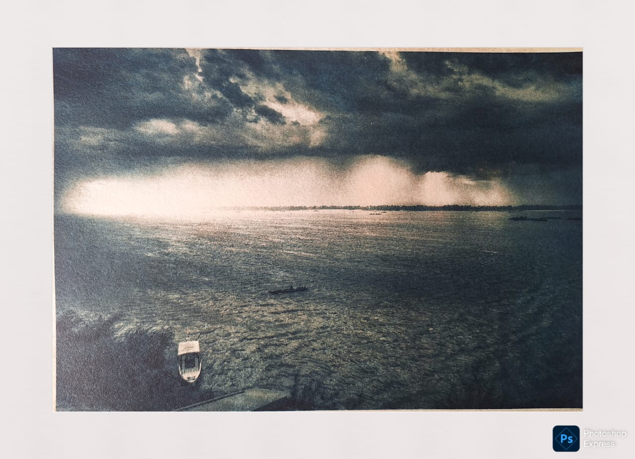

I have been attempting this approach over the last many months in an off and on manner. I did see the Wet Print videos and the launch of PMF (Print Makers Friend) but am yet to try with that material. I also came across posts in the alt photo listings where it has been mentioned that this approach may be difficult with gum and better with PVOH or PVP.
A recent example of where I did get a passable output with 3 layers on Canson Montval is attached for your reference.
My Question is - has anyone tried this method with pure gum approach? Are the outcomes repeatable / predictable? Any inputs would be helpful.
The schema of my approach and some rough calculations are also attached. Special thanks to @Raghu Kuvempunagar for his guidance and inputs.
Thanks in advance.

Update:
Thanks everyone for sharing your experiences and thoughts.
I am now confident that this approach will work with gum with some modifications. I will list down what I did and my results below ->
1. Came across literature as well as inputs from @Raghu Kuvempunagar about increased solubility of gum in alkaline bath. Hence decided to use the same as a development bath.
2. To prevent smudging of unhardened gum in layers underneath, I resorted to using a coating rod. That gave me the possibility to draw a 10 micron emulsion over the underlying layers in less than a second. The loss of unhardened gum was thus prevented.
3. Since the alkaline bath will bleach the tones, I have increased the pigment content of the highlight layer (the 1st or base layer) but I think this should / can be increased overall depending on personal taste and the requirement of a specific image.
Below is a sample output which I made a while back. The print is yet to dry fully and hence there are glares from the relatively wet areas. But I did get close what I wanted to achieve. Experiments will continue :smile:

Further update:
I continued fine tuning the multi layer single development gum print over the weeks. I am happy to state that if one employs a coating rod to coat the gum emulsion and control the exposure as I had explained earlier, you can get really good prints. A sample [3 layers gum over Cyanotype base] is given below for your consideration .
