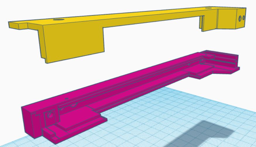

The first was to modify an Olympus OM1 to take a hand grip. I have developed a 3D printed jig that allows the body to be drilled and tapped without breaking through to the inside. I have also produces a 3D printed grip, similar to the original, that fits the later Olympus cameras in this range and of course, the modified OM1. I have now modified several OM1s with this.

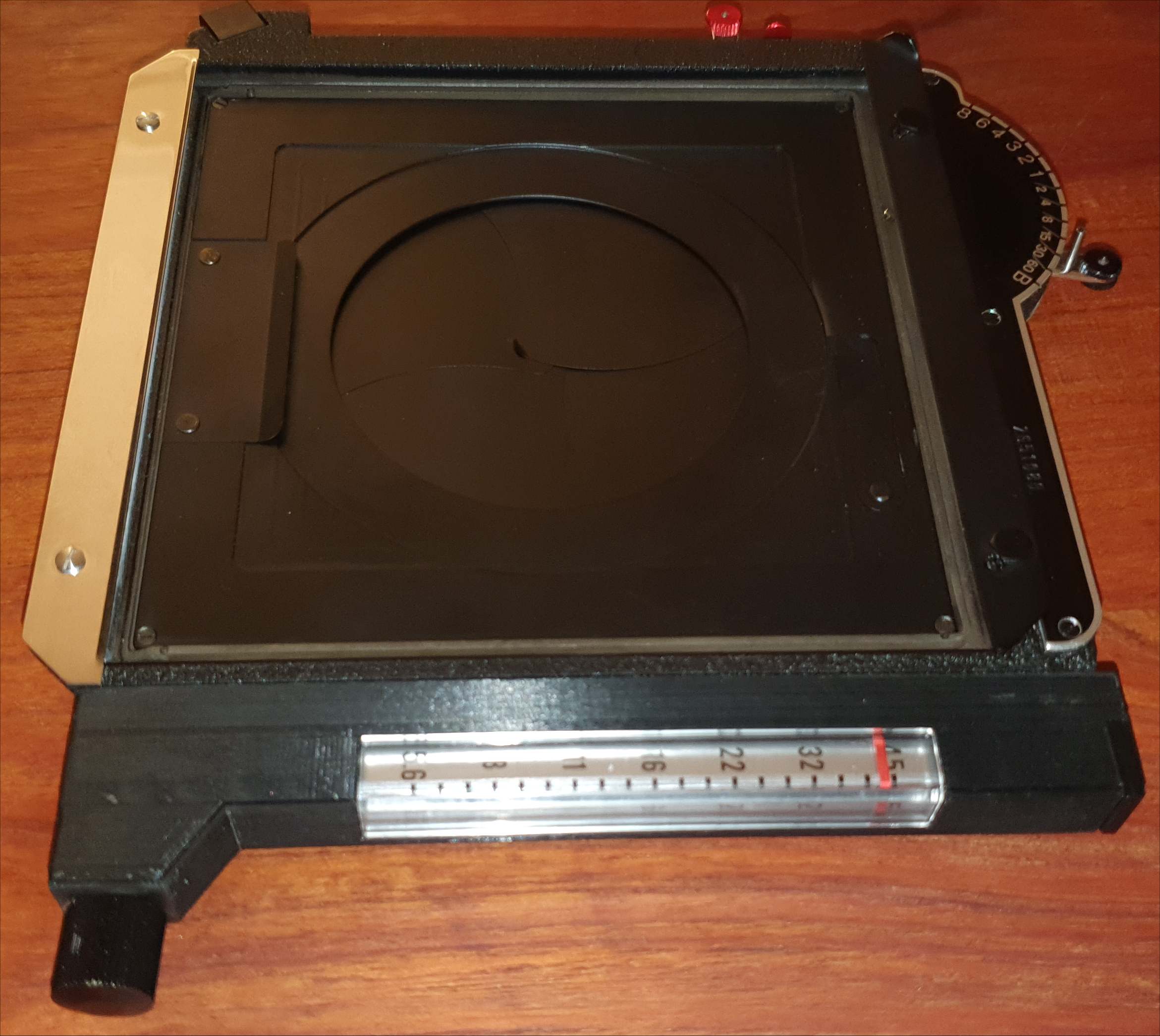

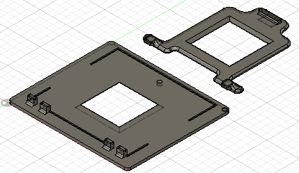

The second challenge was to rebuild the aperture mechanism of a Sinar P shutter. The original plastic had degraded and fallen apart
I have 3D modelled and successfully printed a set of replacement parts that enable the mechanism to be repaired.
With regard to the Sinar P, is this a common problem? Are there other camera parts that could be 3D printed to bring cameras back from the dead?

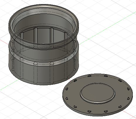

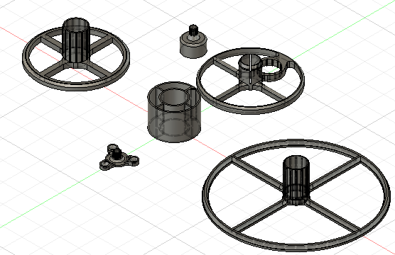

This is a set of parts to make a bulk spooler to respool 400ft rolls of 35mm film down to 100ft ones:

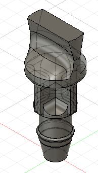

The end cap for a piece of PVC pipe to turn it into a BTZS tube:

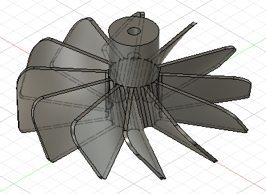

Replacement fan for a Durst RCP20 (the original doesn't fit anymore after converting it to RA4):
