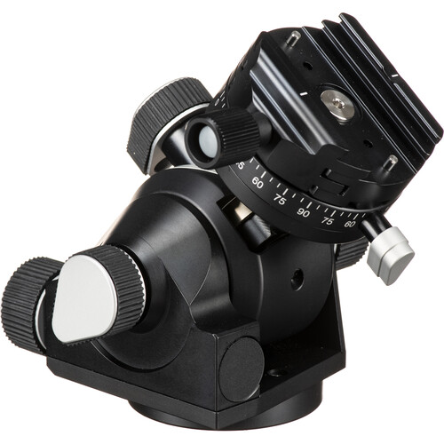

Hi is it possible to mount my Norma onto an Arca geared head? If so, how?

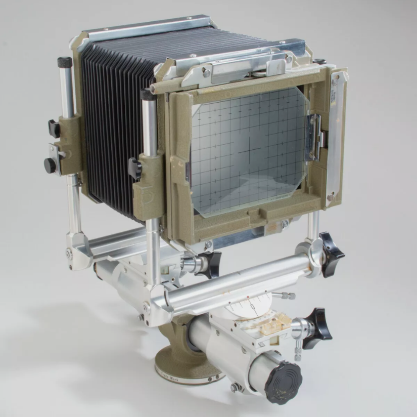

With the matching Arca mounting plate? I'd use a 3/8" screw rather than 1/4" that's just me. I'd prefer a green Norma pan/tilt head, myself.
Did you know that the Norma was made by Arca Swiss for Sinar?

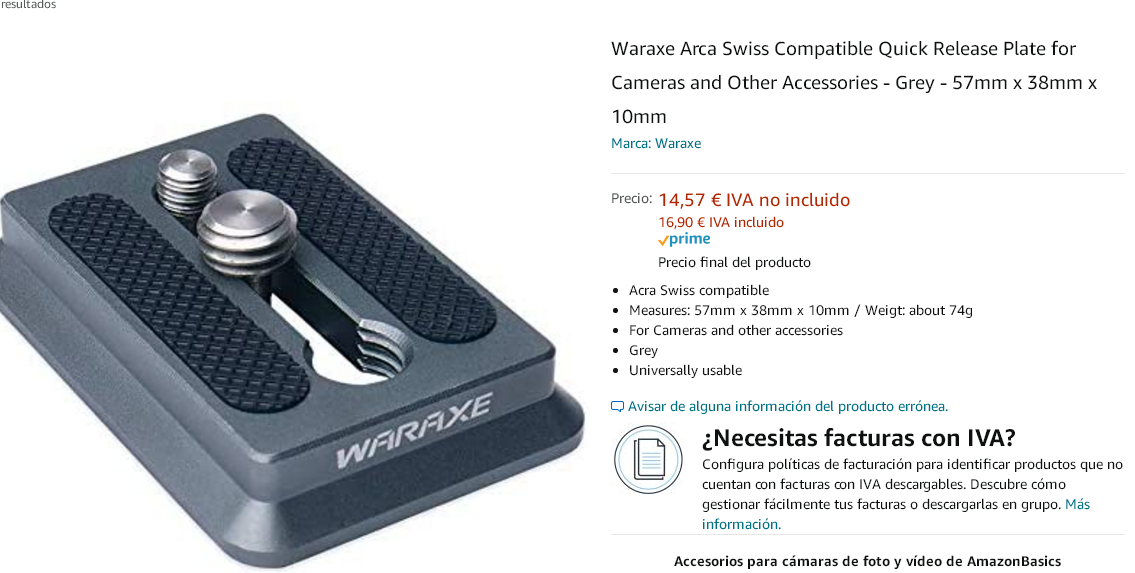

This should be easy. You need a quick release Arca compatible plate:
this one has a 3/8 thread that I guess can be screewed in the Norma circular base plate, but check the threads in each side.
Also take a well reinforced enough one... Some DSLR+Zoom weight more than the Norma, so quality plates made for Pro DSLRs jobs may work, still overload well it at home to test it, you may mount the rail alone and pressing in the tip of the rail to see if the plate is strong enough. I I'd buy two to break one in a test.
Perhaps it can be interesting you get a long one to provide a good base for the Norma's clamp.

Yes, to the latter. I want to use the geared head.

Oh my. Hope you can find something solid and serious enough for the torque involved. Plates are the least of your worries. But as usual in such scenarios, you're only as good as your weakest link.
A standard ARca baseplate should work fine. I've had a few Norma 4x5's, and it's not really that heavy. I'd be inclined to stay with an Arca Swiss basebplate, and not purchase an oriental knockoff. If you're at an extreme angle, I would support the camera as you increase or decrease the angle, to avoid wear on the gears in the head. This would be advisable only for raising an lowering large angles, not for fine tuning while composing an image.
