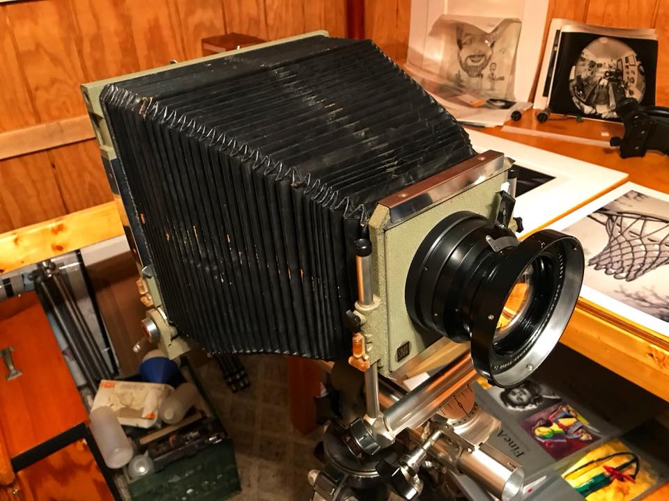

Does there exist a reduction back insert which will fit an 8X10 Norma for shooting 5X7? I have this size of Norma and a 4X5 reduction back, however I really want to shoot 5X7, but do not want to have to change the back and bellows. Is there a way?

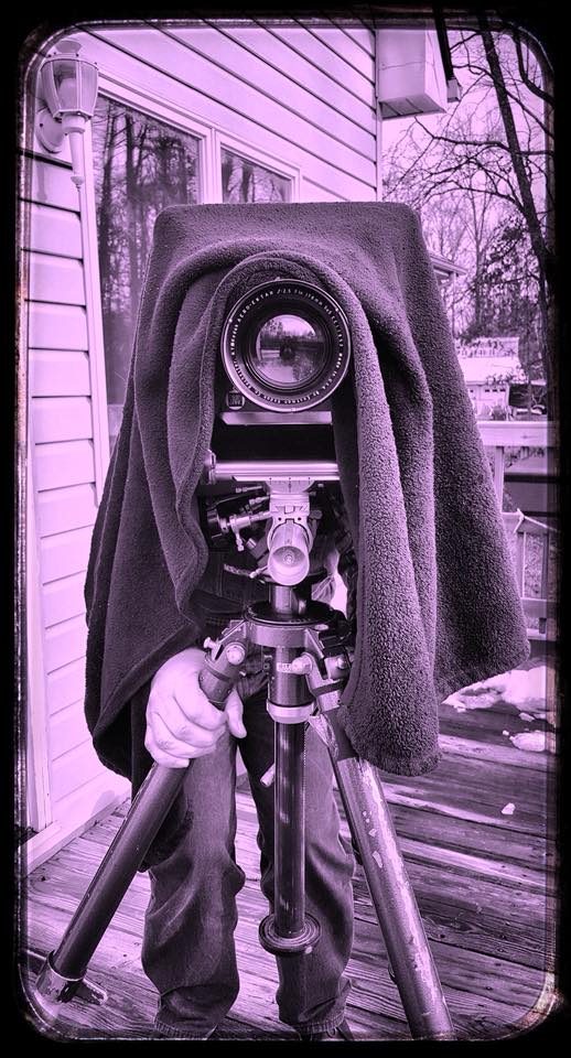

BTW - here is my Norma with its freshly mounted Kodak Aero Ektar. I'm setting up to shoot 4X5 tintypes and hope to later do 8X10 (I'll have to find another lens though, of course).
