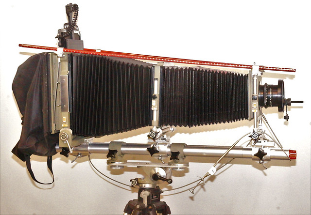

8x10 Sinar Norma Long Apo Ronar 1 by Nokton48, on Flickr
I've been configuring this 8x10 Sinar Norma to use out in the field for up to 4x telephoto photography. I have long Rodenstock Apo Ronar barrel dialyte type telephotos right now up to 790mm F14. They made a 1070mm f14 same era and style looking for one but not as expensive as a car. This is all original Sinar Norma 100% except for the clamping plate which was made for me by a machinist friend. I have never seen the original Norma one available. Basically I used this camera for B&w studio portraiture and I am taking the old concept which worked very well for me and scaling it up.
Similar tele experiences? Spring is coming.

Awesome! Thanks for sharing, telephoto lenses that cover 8x10 are not that common.

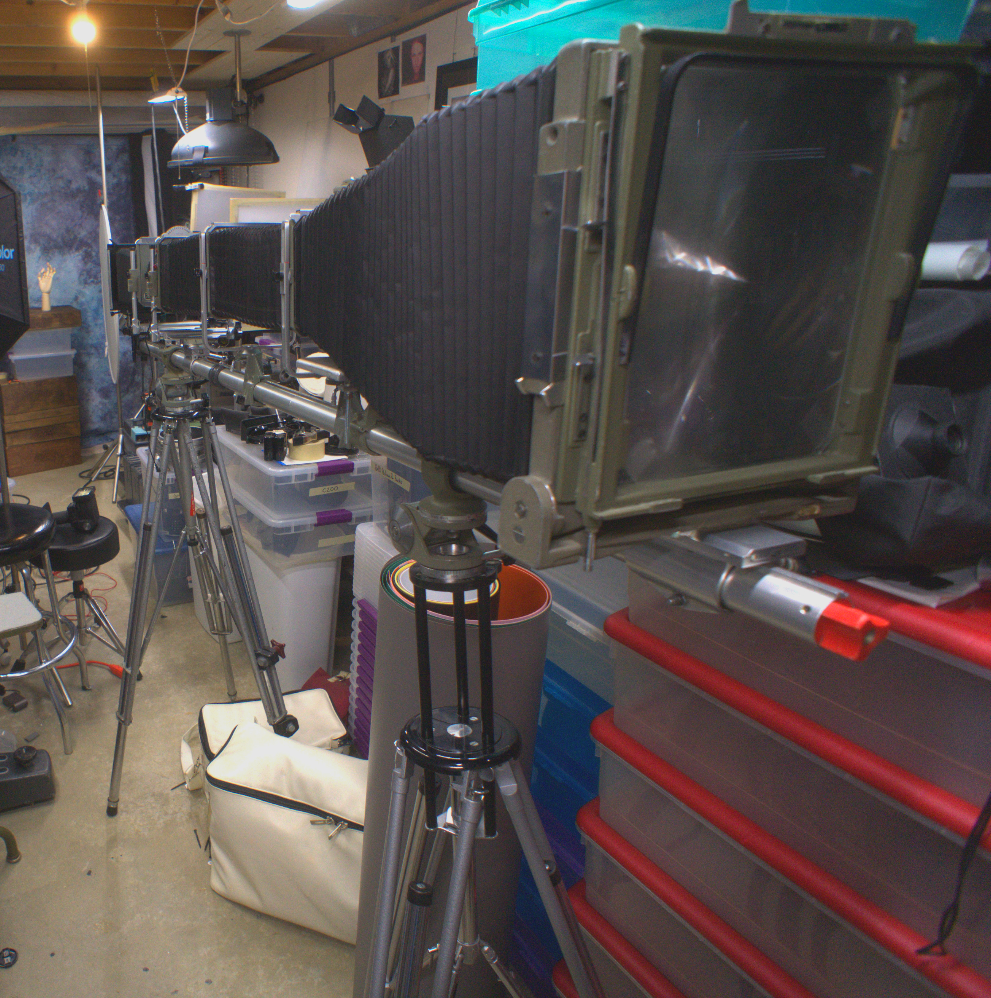

8x10 Sinar Norma Long Apo Ronar 2 by Nokton48, on Flickr
8x10 Sinar Norma Long Apo Ronar 3 by Nokton48, on Flickr
Further work this morning on my 8x10 Sinar Norma. In my studio man cave, my Plaubel Peco Profia Camera Stand is definately the way to go. It goes easily and quickly from lowest to my ten foot studio ceiling. It is in a bit of rough condition, needs some rust cleaned form the column, and needs a replacement floor wheel, which I have found difficult to find. It is a European double caster of unique design. McMaster Carr and the internet so far no luck.
In my storage boxes I found a modern Sinar Bar for the Rail Clamps. These are expensive new, IIRC I paid $40 or $50 and was happy with that. This morning I went out into my workshop and removed some steel pins using vise and center punch/hammer. I think I will keep the modern Sinar black Knobs on the Rail Clamps, now I can slide the Norma Clamps back and forth super easily to precisely balance the cameras. They look OK on the Norma. Finally I will paint the black bar with Sinar Norma Green oil paint. The Red Stabilizing Rods up top are incredibly difficult to find, and even more more rare, are the Screw In Clamps for the stabilizing rods.

1000mm F16 Apo Ronar Wolfe Configuration Close Up Looks Good by Nokton48, on Flickr
See Post #4 ^^^ for the camera that has inspired me for decades.
This is very close to what Mr. Wolfe was using out in the field. A standard sized 8x10 Norma Bellows, three Norma Auxiliary Standards (I have another one coming). Three Norma 4x5 standard Bellows. The Compendium Hood is a Norma Tapered 4x5 Bellows. Viewing through the lens image looks really good and sharp. The two C40's provide ROCK SOLID support even in strong wind. Tripods may be weighted down in the field. Measured bellows draw is Fifty-three Inches, so calculated Bellows draw factor is TWO STOPS for this close-up.

"Telephoto" is a misnomer in this case. He's not using a telephoto lens, but just a long focal length lens on a versatile monorail camera. The Norma system is indeed well designed for that kind of application. You can add as many rail and bellows sections as you need.
The longest lens I have is a 760/9 Apo Nikkor process lens; but the more compact, already in shutter Fuji 600C is the longest I customarily shoot on 8x10. Either would be hopeless in the windy conditions of the past couple weeks. I've had sudden wind gusts pick up "rock solid" setups and toss the whole thing twenty or more feet - luckily landing on soft herbage in each instance. More bellows simply makes a more efficient kite.
There is also a potential misunderstanding about close range corrected barrel process lenses. Many of these are superb at infinity too. That includes most Apo Nikkors, Apo Ronars, and G-Clarons.
