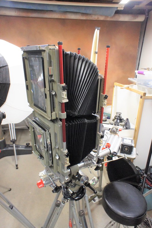

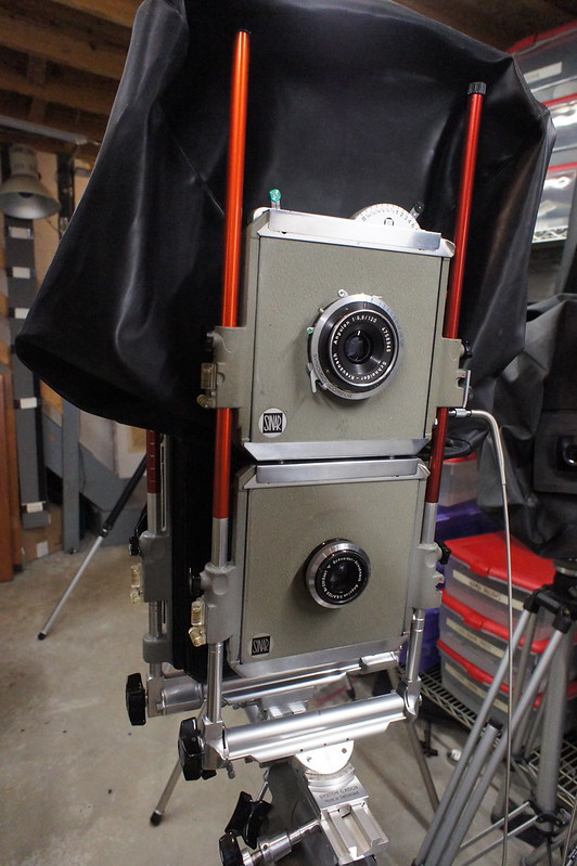

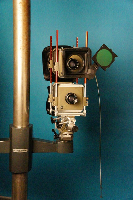

I want to run with this crazy idea because like the tripod mounted Gowlandflex, this offers through the lens viewing even DURING the exposure. For a second I can see with the big strobe pop I can see the burned image just for a microsecond. If photographing faces I can judge the expression if movement is involved. Worst case is I break it apart and make dedicated wide angle and tele cameras out of the pieces. I want to leave this rig up for a good while to start and see what develops :angel: I did buy more Norma boards and extra rail clamps and clamping stuff, another Norma shutter to dedicate to this camera, and a Norma ground glass, so both top and bottom screens are identically marked.
Also this is FUN cause I've never used anything like this
TLR Norma 150 Comp Top Lens by Nokton48, on Flickr
View through top lens 150mm chrome Schneider Componon Fuji HRU 9x12cm XRay film Legacy Mic-X dev
View through bottom (viewing) lens 150 chrome Schneider Componon Fuji HRU 9x12cm XRay film Legacy Mic-X dev
As you can see slightly lower viewpoint but very similar views

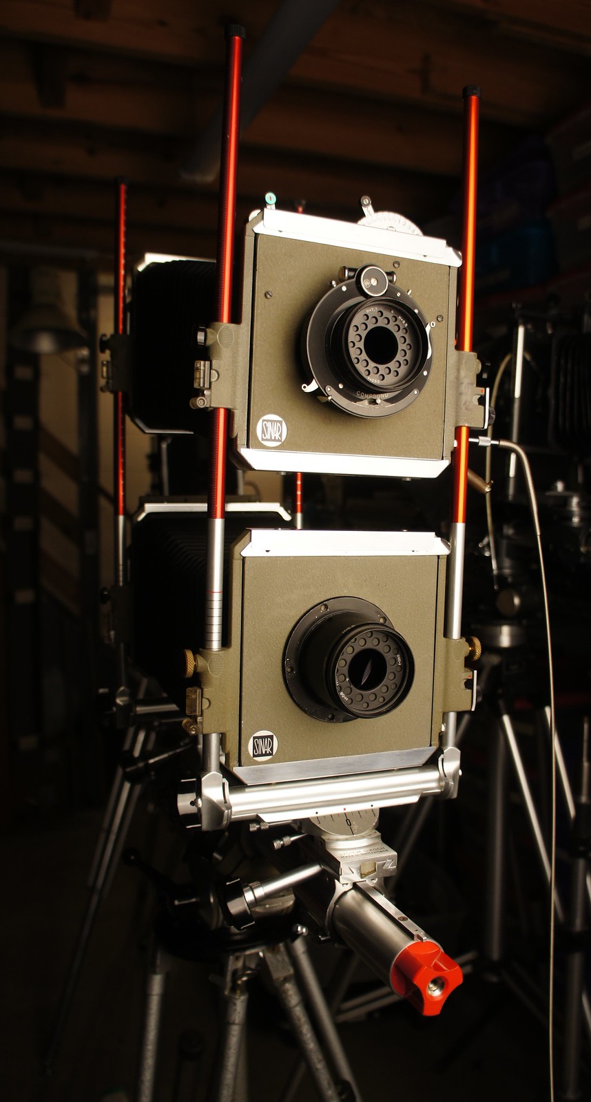

Tuned Up Twin Lens Norma 180 Comps by Nokton48, on Flickr
The rear standard on this Norma pair wobbled on the base rail. I loosed the allen screws and reset the friction on the metal plugs that tighten against the rail. Easy to do and now square and solid. Bought another original Norma screen and marked 6x9 and 9x12 frame marks on all my screens using chartpac tape. Then reinstalled the glass in all screen carriers, adding Norma fresnels. So now identical markings completely on top and bottom focus screens and bright and very even viewing using the two Norma Monoculars with Norma Bag Bellows. It's vital that the base tilt create identical focus planes through both cameras, it is quick and easy to do. I reset after I move anything on the camera. Everything looks sharp on the glass and I'm finishing some basic lens pairs. The Plaubel Peco Profia Camera Stand is the best way to get this beast into the proper position.

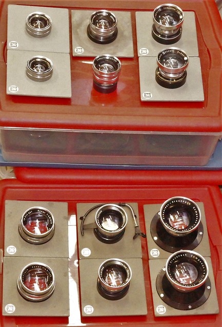

Lens Pairs for Twin Lens Norma so far by Nokton48, on Flickr
Like a car in an auto body shop, Norma Lens Boards with dozens of holes in some of them, can be plugged with JBWELD and planed and cleaned, the back side dotted with flat black Krylon aerosol paint. The front of the board gets spotted with Benjamin Moore paint I had color matched with a Norma board in the store. Looks pretty good in my opinion. Schneider Norma Twin lens camera pairs shown here. From upper left: 150mm f5.6 Componons, 210mm f5.6 Componons, 240mm f5.6 Componons. From bottom left: 240mm f4.5 Xenars, 240mm f5.6 Sinar Symmars, 300mm f5.6 Componons. This gives me a full range of lenses from 150mm to 300mm with the twin lens camera.

The top lens is forward mounted in original Norma board so that the front and rear standards are automated Norma cables so super fast. When you insert a holder it closes the shutter, and just that fast you can pop it. And of course I see the "pop" through the taking lens for an instant. No chimping required and just like with a baby 6x6 TLR :smile:

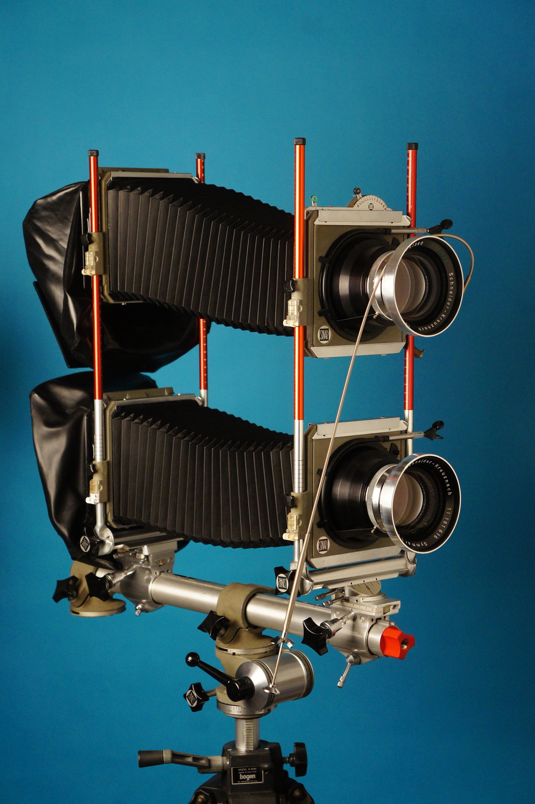

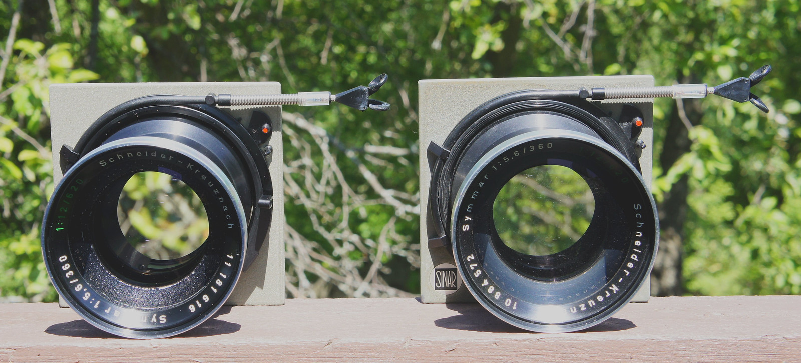

360 Symmar Norma Auto Iris Pair by Nokton48, on Flickr
Here's the Sinar Norma 360mm f5.6 chrome barrel Auto Iris Symmar Plasmat Matched Pair. This is setup at portrait distance, notice how the lenses go further apart for similar views. Awesome on the ground glass, I'm going to enjoy using this one. I use a Norma Compendium Hood with four adjustable blinders to reduce internal flare, this lens covers a humungeous amount. What a view :smile:

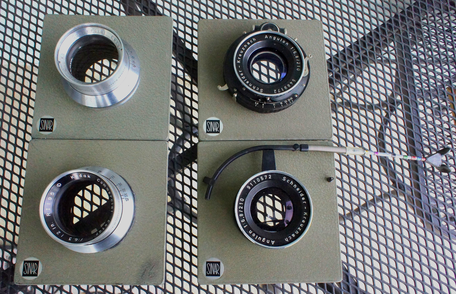

Norma Twin Lens Pairs 300 Comm Ektar f6.3 210mm f6.8 Angulon by Nokton48, on Flickr
Just today picked up two new lenses for making matched pairs. Got them up this morning meeting the dealer at a local camera auction
On the left, the 12" 305mm f6.3 Kodak Commercial Ektars
On the right, a Norma pair of 210mm Schneider Angulons
Images checked on ground glass and they are all keepers

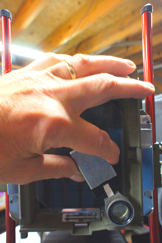

What makes it fast???
There are Norma lenses, that integrate with the Norma Automatic Shutter by means of coiled metal cables with quick disconnects. You preset the desired aperture, using the mickey mouse automatic iris Norma lensboard setup. So you're composing and viewing at full aperture with the taking f/stop dialed in. Ready to take the shot? Simply insert the film holder (up to 8x10), and the automated cables close the shutter, and the preselected aperture is set by the auto iris mechanism. Pull the dark slide and actuate the shutter using the metal coiled shutter release. Pretty quick compared to most view cameras. With the "Rapid Adapter" it's 6x6/6x9 roll film there is an automated "shutter" in the back, also integrating with the automatic shutter, no darkslides needed. Medium format cameras normally do not have perspective control or interchangeability of optics like the "construction unit" Sinars
With the twin lens you can have the slide pulled in the holder and still view and review the image close to how it appears during the actual exposure. Subject sits down, bang away with reflex continuous viewing. Not bad for a view camera.
Yes it is faster than the old fashioned way.

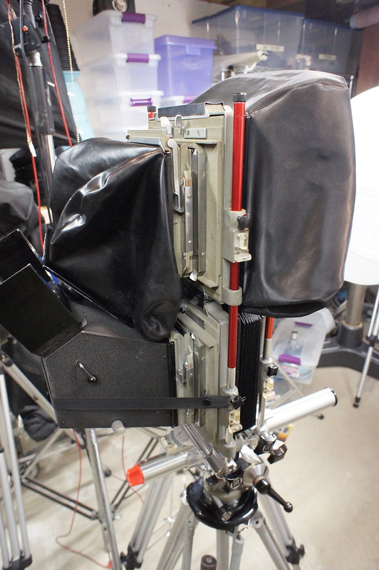

5x7 and 4x5 Sinar Norma TLR's by Nokton48, on Flickr
"Construction Unit Design" allows me to upsize the camera to 13x18/5x7. Nice to have the larger format, I am just getting going with 5x7. 240 Componon pair on the left, 250 Imagon pair on the right

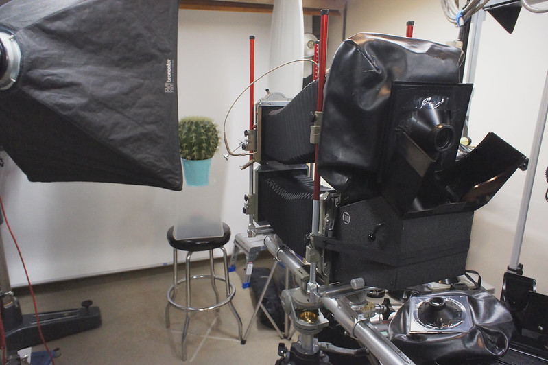

4x5 Twin Lens Sinar Norma Binocular Reflex Magnifier by Nokton48, on Flickr
I repaired my Sinar Norma Binocular Magnifier, the interior front surface mirror shattered. I ordered an exact measured replacement on Ebay for $25, and installed it very carefully with JB Weld. Good as new now and it's preferred by me for the viewing (bottom) lens on the 4x5 Norma Twin Lens. A Norma 4x5 Bag Bellows and Norma Monocular go on the taking (top) lens. Easy to switch back and forth between top and bottom lens, and it's very comfortable as well as hands-free which is important. I added the elastic Sinar Band and it holds the Binocular Reflex Viewfinder tightly against the rear standard. I have some portrait sessions coming up and I think I will go with this setup for now. Here I am viewing my test stand-in test dummy using the 250mm Imagon pair with H5.8 disc petals closed. So a central stop minimizing the "Imagon Effect". It's a lovely lens I have not used enough in the past.

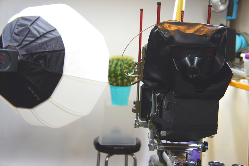

Balloon Head Impact 41 4x5 Norma TLR 250 Imagon by Nokton48, on Flickr
Here I have switched out the Pulso Hazylight for the Broncolor Impact 41 with "Balloon Head". Totally -shadowless- utterly soft lighting. Notice the new Viewing System on the 4x5 TLR. Norma Monocular Bellows on top, Reflex Binocular Sinar on the bottom. This camera is now a true in every way TWIN LENS -REFLEX- 4x5. Viewing the image right side up through the bottom lens, and being able to move the mirror around to scrutinize every mm of the viewing screen, is a great luxury. This works GOOD very direct super user friendly studio portrait camera. I made two more exposures Impact 41 set at 1/4 power, f5.6 on FM2 incident flash meter. Yellow green filter added, so exposures on Fuji HR-U of, 2 pops, and bracketed also for four pops at H5.8 on the 250 Imagon taking lens. I know you are supposed to use sharp pincer-type lighting with Imagons, but I am breaking some rules here. Looks cool on the ground glass, can't wait to develop it hopefully later today.

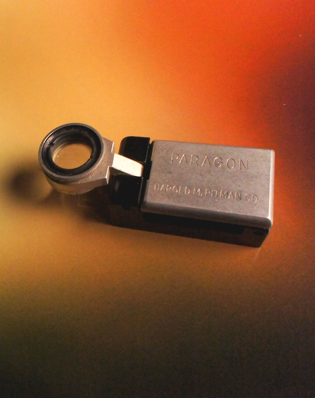

PARAGON Loupe by Pitman Co 1 by Nokton48, on Flickr
Easy to see all the edges and corners at 10X with the PARAGON by Pitman Co. I used to use one of these when I worked in a Color Separation House. Great for viewing film or groundglass. Bought well used on Ebay for $25. Available brand new around $55.

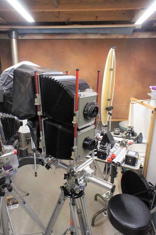

Here fine focusing the top (taking lens) of my 4x5 TLR Sinar Norma.

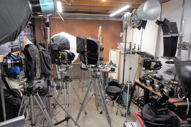

Studio Renovation Phase 1 by Nokton48, on Flickr
I've been working on fully equipping my studio. I have eight Norma cameras now! :smile:

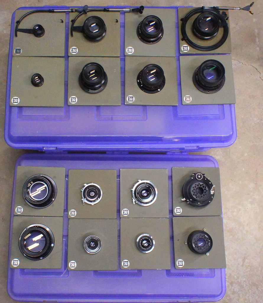

More Norma TLR Matched Lens Pairs by Nokton48, on Flickr
I've been slowly working towards building up my lens bank of matched Norma TLR pairs. I have 4x5 and 5x7 TLR Norma cameras at this point.
Top Box From Top Left: Norma 150mm F9 Rodenstock Apo-Ronar Aperture Controlled pair, 240mm F9 Apo Ronar Aperture controlled pair, 300mm F9 Apo Ronar barrel pair, 360mm F9 Sinar Apo Ronar Aperture controlled pair.
Bottom Box from Top Left: 520mm F9 Rodenstock Apo Ronar barrel pair, 90mm F6.8 Angulon shutter and barrel pair, 120mm F6.8 Shutter and Barrel Pair, 200mm H5.8 Rodenstock Imagon barrel and shutter pair.
I am repurposing what I have and adding to it
