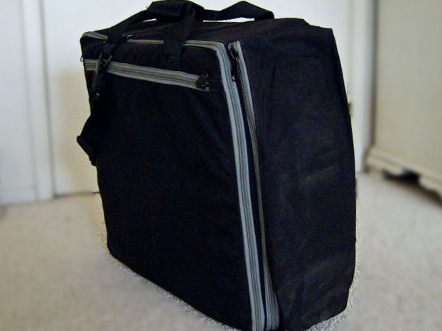

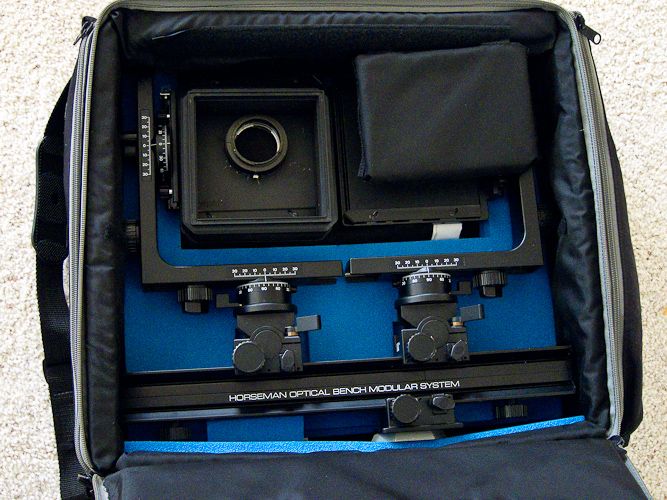

Here is what I use...a Dynalite case (Dynalite sells studio lighting systems)
Outfitted with custom cut closed cell foam to fit my Horseman LX monorail. Interior dimensions of case fit the 480mm long (expandable) rail. Here is a look at the monorail nested in the closed cell foam, with standards turned parallel to the main rail.
One of the section dividers (normally held on a hinged Velcro attachment) has been removed to show the standard and lens board and the removed bellows. This lens board was custom modified to take a Canon dSLR body; the other lens board, not shown, was custom modified to take a Bronica ETRSi medium format film lens. I have a separate case for my large format lenses and back and binocular magnifier/viewer and other accessories as well as film holders.
