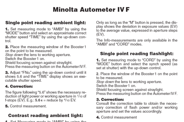

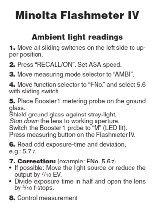

When i take a meter reading with the Sinar Booster 1 / Minolta Flash Meter IV, if i get an F number of 5.6-0, all is hunky-dory, i just read the shutter time and I'm ready to rumba.
But sometimes i get an F number like 5.7-7. (the third number is showing a multiplier of 0.1 of a stop).
Ok, i dive into the Minolta manual and it tells me i need to adjust my lighting until the reading is 5.6-0
Well that's no good, maybe i don't want to do that, perhaps i'm working with natural light or lots of other lights and i don't want to adjust them all.
So then i need to adjust my shutter time instead. But strangely, the Minolta won't let me do this adjustment (dial the F number back to 5.6, then it shows me the corrected shutter time). I'm guessing this is because back in the day, it was expected that you would stick to one of a certain number of discrete shutter times, there were no in between shutter times considered?
But this is 2023 baby, i think we can be more flexible about this!
So to my questions:
Is what i wrote above correct, or am i completely misunderstanding something?
Am i being silly about this, should i just adjust my lighing so my middle grey reading will be 5.6 and deal with it?
Is there an online converter available somewhere. I mean one where you tell it an F# and shutter time, then if you change the F#, it tells you the new shutter time?
Alternatively, if someone knows the equation, i can hack the converter together myself in Excel?
If i understand correctly, the F number of 5.6-9 is extremely close to F8?
I should also mention i'm using long shutter times, 2 seconds+, i appreciate that at fast shutter time you need to stick to the standard times.
Thanks in advance!

A meter reading such as f/5.6 + 0.7 means that there is sufficient light for 0.7 stops more exposure than an f/5.6 exposure at the selected shutter speed.
If you were shooting narrow-latitude transparency film and wanted to “nail” the exposure, you’d set the aperture index to 0.7 of the distance from f/5.6 towards f/8 for correct exposure.
Although you can easily calculate a new exposure time to compensate for the fractional f-stop increment, it’s impractical with a camera shutter because nearly all of them are designed to provide full stop increments only. There are a few exceptions, such as the Mamiya RZ67 Pro II and Pro IID, which provides half-stop time increments.
For enlarging and using a digital timer, it's easy to set exposure times to the nearest 0.1 second. But in practice, this is rarely done, as it’s not practical in most cases.
Here’s how to calculate an exposure time T that is a function of a meter reading A + Δf, where
A = standard f-number displayed and
Δf = fractional part of a stop displayed in 0.1-stop increments and
t0 is the time displayed on the meter.
T = t0*2^Δf (at the displayed aperture number A)
For example, if you had a reading of f/5.6 + 0.7 at t0 = 2 seconds, then
T = 2 seconds*2^0.7 = 3.25 seconds (to the nearest 0.01 second).
Or, to state this another way, the exposure difference from 2 seconds to 3.25 seconds is 0.7 stops.
I use this calculation in enlarging, such as discussed in the thread for determining a new exposure time at a preferred aperture when changing from one projection size to another on the same paper stock.
https://www.photrio.com/forum/threa...-on-the-same-paper-stock.203076/#post-2743311
