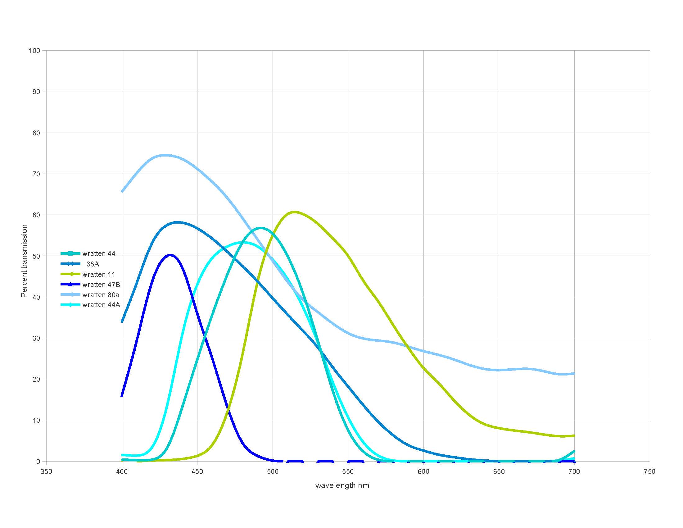

I've been looking at transmission spectra for the 44, 44A and 80A filters (along with some others). It would appear that the 44 is a bit sharper cut than the 44A; it transmits less blue, but more green and tails off just a bit faster than the 44A.
The 80A, on the other hand, transmits a whole lot of blue and tapers off very slowly toward the red, still transmitting a bit of red at the long wavelength end of the visible spectrum.
Here's a graph of the transmission spectra for a bunch of blue, blue-green filters with the #11 green (X1) filter thrown in for comparison. Once you figure out which line is which filter (the colors are very close, so it takes a while), it becomes apparent that the 44 and 44A really don't transmit the deep blues like the 80A does. That might make the rendering with an 80A a bit closer to true ortho rendering than the 44 series, that is, if the red transmission isn't too much.
The graph of spectral sensitivity for Ilford Ortho Plus shows a fairly high and even sensitivity from just under 400nm to just above 550nm, after which it tapers off sharply, with no sensitivity above about 530nm, so true reds would be rendered as black.

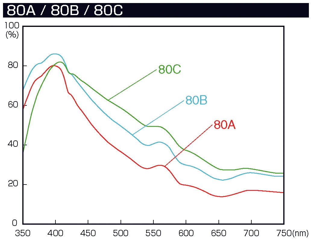

I'll include the graph or the spectral transmission of the 80 series as well. As you can see, the 80B and 80C transmit progressively more red and green than the 80A. Blue sensitivity peaks about 400nm for all of them, then they taper off toward the red at different rates.
Best,
Doremus

Thanks I had difficulty working out which shade of several turquoises were which but it looked to me that cutting out red was done soonest was the 47B but the 44 and 44A reached the bottom line neck and neck Should I take it that the 47B hitting the bottom line much sooner confers no advantage in cutting out red as in fact both the 44 and 44A do this well before you get near to the red spectrum
The 80A while looking the best of the three A,B. and C tails off much more slowly so do I conclude from this that it will not be as successful at simulating ortho as a 44 or 44A or is it that so much red has been cut out by the 80A that what remains will not show up at all on a negative or show up red so marginally that in a print the difference will be truly negligible?
Thanks
pentaxuser
Indeed. The #47 cuts out green as well and simulates the oldest blue-sensitive emulsions. Later, sensitizing dyes were added to make the film sensitive to green as well and orthochromatic film was born. Later, the emulsions were able to be sensitized to red, hence panchromatic film, and infrared, hence infrared film.
I imagine that even the 80A filter will render reds a bit lighter than either ortho film or the rendering with the 44/44A filters. Still, it "boosts" the blue a lot, so has a nice effect opening up shadows. Blue skies are rendered lighter, though.
