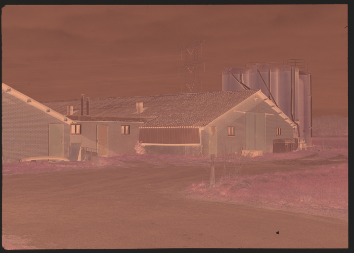

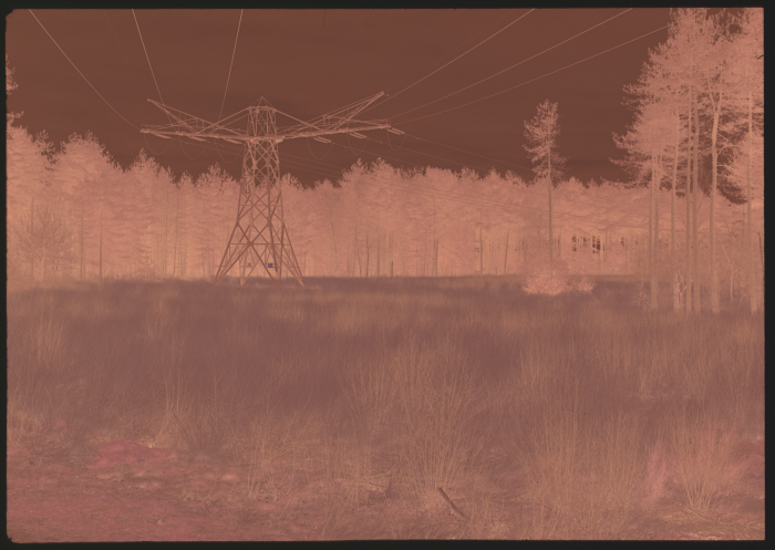

Thanks for that, If you have a scan of the negatives too it would be nice, since the 1st problem is the development itself.
Sure:
Keep in mind both are on Vision3 50D, so not regular C41 film.
