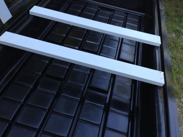

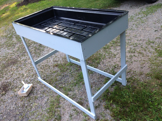

While attempting to find a cheap 2 x 4 darkroom sink i happened onto hydroponic flood tables while searching the net. I got mine from Zen Hydro. There are other suppliers. I'm using one of their drain kits (less than 5 bucks) but you could probably find something else too. The frame is pine and a simple build. There is a stepped edge so you can put some cross pieces in and put three 16 x 20 trays in, 2 below and one above. I plan on making a full size insert so I can also use it as a work table for matting etc...I was a little worried about the grid floor but it drains easily so should be ok. I built to to elbow height so i can see what I'm doing better without leaning over. I still need to make the two shelves that go down below. BTW one qt of paint won't cover the frame and shelves with two coats. I lucked out b/c my new darkroom was a laundry room at one point so all the plumbing is already there. $70 bucks including shipping across the country plus the wood and screws, paint, donuts, coffee, so much coffee etc...

I will say your legs look a little thin and could use some diagonal cross bracing. Once its loaded down with liquid and is being leaned on it might start to deform and fail on you.
I would recommend 2x4 stock for future builds.
Typos made on a tiny phone...
Thanks, good luck on your build.
