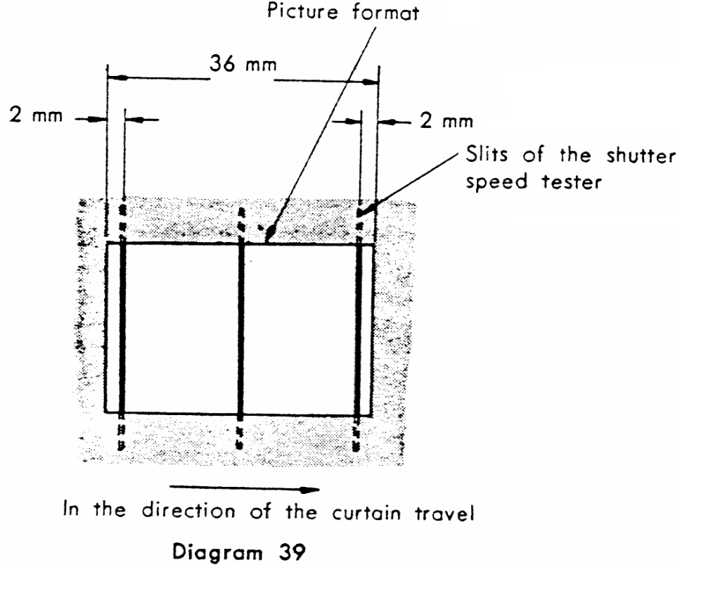

For a shutter speed tester to be useful with a focal plane shutter, you really need two sensors, one for the opening edge and one for the closing edge. And, first thing to do is adjust curtain travel time, then shutter speeds. You can't do either with only one sensor.

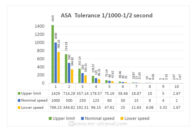

I measured speeds yesterday on the far left and right of the film back and they measured the same as in the middle in all fast speeds on a Pentax Spotmatic SP II and an MX. On the MX all speeds were within tolerance based on this chart.
The SP II needs a CLA on the slow speed escapement.
Now, I know that all I have verified is that the slit opening is acceptable. A dual sensor tester would tell me that the travel speed of the curtains is correct so that exposure across the entire frame is even. I may build another tester at some point to do this.
I'm pleased with this tester and the results. No, it's not a professional caliber tester but it at least verifies that the camera is in acceptable range.

You could also shine two lasers at the single source without modifying the whole contraption. I did this a few times just to see if the curtain speed was ok on a few cameras. On the SL35 I work on, the 1/60 does hang up on the second curtain cam (on purpose) so the curtain travel speed is spec'd at faster than 1/60th, so the second curtain needs a little delay before releasing.
Indeed it does. I made one using two Arduino laser modules. They have the advantage of the receiver module already having the Schmitt trigger built in (gives a clean sharp on/off)
Some camera manuals specify the distance the two sensors must be apart (20mm for example) and then give the shutter curtain travel speed in mS.
I have seen many home-adjusted shutters (where peeps have been misguidedly told to blindly teak one of the springs) which then gives uneven exposure across the frame.
