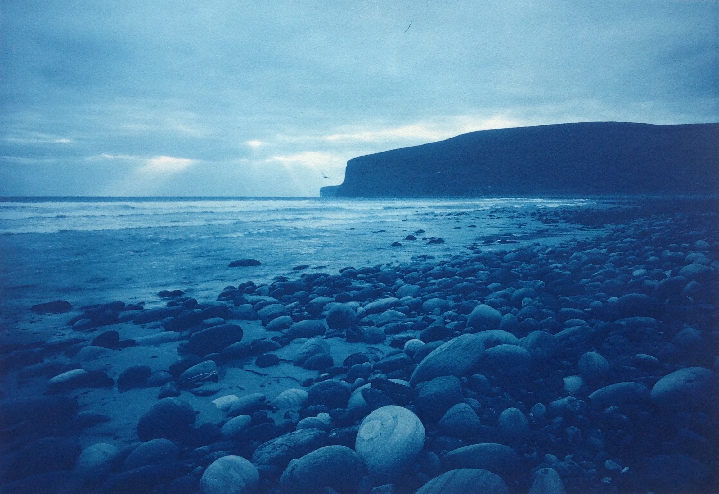

World Cyanotype Day
Land / Sea / Sky
Saturday, September 28th, Two Thousand and Nineteen
To accompany Eric's contribution to World Cyanotype Day, here is one of mine that seems to fit the brief:
'Rackwick Bay, Hoy, Orkney 1984'
Mike Ware. Simple Cyanotype 2019
