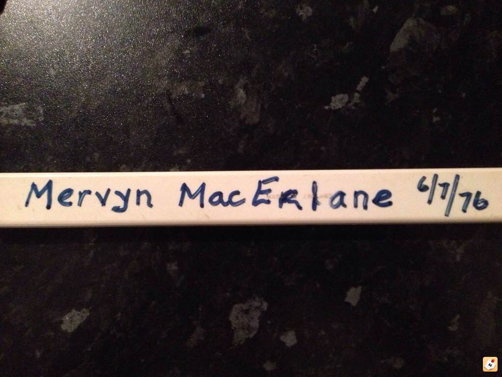

I've been trying to find out some info about the original owner by without much luck. He wrote his name on the thermometer.
