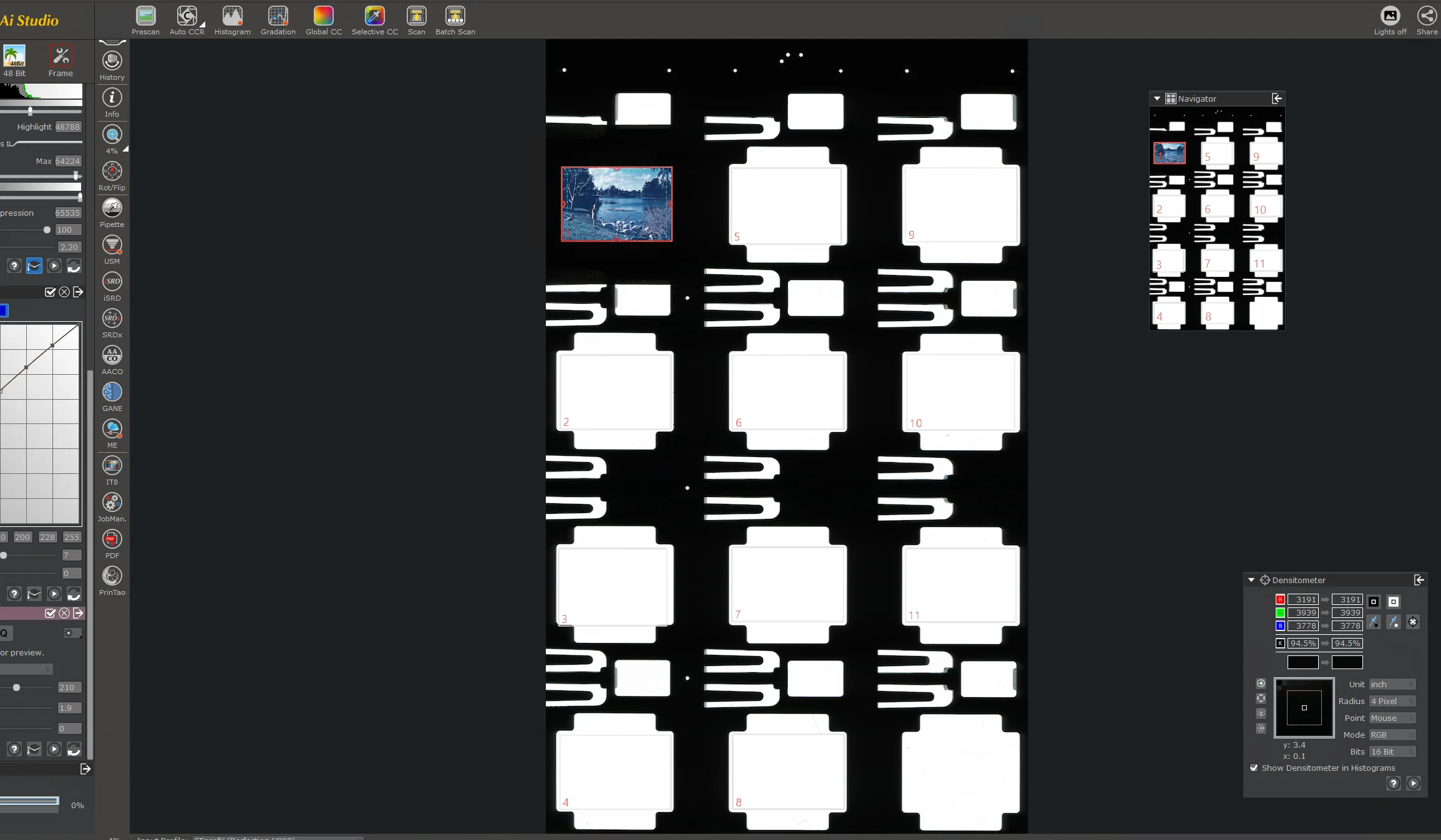

I use an Epson V800 flatbed scanner. I do my prescans at high res x4. I am prescanning a set of slides in a slide holder.
Example of slide holder layout

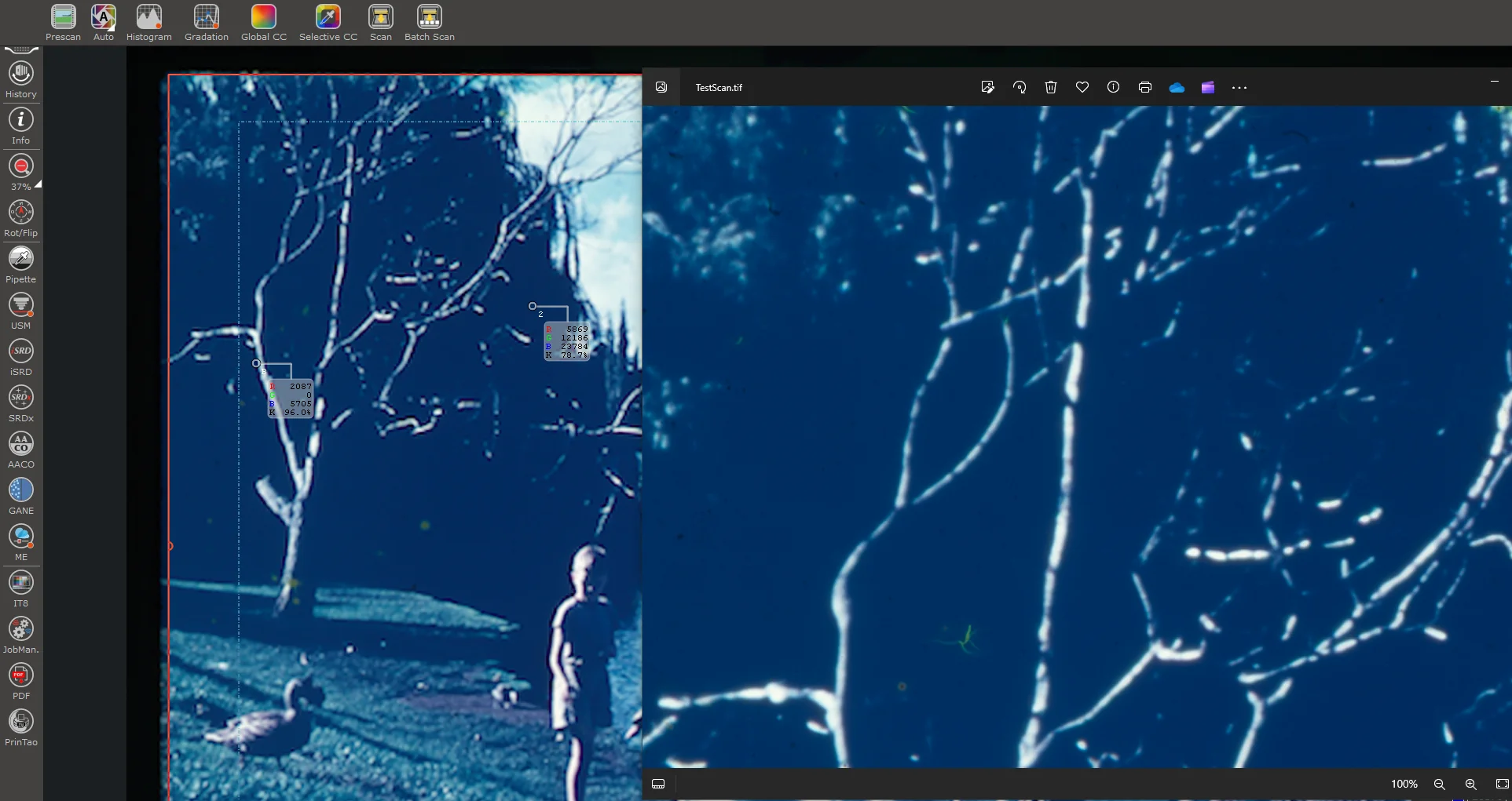

If I have some relatively high contrast edges, a prescan produces edge artifacts. Below is an example.
On the left is a prescan image. You can see the darker ringing where the white tree meets the darker BG. You can also see a sampler on the left of the image, labelled with a B. This is the point where the Silverfast automatic blackpoint picked. It has clearly picked a position with the BLACK ringing.
The right hand image is the slide scanned at full res, full colour depth, everything. Just to demonstrate that the ringing is not in the original slide.
Left: Prescan image at x4, showing ringing around bright to dark areas. RIGHT: full res scan to show the problem is not in the original
This would not really be a problem, except that the automatic colour correction tools seem to be using the blown up prescan, with the artifacts, to get blacks and whites. This will produce incorrect corrections, because the artifacts are from filtering, and blowing the image up.
If the automatic tools were using the original prescan image size, or a blown up version using a filter that doesn't produce edge artifacts, then I expect it would be fine.

I don't use with VFX, but what I see in those prescans looks to me like applying an overly aggressive and coarse unsharp mask.
However, have you considered ignoring the whole thing and just profiling your scanner with an IT8 target? This should get your colors close to reality from the get go. At that point it's a matter of applying final color and/or contrast adjustments to taste, for instance to correct for the massive fading in the example slide you show.

No there's no sharpening of any kind being applied. I specifically turned it off for this example. Besides, any image sharpening should be happening only to the full size scan.
I have the iT8 profile charts for transparencies and and have calibrated using them.
When the slides in question have lasted well (they are from the 1940s to the mid 1980s) then they come up very nicely.
I am quite happy to use the auto correct functions for slides that have faded. Then judge whether to use the autocorrect, or adjust what the autocorrect has done.
I do a quick balance to the prescans, and always keep the low and top ends wide. So my scans tend to look a bit lifted in the blacks, and lower contrast.
I deal with that in Lightroom.
The slide example is an example that shows the problem very clearly. I don't really expect to recover that image. I think that was how it was shot / developed.

I'll take your word for it; I mean, I'm not sure what's to be expected from this image. I do see the strong edge effect you appear to be referring to, but I can't tell if it's the cause of the auto balancing feature failing on this scan. Maybe the Vuescan people could at least verify this for you.
Either way, I'd just manually balance a scan like this (or any scan, really).
