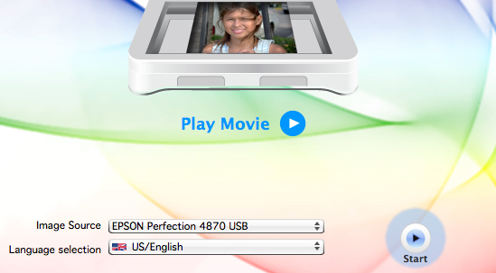

I don't know how to fix your problem but I do use SilverFast Ai8. The last time I called their US support it was on the West coast of Florida and it took a few attempts to speak with someone. The parent company is in Germany and if they have chat support you might try that. Make sure the scanner is on before launching the app and that if this comes up be sure you have the correct source as seen here. This may not do the trick but try.
