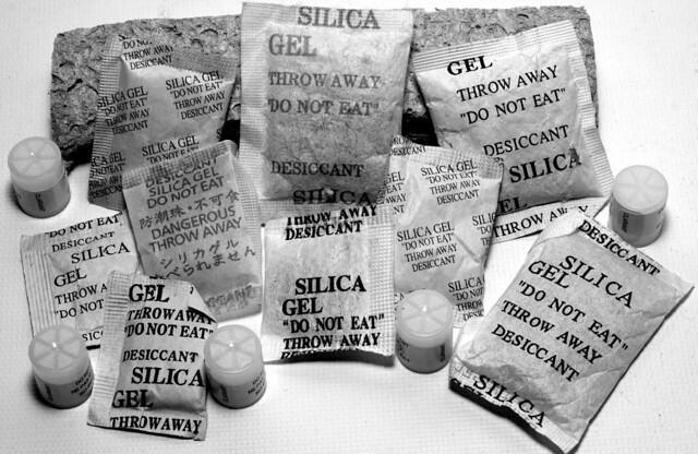

To protect my cameras from damage caused by moisture, I place small packs of silica gel desiccant and/or dry sponges in the air-tight plastic bag where I store my camera, lenses, and electronic flash. I have never used rice.
Once a year, I remove the gel packs and sponges and place them in a pre-heated convection oven (about 300 degrees Fahrenheit) with the oven door open for about 3 hours in order to remove any moisture collected during the previous 12 months. After the packs and sponges have cooled, I replace them in the air-tight plastic bag with my photographic equipment.
Silica Gel by Narsuitus, on Flickr
